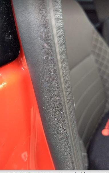

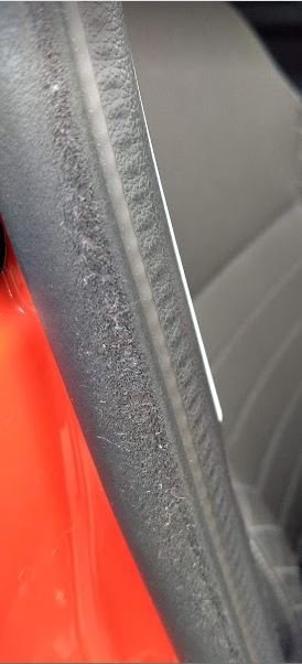

fab2.JPG.1561c52bccfc2e60113631b52e220b33.JPGfab2.JPG.1561c52bccfc2e60113631b52e220b33.JPGHi
There is another post on here regarding the early wear on door seals and noise, my own car was inspected on the drivers side on it's recent service and they say it will need replacing very soon as it has almost worn through on the drivers side.
My Wife has a 64 plate Fabia with just under 20k miles and not a sign of wear. The seals seem to be made of a lot softer materials on my newer car, this could be your problem.

I can see no signs of wear on the door seals either but I am a bit skinny so perhaps I do not come into contact with them in the way somebody a bit 'plumper' may do!
Or even if you are tall like me. I have the drivers seat set back quite some way and it can be the way many of us end up wearing out the door seal.  We enter the car very close to the seal. Although, I personally haven't had that issue.
