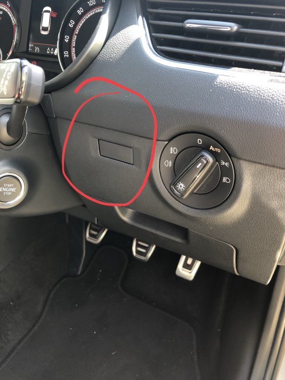

What is this "hole" for?

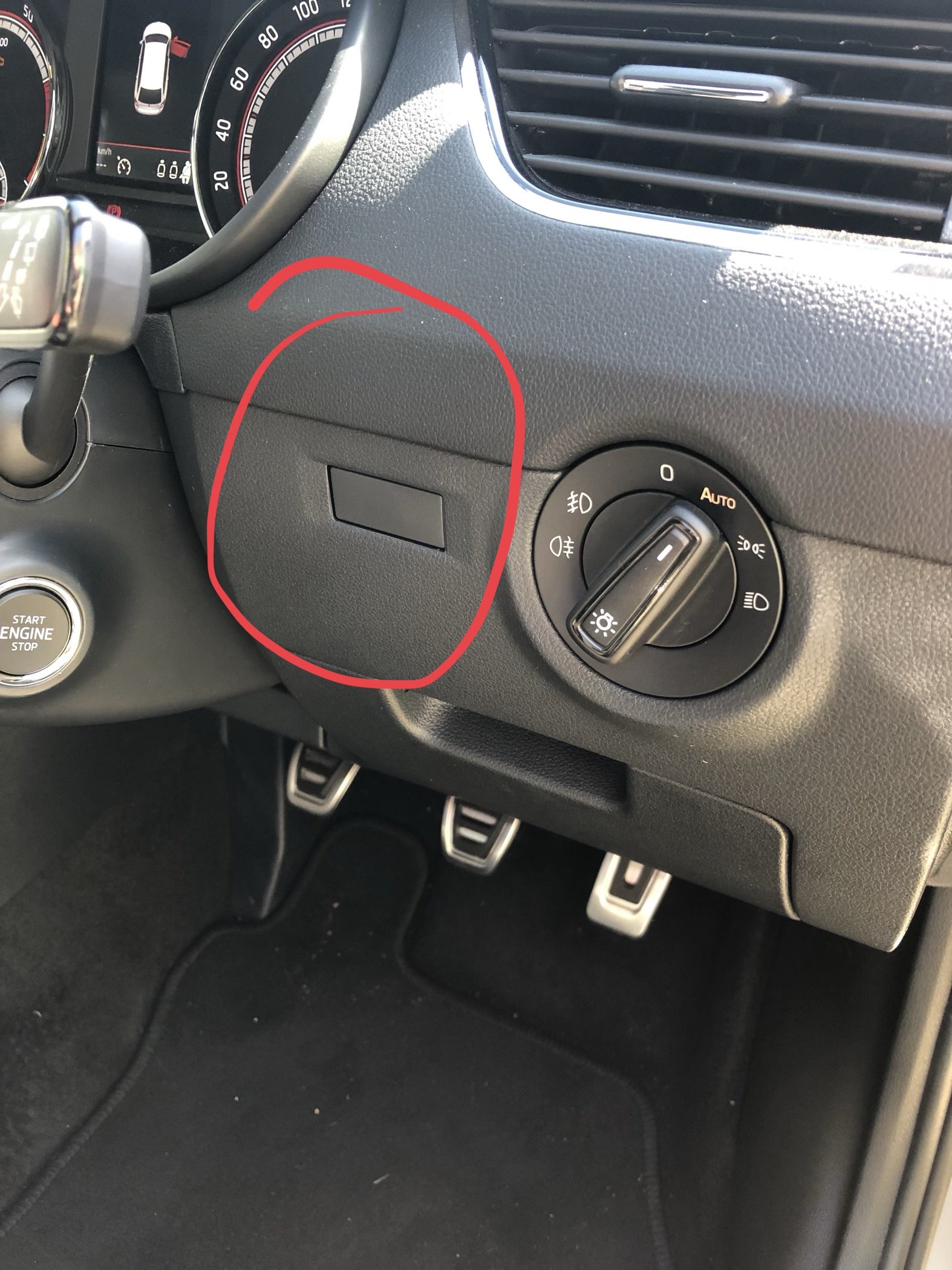

Finally got my MY2019 RS245 just a few days before Christmas (looooooooooooong story, which includes the ship with my original order being turned around by the Port of Auckland because the ship was infested with stink-bugs).
Anywho; just wondering if anyone knows what this hole is for (or is it simply a "leftover" from being a RHD model). Only noticed because it fell in this afternoon when I got home.
Does your car have auto levelling headlights?
Yes it does
13 minutes ago, SkodaNZ said:
Yes it does
That would be the slot for the manual headlight adjustment then. :thumbup:
Ahh that would make sense, couldnt find anything in the manual for what "should" be there.
Much appreciated @john999boy

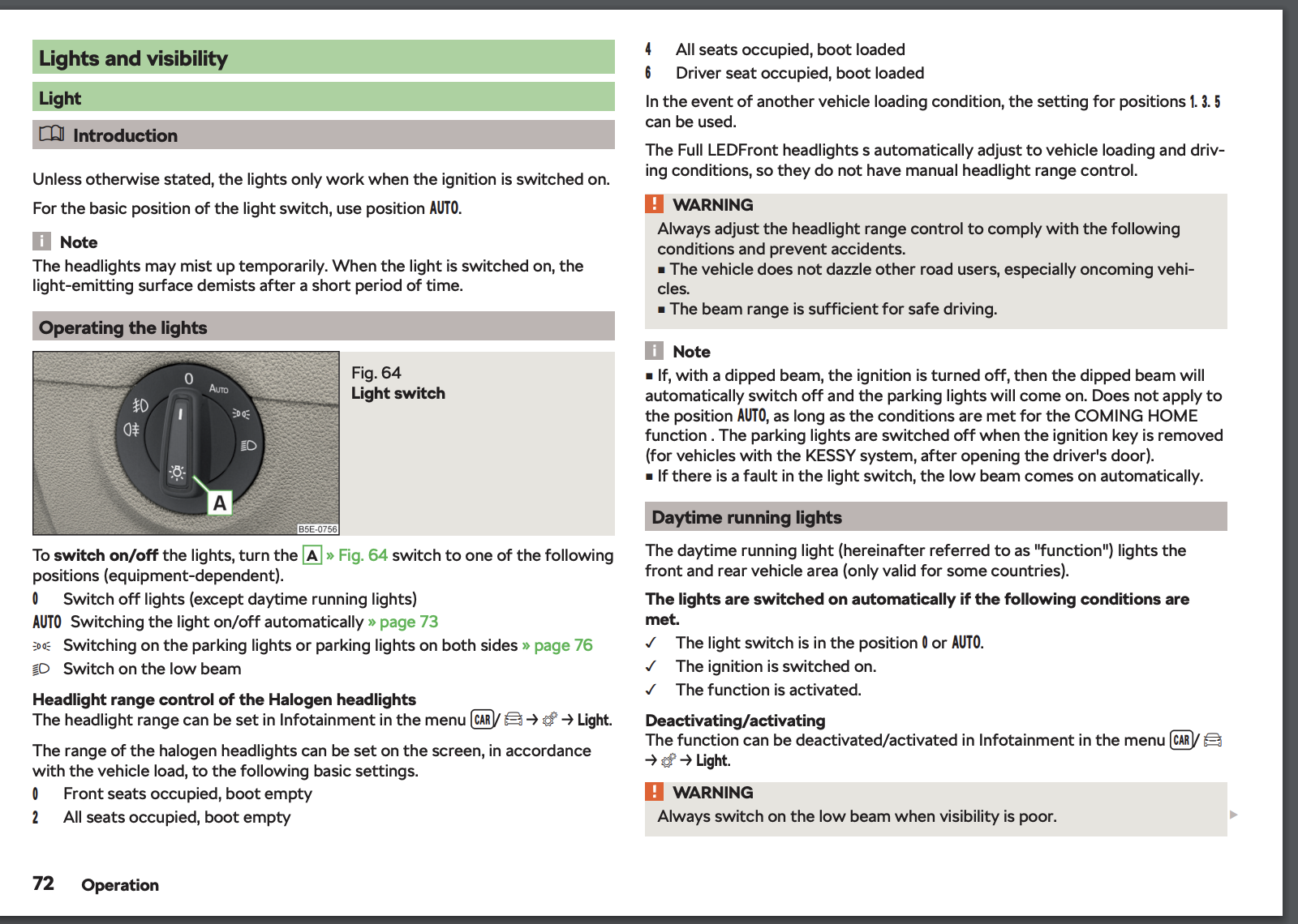

I guess, after checking the manual......
"The Full LEDFront headlights s automatically adjust to vehicle loading and driving conditions, so they do not have manual headlight range control."

Control them in what sense? Afaik you can't adjust the tilt up/down with the infotainment, that's what the manual adjuster is for.

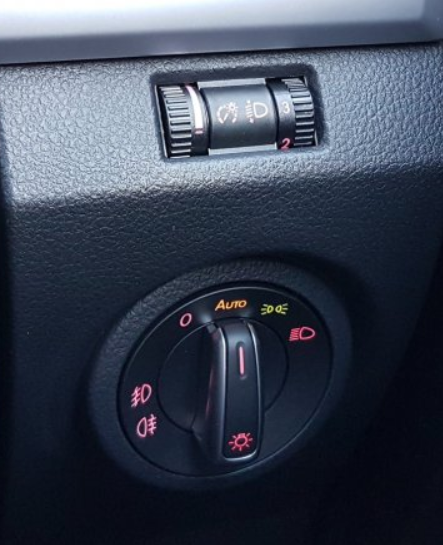

"Screenshotted" from another vehicle but I would say the "hole" that's been covered would have the height-adjustment and the brightness of the instrument cluster in a vehicle without the full-LED Headlights.

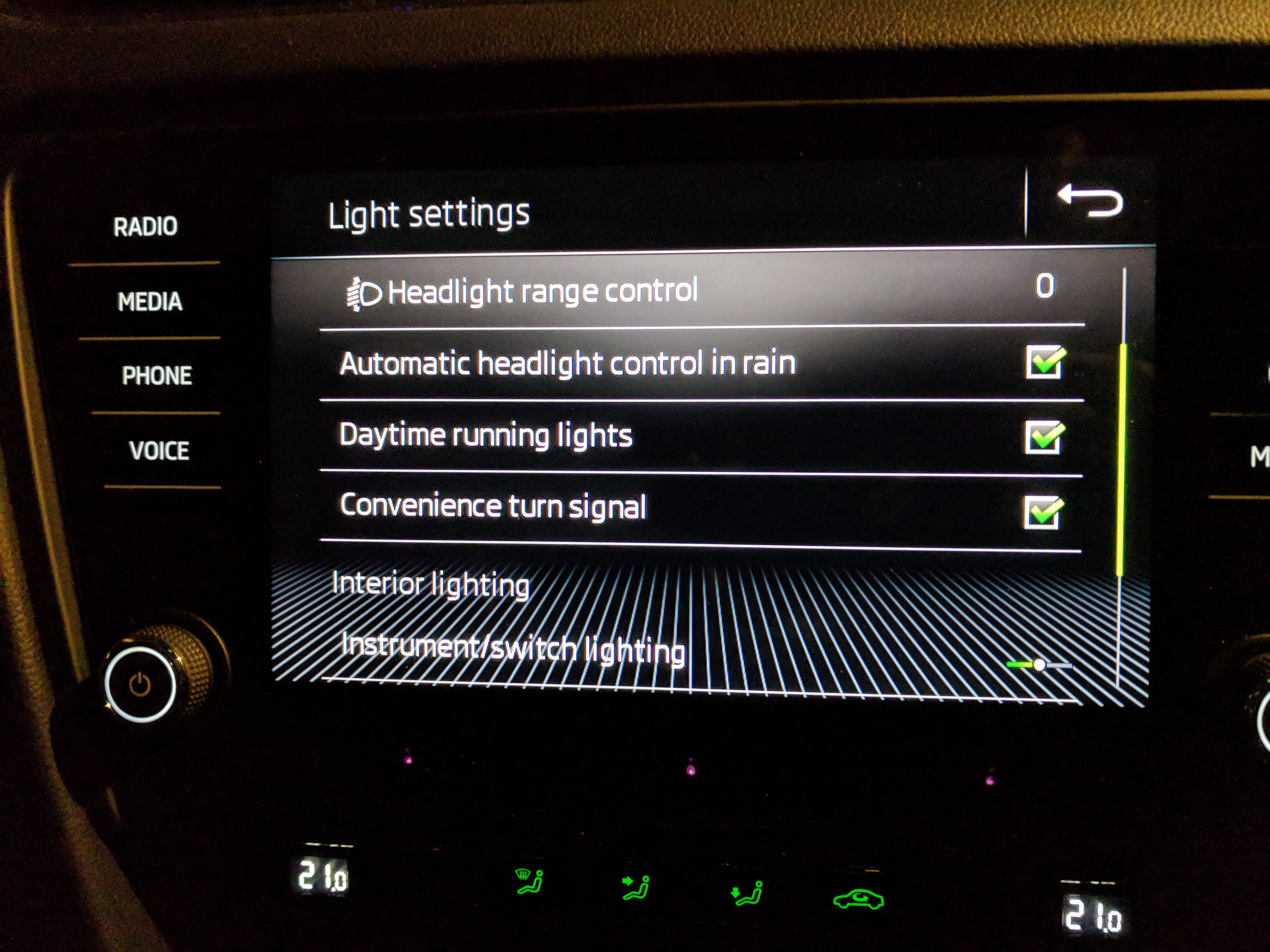

I have halogen FL lights and in my Infotainment menu, I have Headlight Range Control as an option:
Although it mentions 0, 2, 4, 6 as values, I just have the green bar with -/+ to adjust it. When doing so, you can see my lights drop/raise accordingly.
Edit: I can also adjust the brightness of the instrument displays via the Infotainment too.

I actually completely missed that there wasn't the adjuster (I don't think I have the pictured hole either) as I came from a pre-fl with bi-xenon/auto levelling lights.
Randomly came across it in the menu when fishing about in the new car :D
Turns out I do have the 'hole' too :D
heres the menu I was on about.
It is cheaper for Skoda to allow their adjustment via the infotainment system, than it is to have a separate / physical switch.

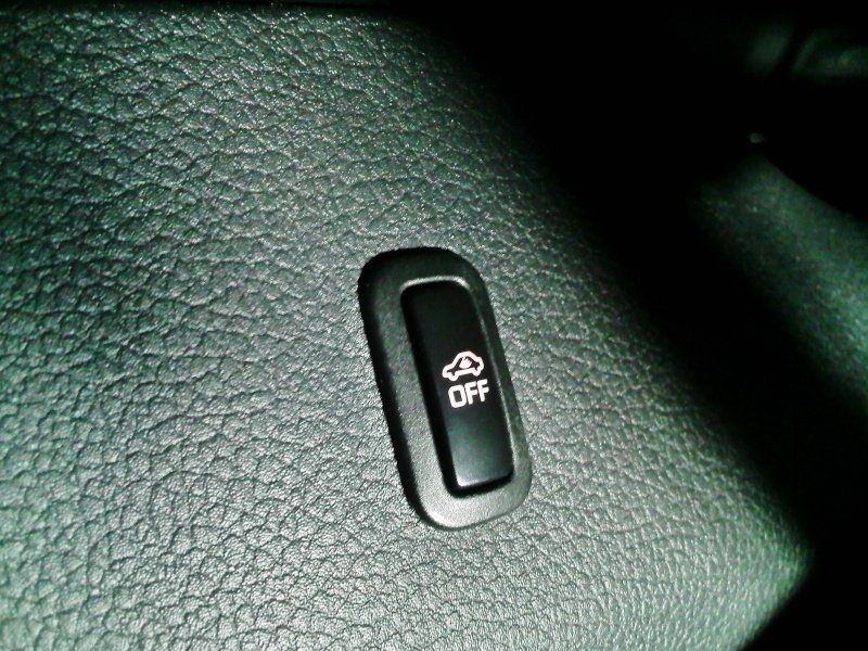

They've done it with the interior alarm sensor button on the B-pillar too...
I'm guessing they've left the plugged hole in the dash is for those models / markets that don't have the more advanced infotainment systems and therefore still require the physical control.
It means you can't safely adjust the dipped beam height while you're driving, and it's difficult to work out the correct height while stopped. On straight level roads I check that my lights are just illuminating the bumper of the car in front and adjust accordingly.
How many people are going to remember to adjust the beam height after loading up the boot and before starting a journey? This is just going to lead to more badly adjusted headlights. :-(

The adjustment is to lower the lights when the boot has been heavily loaded, not raise them. You can't raise them any higher than the legal maximum. Without the adjustment heavily loaded cars would be driving round with their dipped beams high in the air.

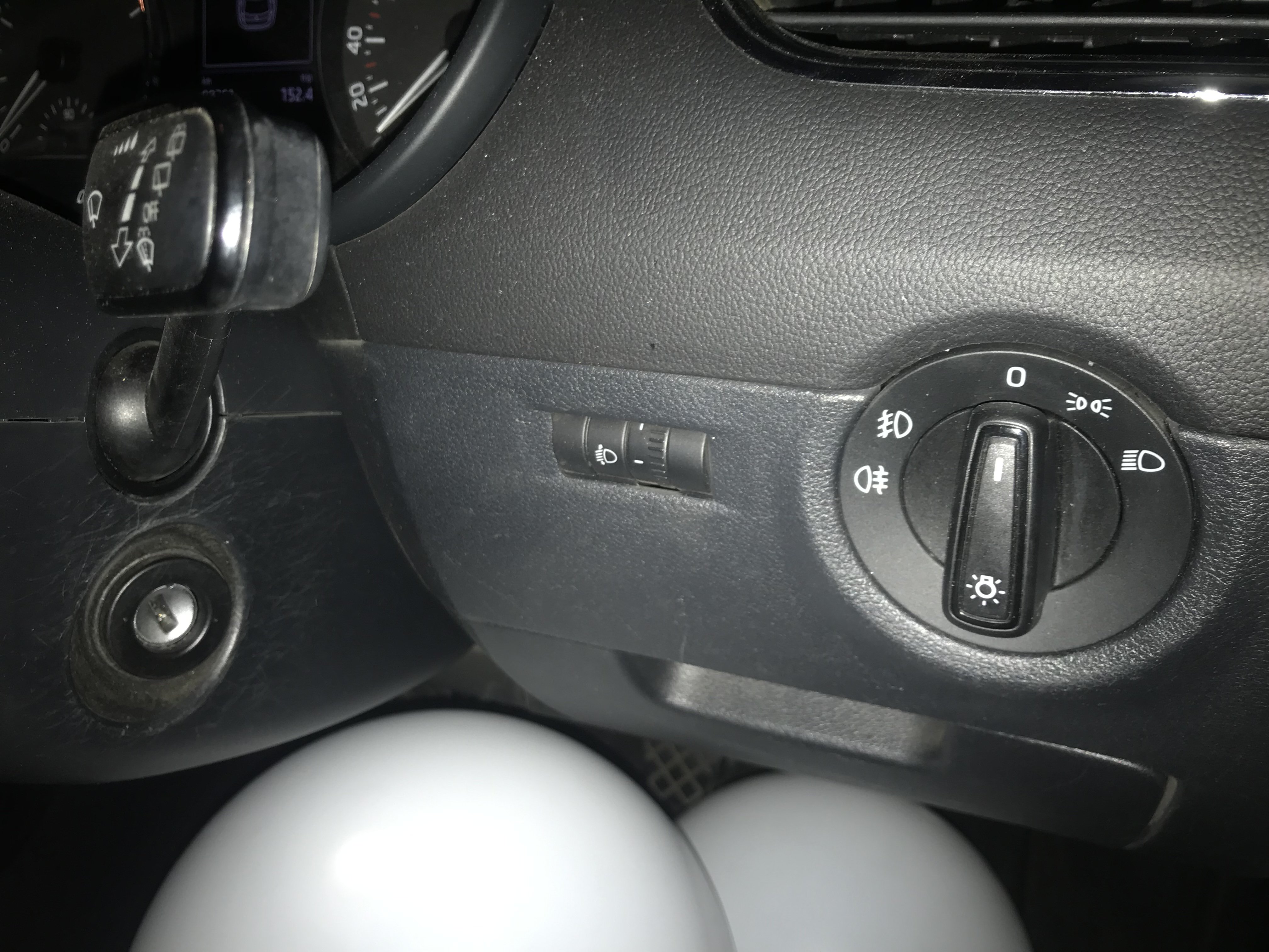

Here is a picture of mine.  The hole is where the manual headlight adjuster is.
