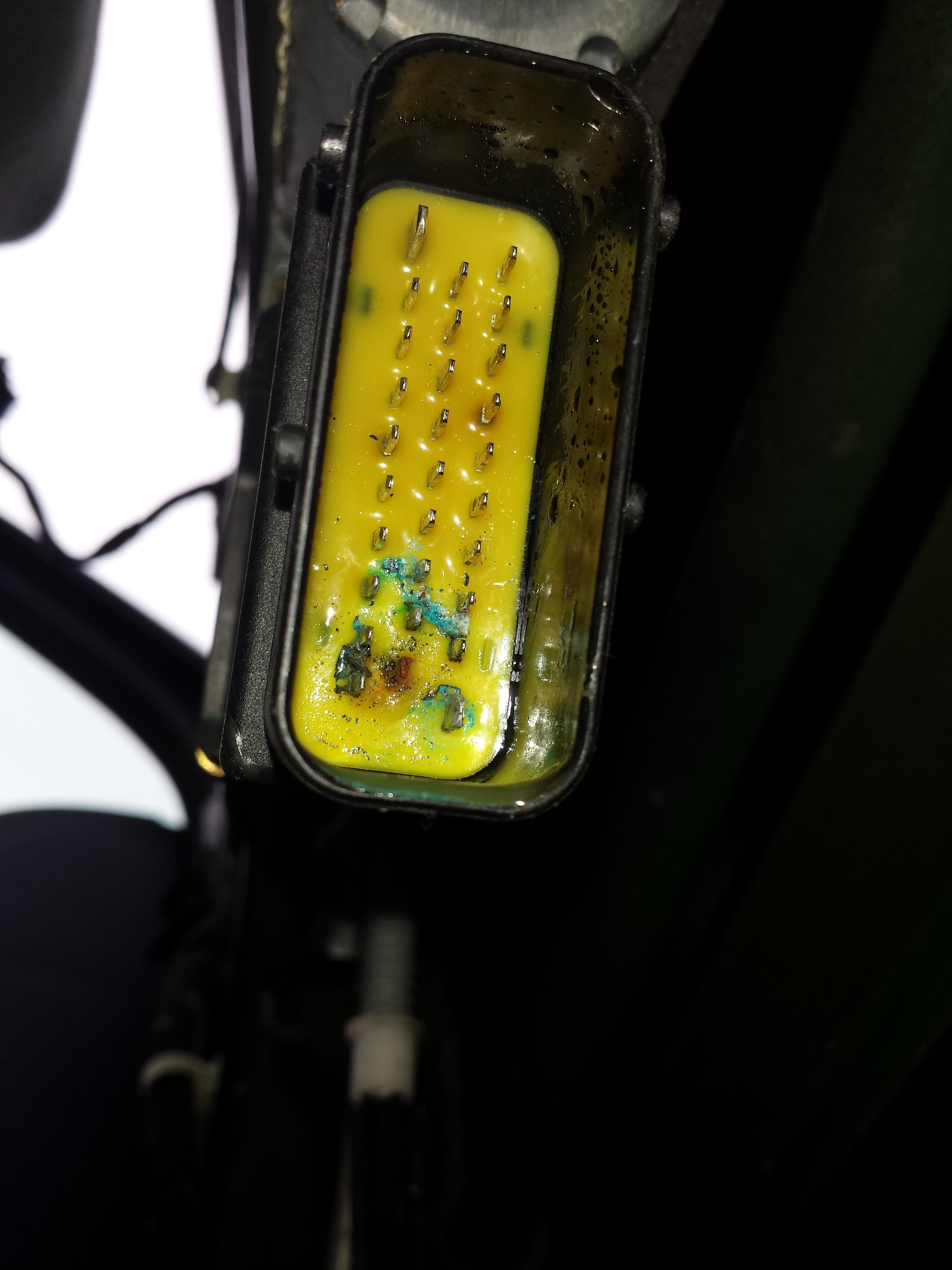

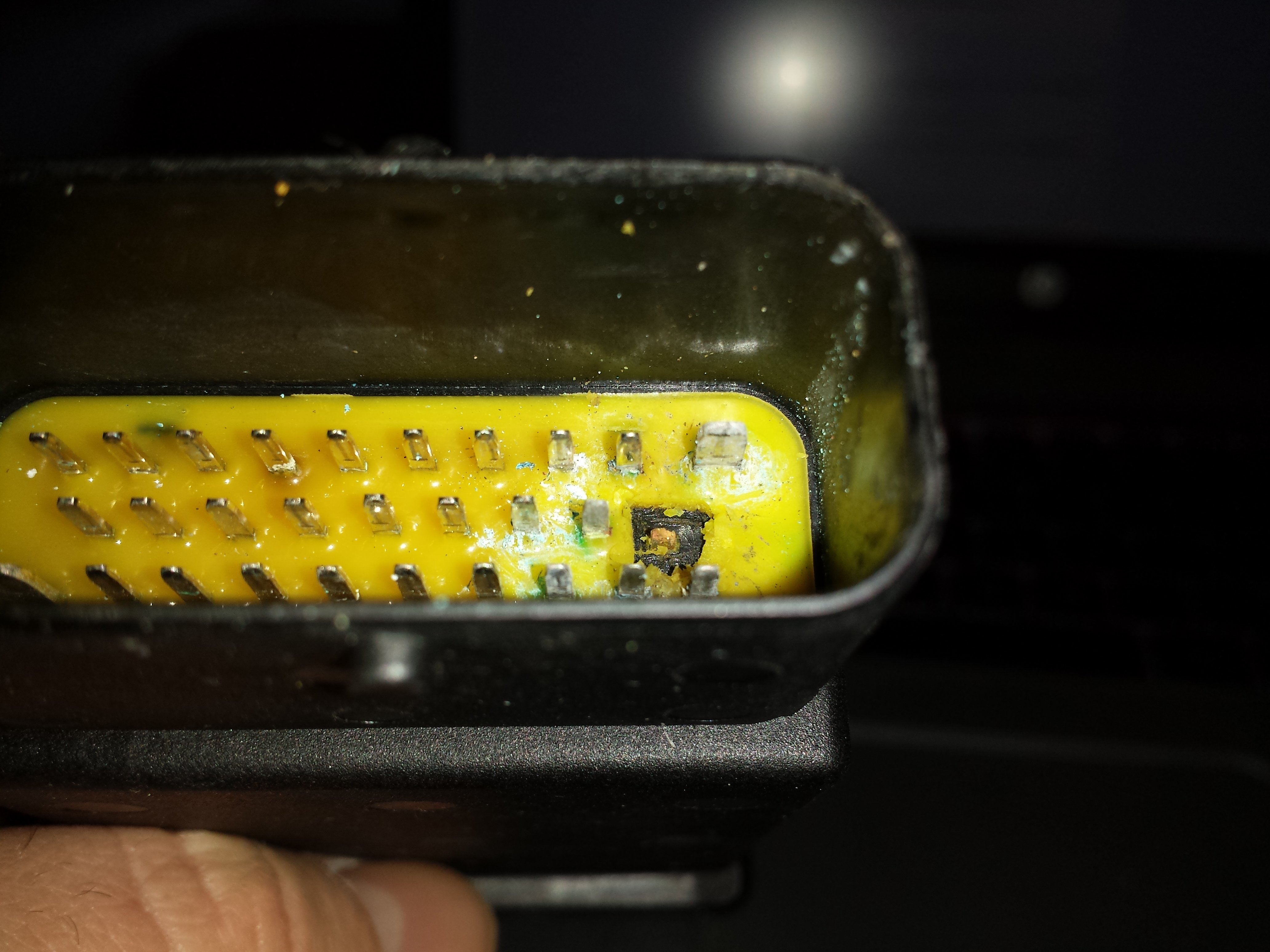

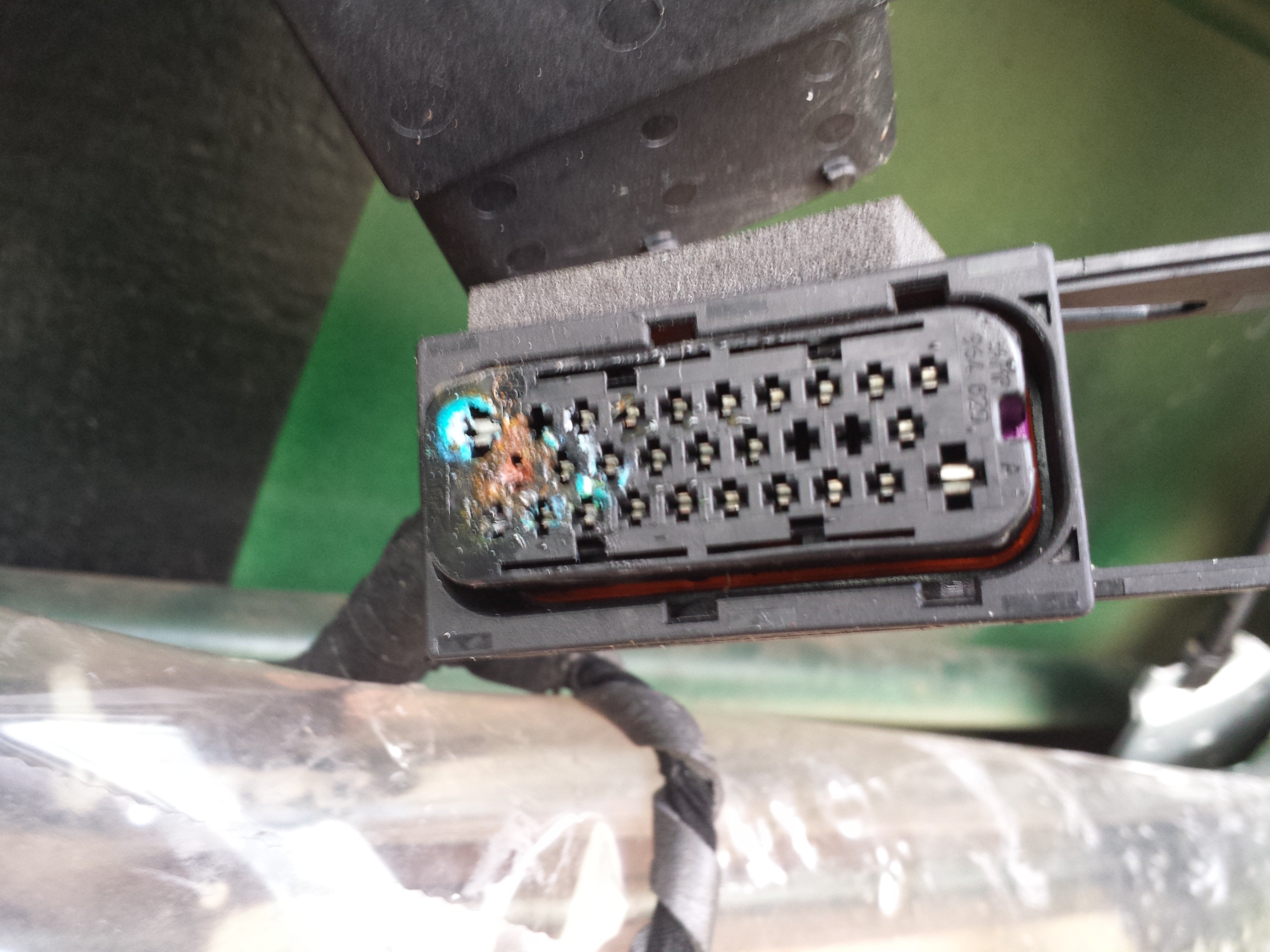

I have a 2001 with non remote operated central locking with many of the same issues you have, but generally can get back doors open (O/S/R is hit and miss can be locked for days). In my case I know where a lot of my issues stem from and that is in the control module in the drivers door which I understand is the master of them all. The multiplug that goes into it and likewise inside all the other doors tends to corrode it's pins off. Mine was corroded too far down to salvage and an attempted fix worked for only 6 weeks (4 years ago).
In my mind, car having sat up to allow battery to die, will have also inclined more dampness inside the crap design of the doors themselves. See pics of my drivers door multiplug etc. Sometimes people get lucky and can save the pins before they rot off, but if it's not been done since leaving the factory 20 years ago, it's a big gamble, could be a few still working but ready to come apart if unplugged. I'd start in drivers door as it talks to all other locks and then move to front passenger. You might get lucky and find it all manky, clean and rears open, if not it's a pain to get door cards off while closed. I keep mine with all screws that go around the edges off just the 2 big screws that are behind the interior door handle so if it happens to me sometime (which im shocked it hasn't already) I can still get them off to get in there.
Realistically, what I am intending to do is just decommission the central locking totally and pull the fuse so all doors are old school that way rears won't deadlock when locking with key so will still open from inside and I should be relatively safe. I am on my 3rd drivers door lock barrel at moment and 4th will need to go in soon I can feel.  Today similar to you, but opposite side, I can lock car from drivers door (all locks with O/S/R sometimes not), but unlocking key physically turning will unlock drivers door only, boot and passenger barrels will do all except drivers door. As I am physically turning lock in drivers door without the micro-switch as soon as it's hit throwing the central locking in to do the rest, it's wearing hard on the barrel(s), but they are dirt cheap. Multi-plugs and wiring between doors and car in the grommet is where I'd be looking first.
