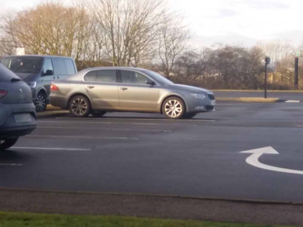

Before having the fix done, I was shouting as loudly as the others, warning people not to do it. There was no benefit to having it done, you're only introducing unknown risk.
For the reason stated earlier, I had the fix done (with the full intention of having it rolled back after the EGR was replaced under the TBM), but as it happens my car runs exactly the same as before.
My Superb is like a nice pair of slippers, she is very much moulded to me. Spending three hours a day in her it is fair to say I know all of her little quirks and habits. I'm very sensitive to any driving style or mechanical changes, so when I say there is no difference post-fix I am being honest.
I therefore never bothered having the fix rolled back. That was several thousand miles ago now.
Here she is out of my office window, dirty but ready and raring to go later tonight to get me home, another 62 mile journey that completely unphases her...
