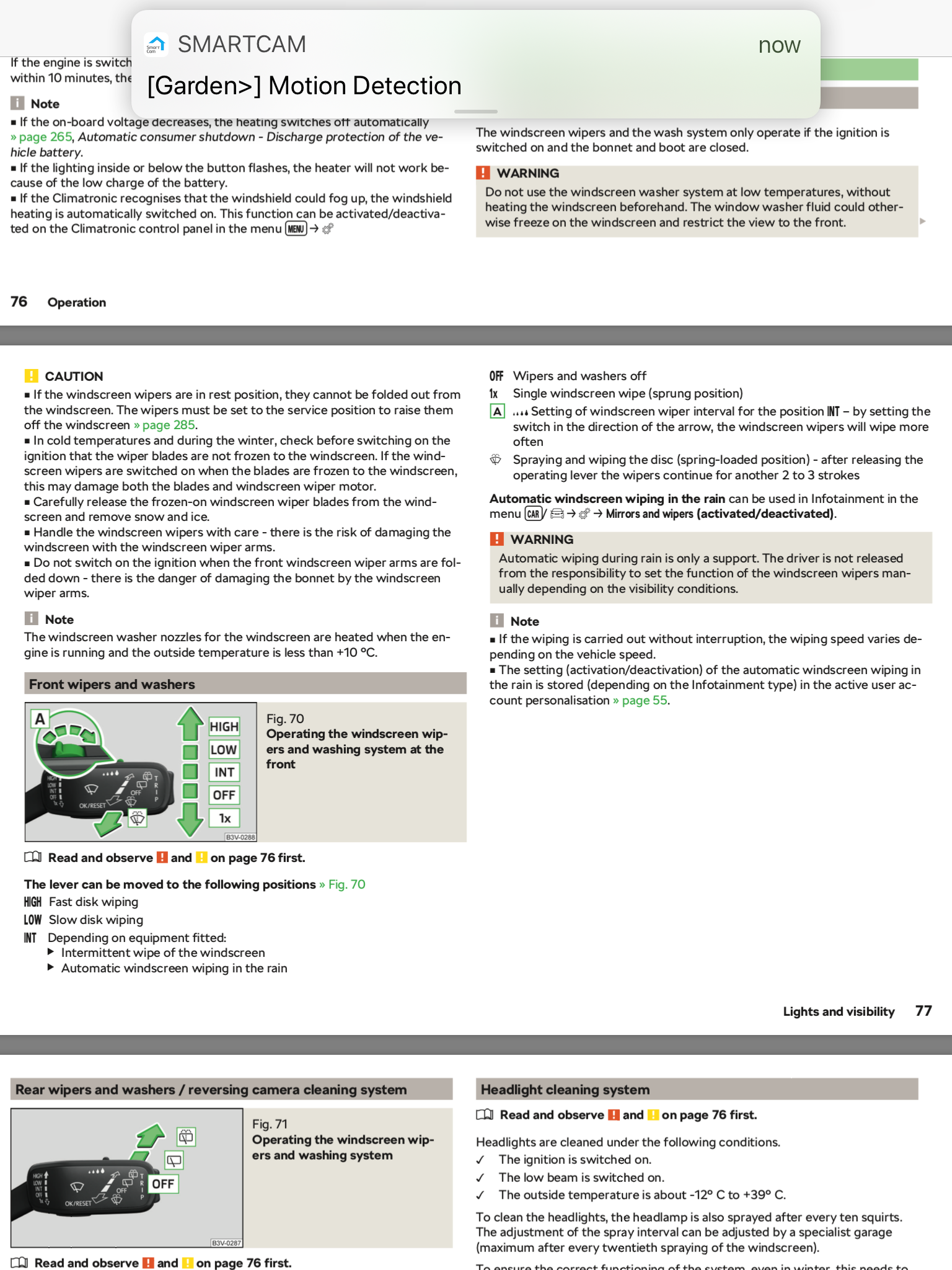

If the car has got rain sensor
From the owners manual....
