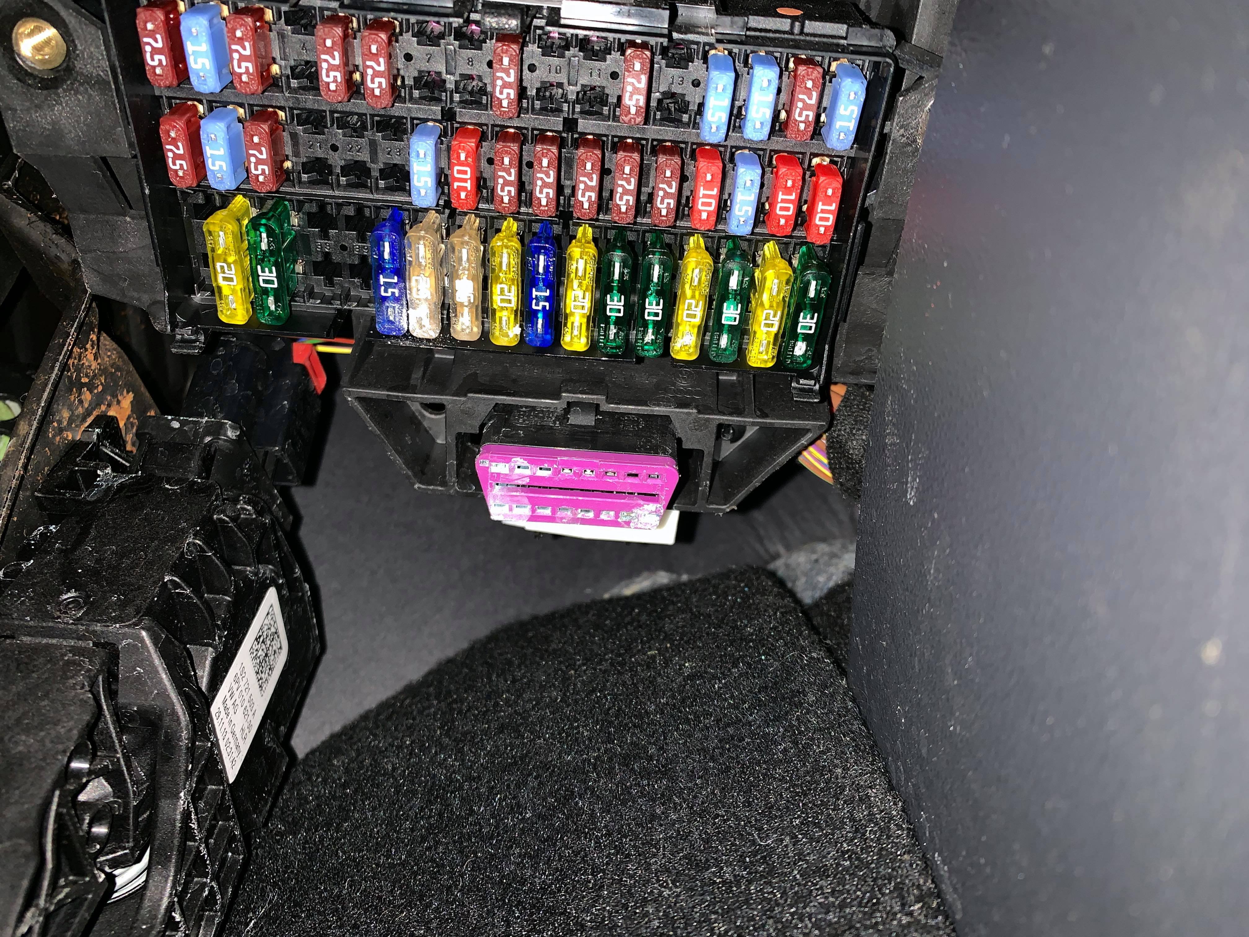

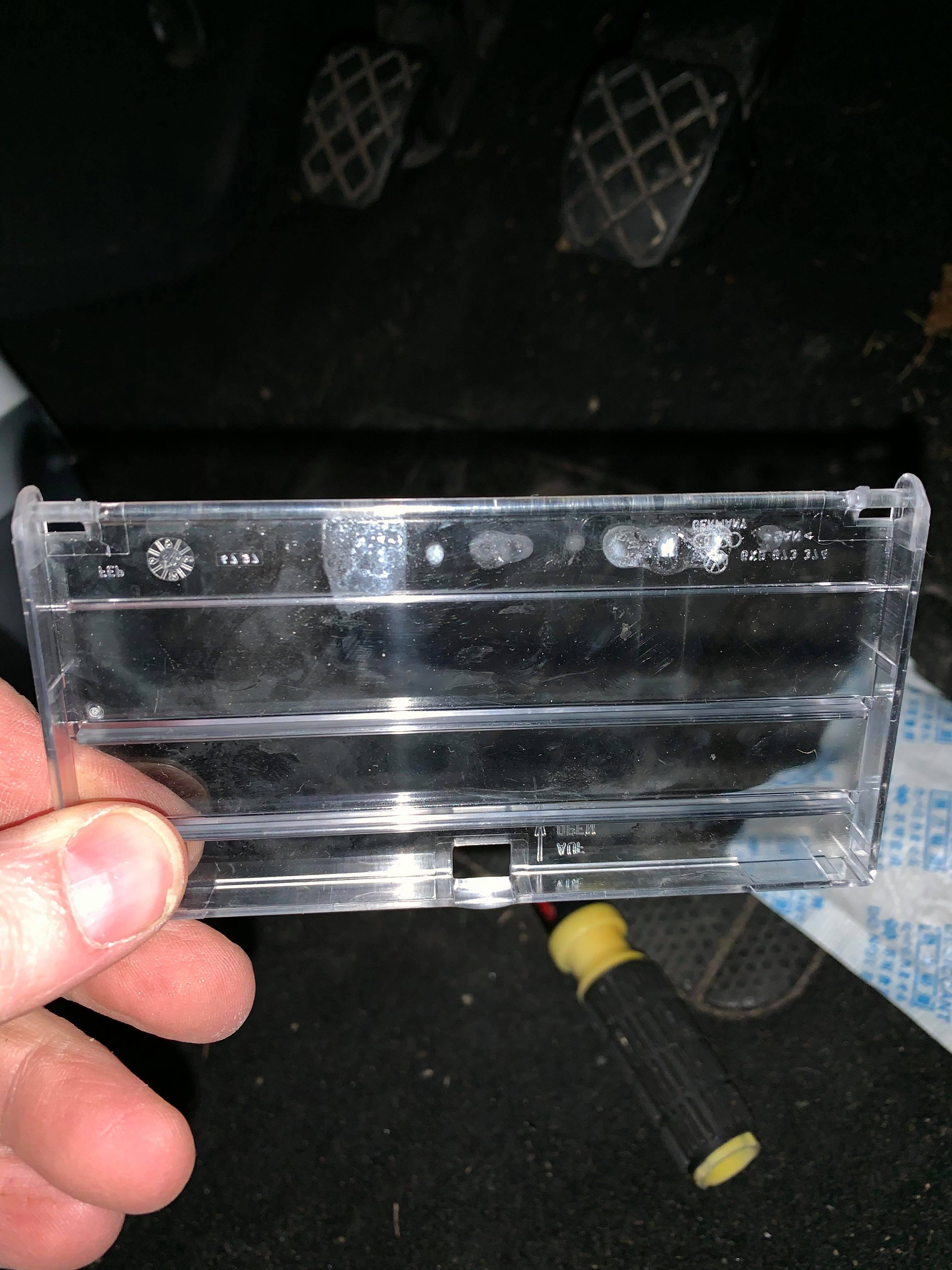

Hey David, further checking shows some corrosion around the OBD port and actually on a couple of fuses (including leaking onto the fuse cover as show in photos below) so there is definitely some moisture ingress somewhere, I've now put the car in my garage in order to get the best chance of drying/moisture trapping.
I have put bags of Silca crystals around this area and moisture traps just below in order to draw out the moisture (if still there)

ok only managed to get back looking at this....... Cars been sitting in my garage since.
Took all the fuses out and refitted them one by one.

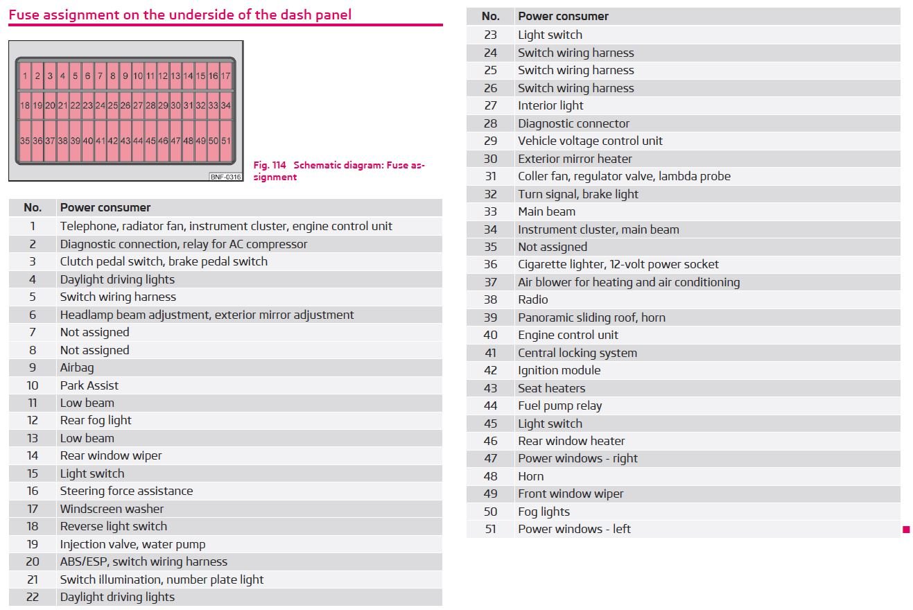

Strangely I have a fuse in Fuse position 26 (7.5A) which according to owners manual is NOT ASSIGNED, when this fuse is in position the lights do the weird self flashing thing with relays clicking.
Any ideas what fuse 26 is all about, seems whatever system its related to is the root of the problem, strange no details in manual (or web search!)
Vw Up! Fuse layout shows it as "switch wiring harness" if its causing problems, leave it pulled (esp if its unassigned in you manual)
And drive, or test systems to see what doesnt work with it pulled.

When I look at fuse assignment for Citigo RHD as of May 2013 and as of Nov 2014, I see the following listed for fuse 26 (and 7.5A rating):
Main relay -J271-
Dash panel insert -K
Steering angle sender -G85-
Knowing the exact date the car was built and engine code would enable me to dig a little deeper.
