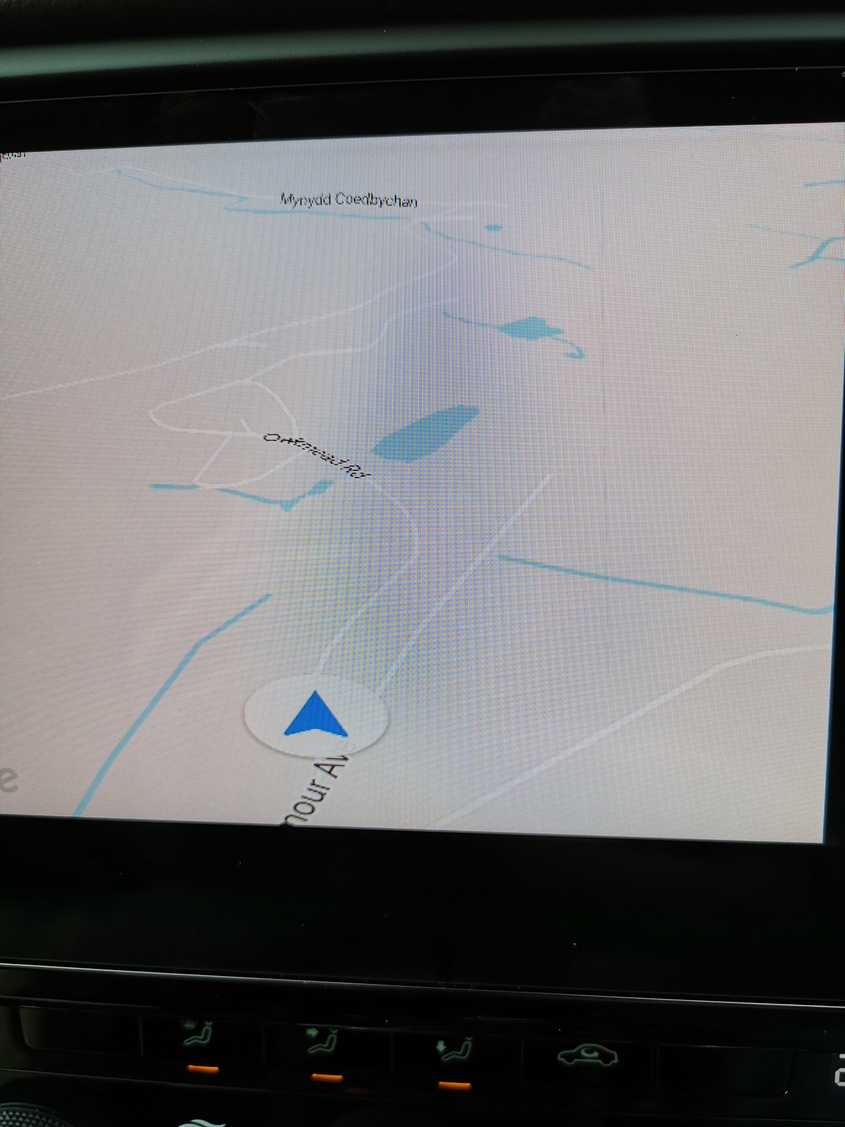

Hi all,
I've noticed today that somehow there is a hairline crack on the display of my 2017 stock vrs head unit display.
I can't fathom for the life of me how it has ended up there. I'm the only person in the car 99% of the time.
The strange thing is the digitiser/touchscreen part (or that's what it's called on a mobile) is fine. The crack is a vertical line just right of centre of the display running from the top to about 2/3rds of the way down the screen.
I'm taking the car in for a gearbox leak that was picked up on the first service next Wednesday, so they will look at it then to see if it can be replaced under warranty, but I'm anticipating a fight on my hands, despite the fact the digitiser is unblemished and the crack doesn't have any lcd bleeding or circular strike marks on it. I.e I can't see how it's something I've inadvertently done myself.
Given I'm expecting this to be well north of £500 for the dealer to replace if/when they say the warranty won't cover it, how can I replace the lcd element of the display without forking out for the entire thing?
Please if ignore the discoloration on the picture, that's the phone freaking out and causing that I'm afraid. IMG_20190206_130107.thumb.jpg.53014b5809385d1945b93d9b344f3bc6.jpg
Thank you!!

Looks more like a faulty address column in the lcd than a crack in that picture.
if so that to me would be a manufacturing fault, so a warranty job.
i would just see what the dealers say.
Edited by cheezemonkhai
^^ This.
Looks like a line of "dead" pixels on the display. If the "crack" is a straight line then i'd wager it's the pixels on the display that are at fault, take it back to Skoda garage and see if they'll replace under warranty.
So on much closer inspection it looks like there is some sort of very small strike mark on the touchscreen part of the display near the area where the lcd crack is. So I highly doubt they will cover this under the warranty.

Screens are not coded, they are just screens. I’ve had 5 different screens in my car. Check eBay before you head to mainland Europe. The part number for the Amundsen screen is 5E0919605M and you should be paying about £200-250. The Columbus screen is 5E0919606D and you should be paying about £350-500. The dead pixel row a third of the way in from the right is very common and probably has nothing to do with the display being hit. That’s likely to be coincidence.

It's definetly a crack in the lcd unfortunately.
