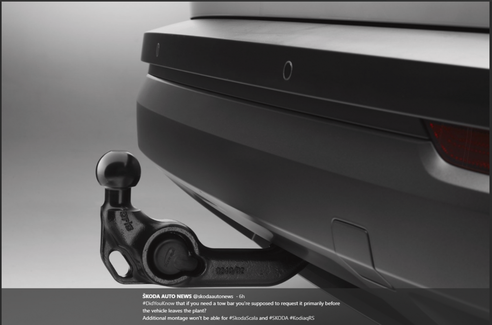

According to Skoda Auto News twitter feed today, if you're buying a Kodiaq RS and wanting a towbar, do make sure it's included in your factory order as it seems there may be difficulties/restrictions on retrofitting at a later stage.
https://twitter.com/skodaautonews?lang=en
Good to see that the guy who wrote the Superb 2 Owners Handbook got moved to a new job on their Twitter team.... I just wish he would finish his English language courses.

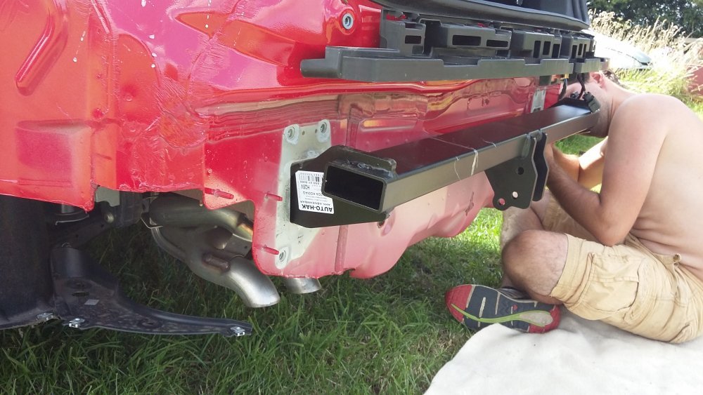

Admittedly, not a vRS, but an aftermarket tow bar replaces the crash beam which you'd hope is pretty standard across all variants of the Kodiaq and stays well clear of the exhausts...
Perhaps the factory fit version, with it's more complex installation, is more likely to get in the way.

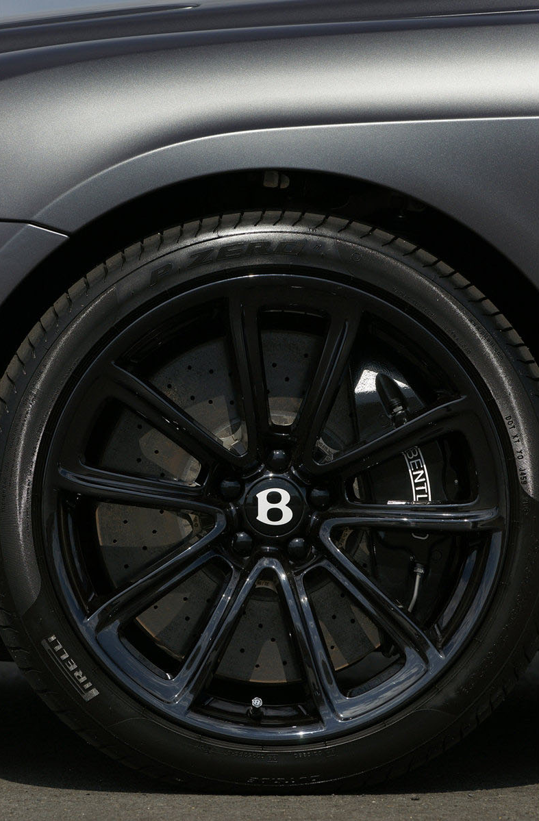

It's absolutely egregious marketing. 17" is about 430mm, and the Bentley Continental GT has 'only' 420mm front brake rotors. Here is what they look like on 20" rims.

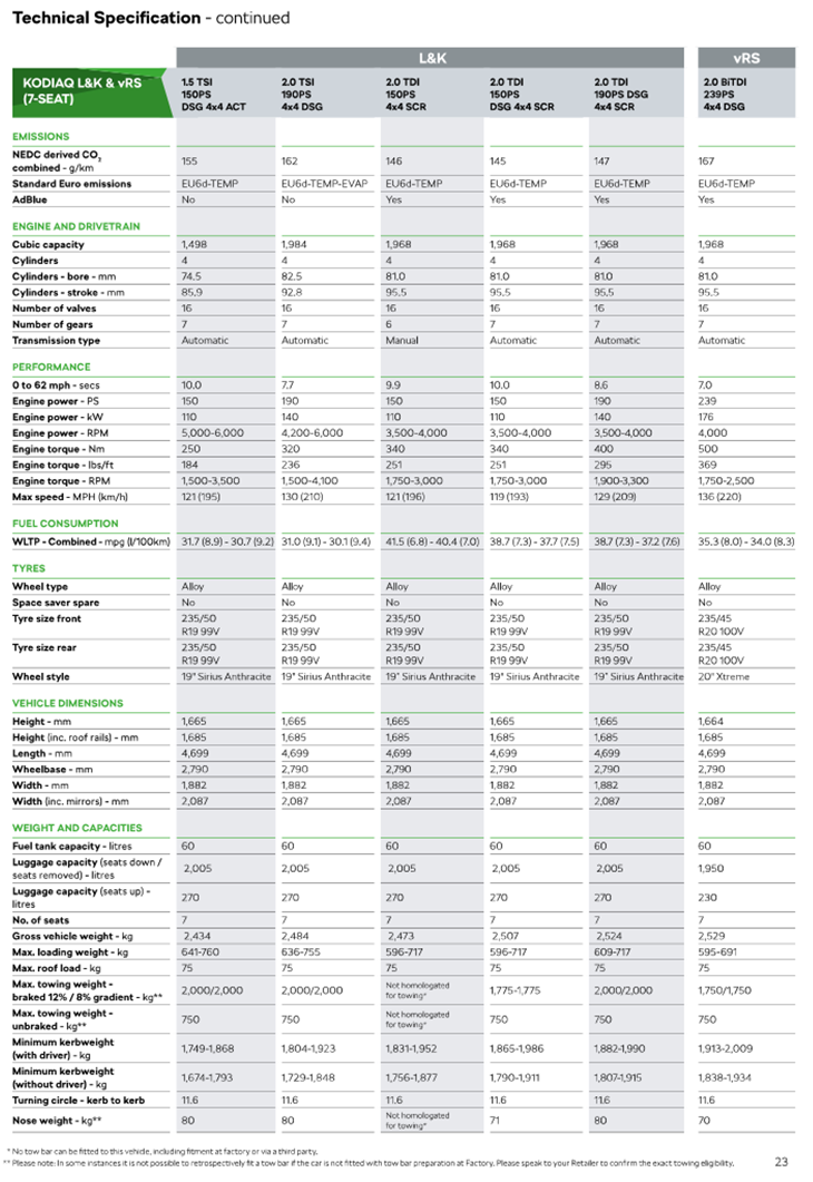

The 5-seat RS is not available to order in the UK.
An extract from the UK specification (Feb19) details the maximum towing weight for the RS as 1,750kgs:
Edited by Arkaig
Strange. Doublechecked on Finnish Skoda site and true, 7 seater has 750 kg less towing capability.
