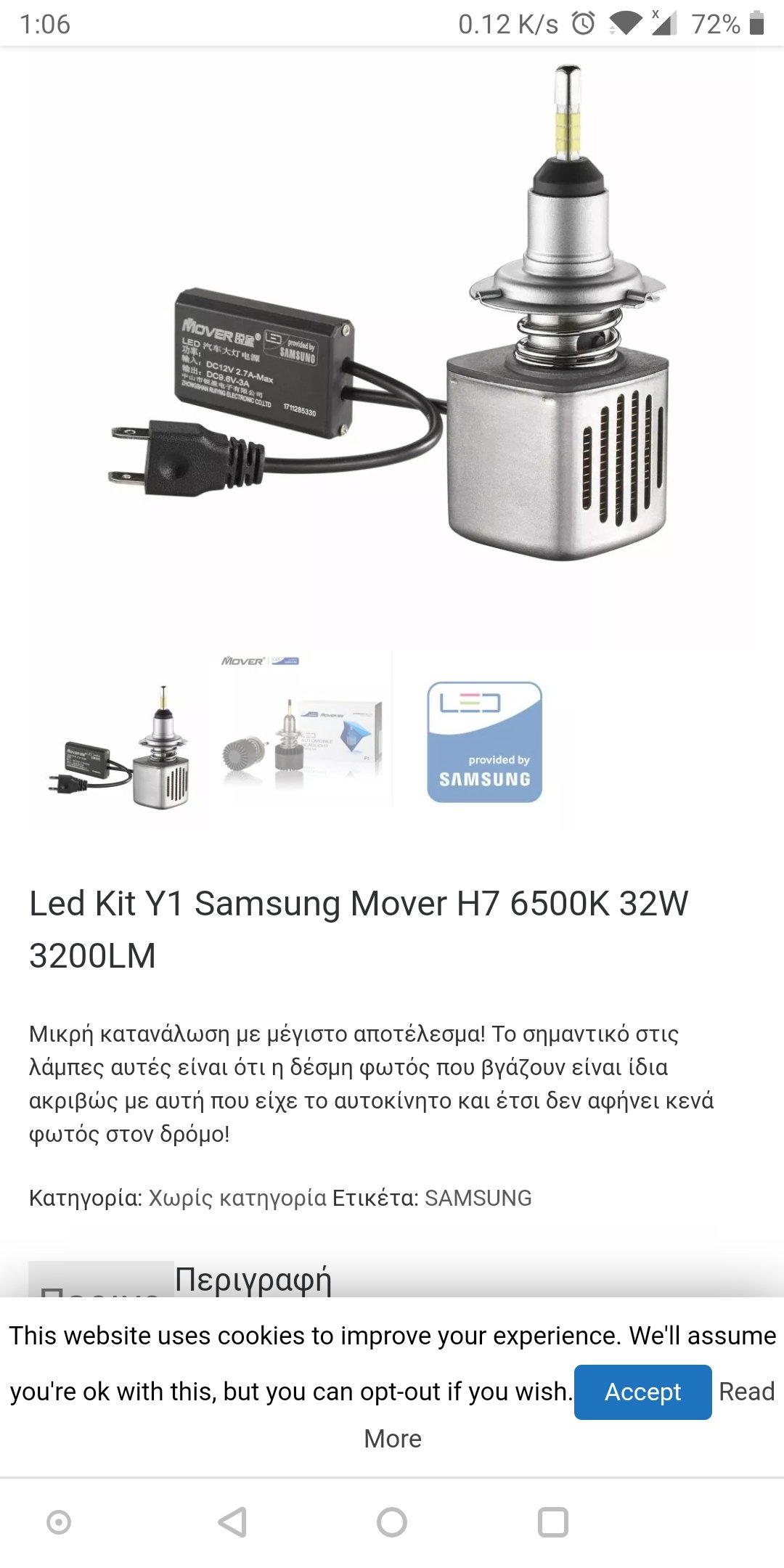

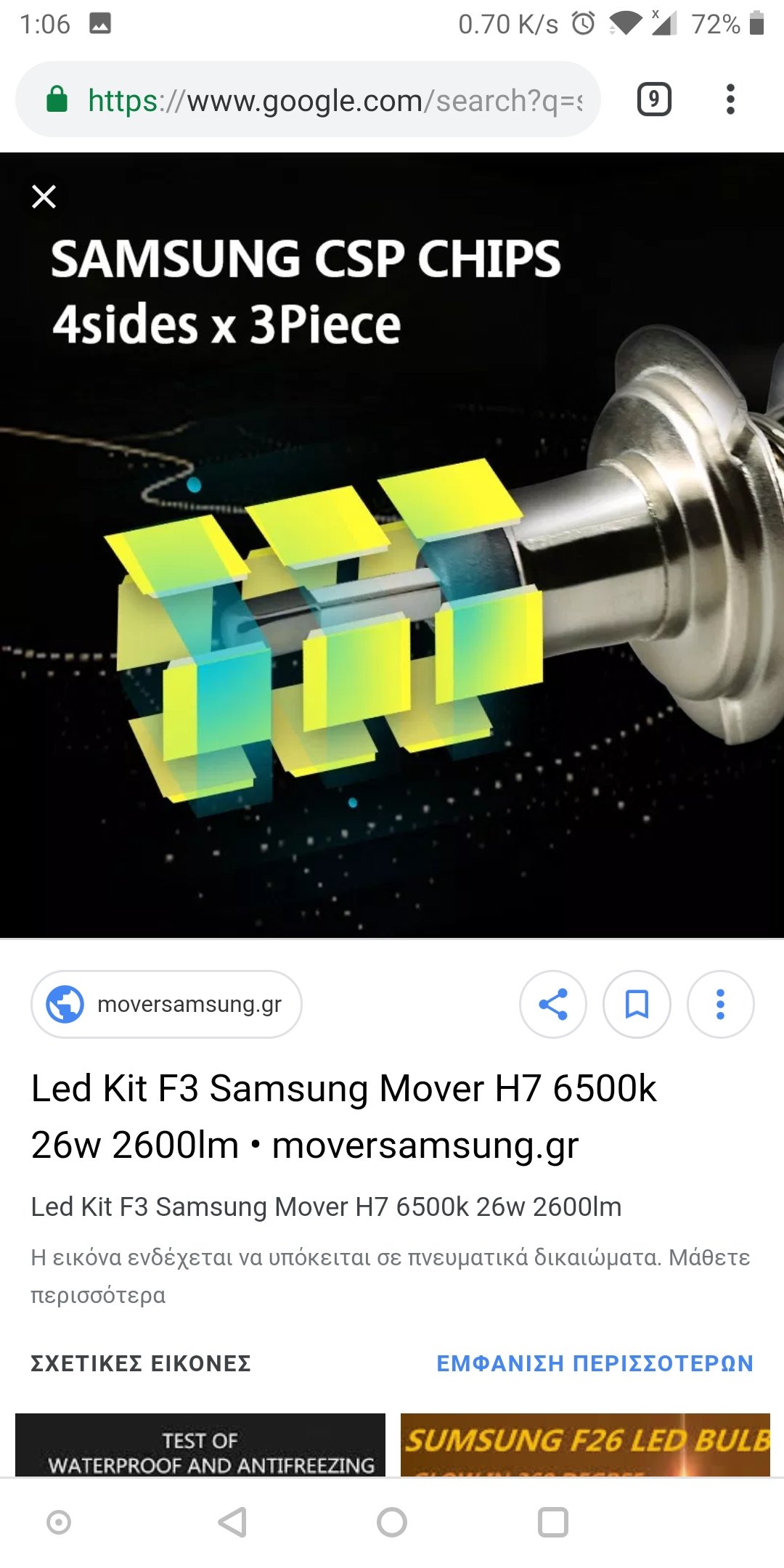

About dazzle I suppose there are other solutions.
1. Retrofit projectors kit
2. I found this led kit which supposed to be similar to halogen due to 360° light. 4 sides LEDs.
Also the Philips ultinon extreme led kit.
I suppose led are more safe for car, for heat issues, for the headlight, for fire issues
LED’s will be safer in as much they use less power and therefore generate less heat,
however as this is relatively new territory you may fry your BCM (as many Octavia’s did once HID’s were fitted)
many LED’s are also pretty crap with their light output, Novsight are meant to be one of the best... but there are also many Novsight copies on the market which will be equally as crap, you may also have problems physically fitting them inside the headlight.
The safer way (if you genuinely are the only one on the road) would be fitting an LED light bar, as good ones are truly amazing.
I have 3 of these fitted to a truck and when I say they turn night into daylight it is no exaggeration... but they are not cheap*
*Cheap is rarely good and good is rarely cheap.
LEDs need a resistor when used instead of a halogen bulb. Otherwise you get the check bulb error on the dash every time (resistance is how the computer knows bulbs are working or not). The resistors get incredibly hot. Also, you seem to live in Greece so you can't rely on an efficient ambient cooling. If you do this, make sure not to park near dry grass, OK? Other than that, good luck.

Looks like a few people have been dazzled by the 'ol backyard HID conversion. The truth is LED conversion technology has come a very long way compared to the old HID conversion kits where chinese manufacturers just wrapped a piece of tin around a xenon light and called it a day. I'd recommend following Gizmos advice first and just trying an LED light bar; you can easily conceal them behind the lower grille for a very factory look, and they make a world of difference at night.
If you're still adamant you need to change your headlights, go for an LED conversion kit, these days most of them have a resistor built in. The only issue is getting them to fit in the headlight housing as most of them have a heatsink or fan at the back; make sure you can seal the caps back properly otherwise you'll get moisture in the headlight housing. Don't go for the cheapest and don't go for the ones with LED chips all the way around, they are a very poor design. Go for one which has a Cree or similar chip and is designed to focus the light on the correct part of the reflector - like this one. I tried many many different kits in one of my other cars and found that a good LED kit really isn't a whole lot brighter than halogens but are better colour temperature and you can see more off the side of the road. The beam cutoff is the same if the globe is a good design which means other road users are not dazzled. I drove my car with LEDs for about 2 years, a lot of night driving on country highways, and never got flashed once by other drivers - in fact I always felt the cutoff was more defined than with the standard halogens fitted (but that is really down to headlight design). HOWEVER, be mindful of other road users; if you put the kit in and the beam cutoff looks unusual, or there is a lot of residual light above the cutoff, or it is too high even with adjustment, please don't use them like that because it's very dangerous. Regarding the BCM, your car will be just fine with LEDs - you will probably need to code the globe type with VCDS. HID kits can cause big problems, especially down the track if a wire is damaged or the ballasts get moisture in them.
