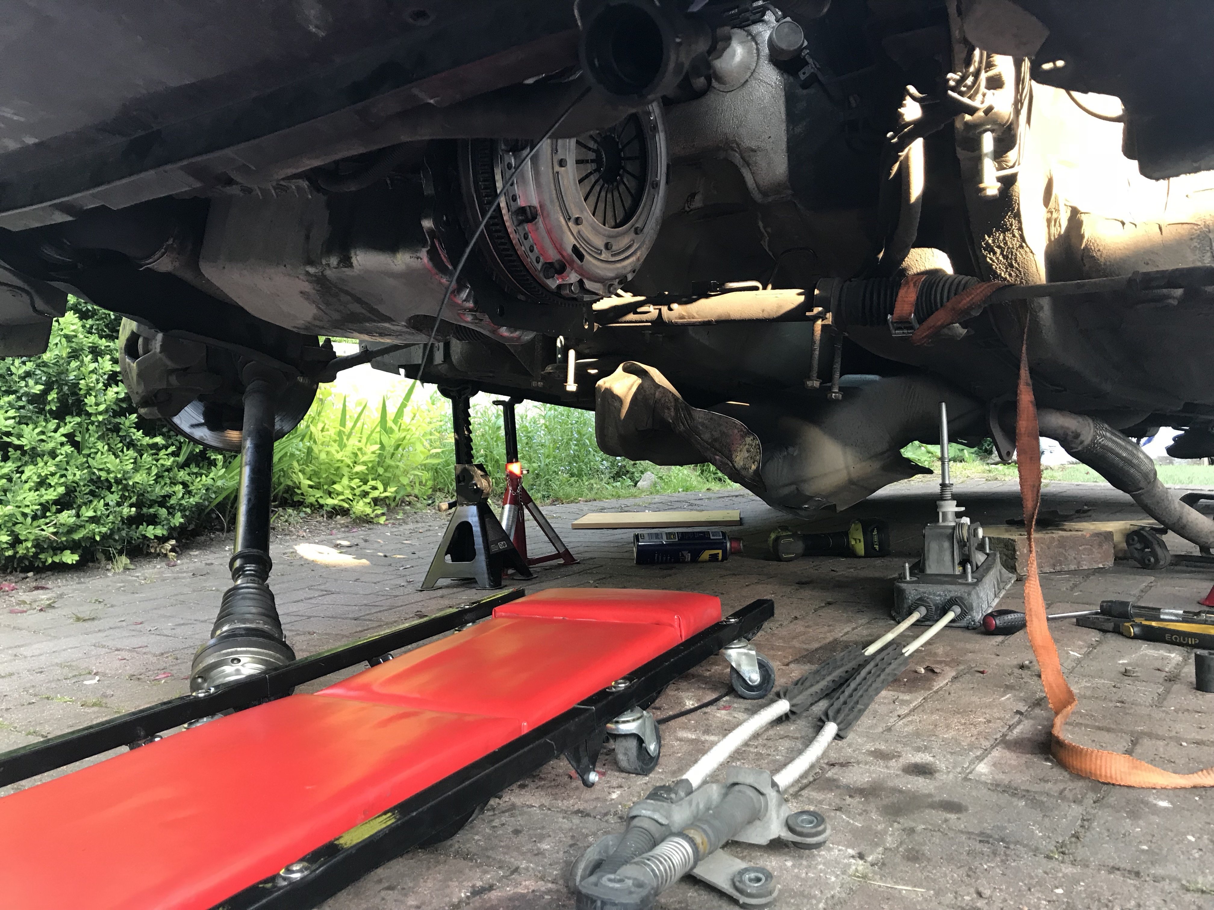

Drive up onto the ramps. Crack off wheel nuts & Jack up each side & put axle stands under. Use wheels & some lumps of wood as a safety feature further back. Crack off the drive shaft bolts on the g-box flange end. Remove air filter, battery & gear linkage. Remove slave cylinder complete.
Now I have a 1" x 1" bar that sits on wooden wedges (wrapped in gaffer tape) in the gutter formed by the wings plus a wriggly roofing hook & a short piece of chain to support the engine. Easy to make from bits & pieces but important. This supports the engine when you have removed the NS support bracket. Crack off all the g-box bolts & lower the engine as far as you can & the g-box will come out. I support it on a trolley jack. Remove old clutch & hoover all the dust out from the flywheel. Fit new release bearing, new clutch & allign with a SP tool or similar.
Now comes the hard bit, poking the g-box back. I cheat & now have a chain-fall attached to a scaffold frame but I have done it with said trolley jack in the past on my MPI. Just takes more time fiddlin'.
Re-fit g-box linkage (when you have re assembled it & you'll have a slick shift & wonder why you didn't do this years ago!) Re-assemble the remaining bitz, paying attention to the tightening sequence of the drive shaft bolts & you've got your car going again for not a lot of £'s.
Can't remember if I took the first exhaust section off or not.....Sorry!

Me and a friend struggled like mad to get the box off mine with the subframe still in place. It came off in the end but wouldn't go back on without damaging something.
I found it very easy to remove the front subframe which enabled my gearbox to go back on, but I found you need a good beam to support the engine from the top, and a ratchet strap around it to lift the gearbox into position as its very heavy to do from underneath. (as has been said above)
If you can get help from someone it makes things much easier and is certainly do-able but will take most of the day going at a steady pace.
also a pressure bleeder is needed to bleed the clutch at the end, which was very straightforward and mine bled up fine first time.
Some of the bolts should be replaced when you do the clutch change, the ones i did were the engine mount bolts for the dog bone and the gearbox side mount, the 12 driveshaft bolts, and I also changed the diff seals and gearbox input shaft seal which turned out to be what caused my clutch slip after it leaked oil all over the clutch. Some will say dont bother replacing bolts but I did not want to risk it after all the work.

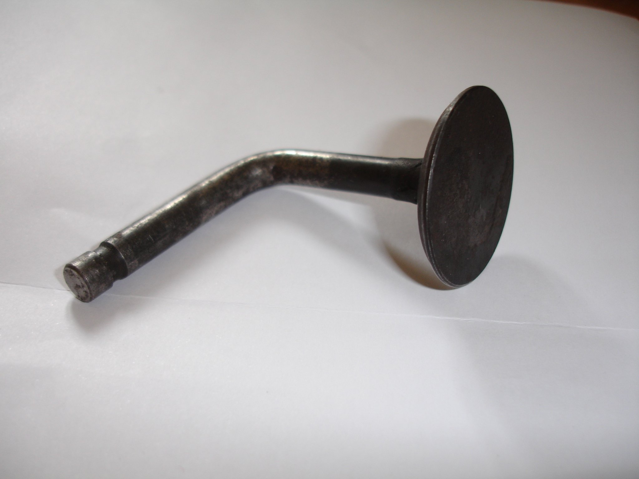

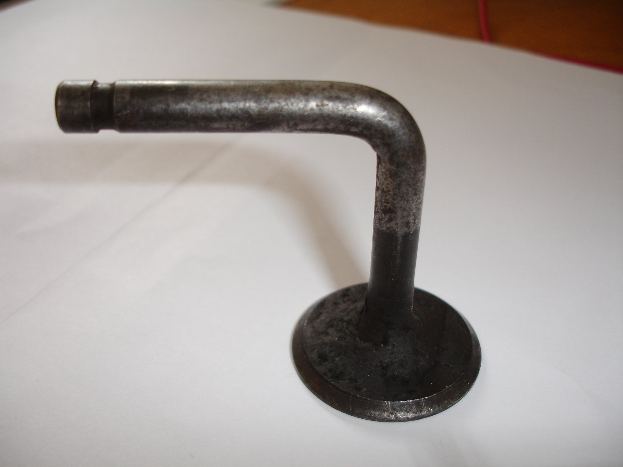

I have a 40 year old 'fly-wheel tool' that is almost a necessity when doing anything on a clutch pressure plate/fly-wheel. Easily made, simple & very effective. Here's a couple of pictures of it.
Shim
The clutch removal pic and descriptions are scary. I'm suitably warned off this, seeing as I was moaning and groaning just getting down to look at the gearbox shims. I'm going to just run with it and if I hit any more problems then I will consider a quality garage I know.
Age comes with its penalties.
Don't let age put you off, ever! Yes to a good garage if you're unsure, as a good garage will look after its clients.
Shim.
I've done dozens of clutches and never used a bent valve :D What's it for?
