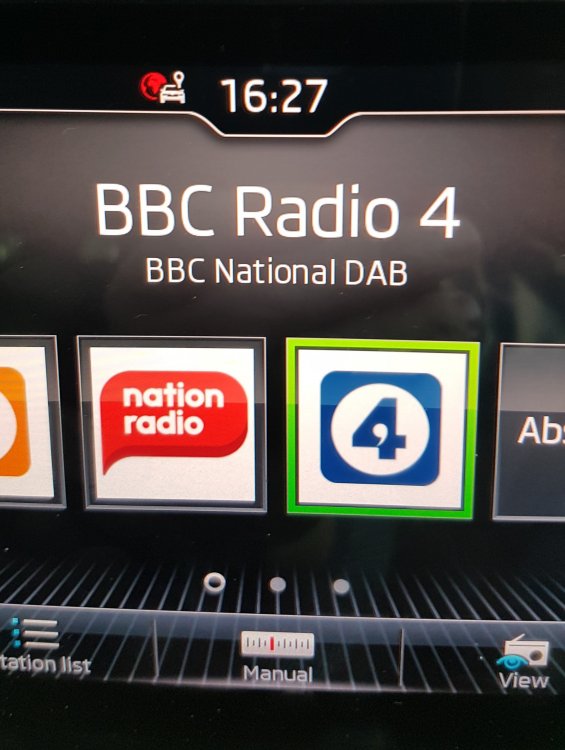

What does the RED icon mean on the radio
On the display on the radio ...to the left of the clock there is a red icon ... I can't make out what it is supposed to be.
There is a car with what looks like a sign post sticking out of it and to the left ...  I have thought it was supposed to be world ... but why and why in red.
Then again it could be a face ..... in any event what is it supposed to mean ? .... can't fin it in the manual.
I asked dealer - they had no idea.
It is our planet and its red because your infotainment system not online...

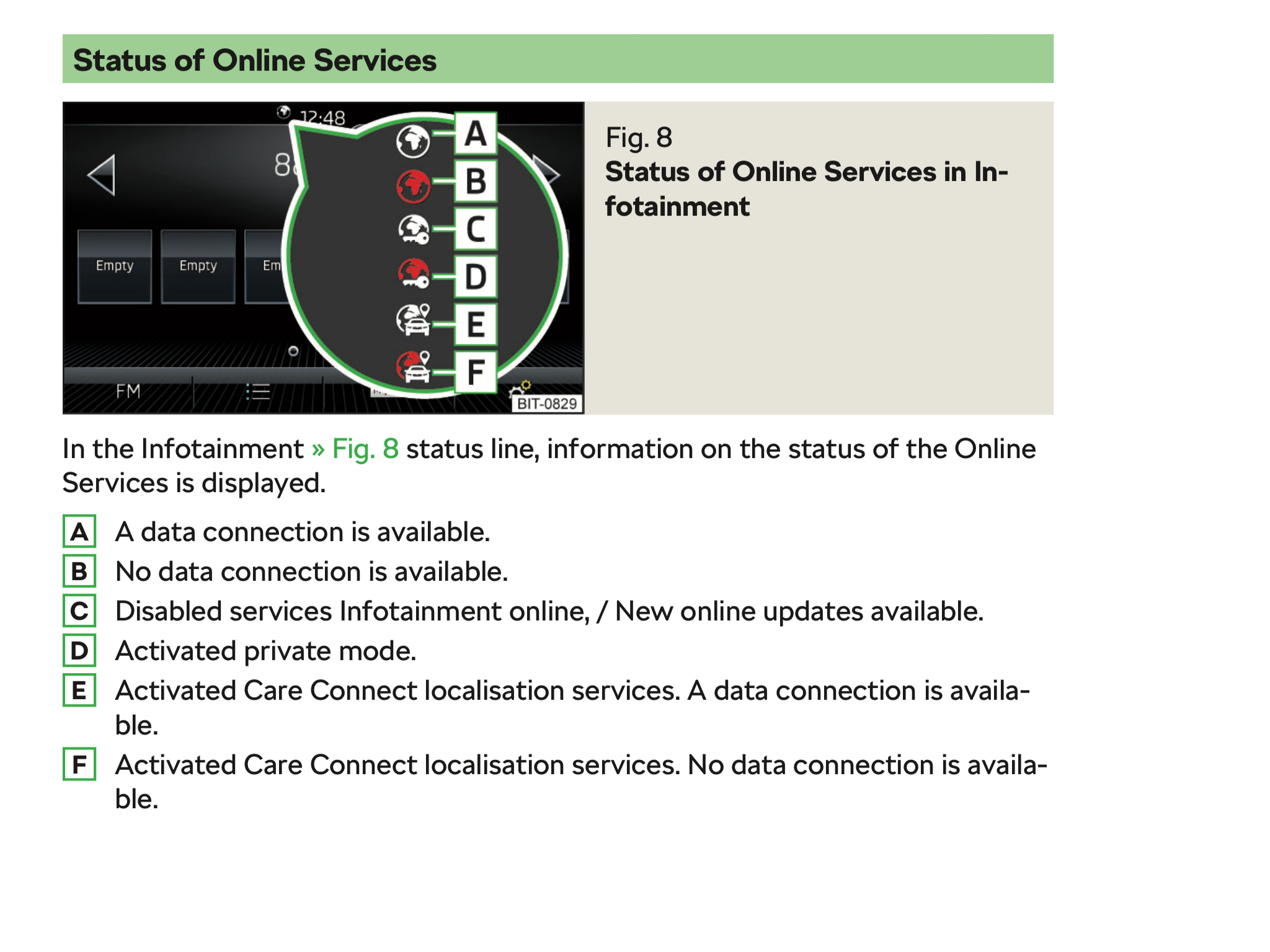

The symbols are explained in the handbook, under “online services” (page 14 in mine).
