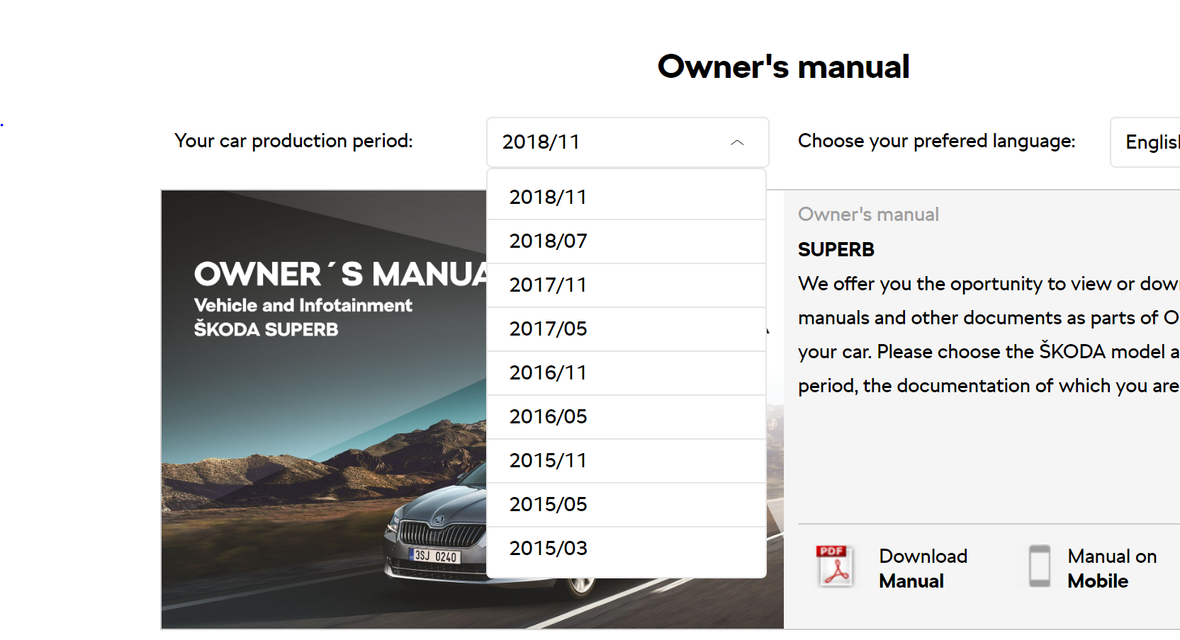

Ok! So a few posts back I had written that I thought I had found the solution by browsing the user manual. At the time I was doing so using the electronic version of the manual from MySkoda app. But when I tried to confirm it and paste here that excerpt from it from the PDF file I had downloaded on the PC as a proof, it seemed it did not say exactly what I remembered and that it referred to the Drive (gearbox) only, not the Drive profile. Well... It seems this happened because I had different User Manual versions on the PDF and the mobile app. That's because up to December or so, despite the mobile app showing the latest information, the only available option for manually downloading user manuals of MY19 cars was the "2018/07" option. Now the 2018/11 has been added too and in it lies the answer:
User manual for up to 2018/07 (the first MY19's made) :
the only mentioned change after turning off and on is the Drive (gearbox) going to Normal (by that it means D1, D2 etc. NOT Normal Drive profile), so retaining Driving Modes is to be expected (and confirmed by owners).
User manual  for cars  from 2018/11 onwards, the above excerpt has been replaced by this:
As is clear, after turning off and on, not only the Drive (gearbox) goes back to D1, D2 but the entire Driving Mode reverts to Normal. 3/3 cars made after 2018/11 have so far confirmed this in different countries so that's how our cars should be (and are) working and that I believe answers the question of the thread as to whether this change is normal and/or official. Turns out that's exactly how it should be. Owners of 2018/11+ cars can quickly verify this by looking up their printed manuals in Driving mode selection chapter (page 178 on the Swedish version).
Whether we like this change and what can we do to revert it back to pre 2018/11 behaviour is a different discussion.
Edited by newbie69
