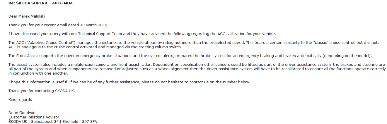

Latest update.
Confirmation from Skoda below.
Meanwhile - I've decided not to fork out £450 to calibrate it. I've fitted new tyres and done wheel alignment at independent garage.
No error messages present. I can't see difference in ACC operation at all.

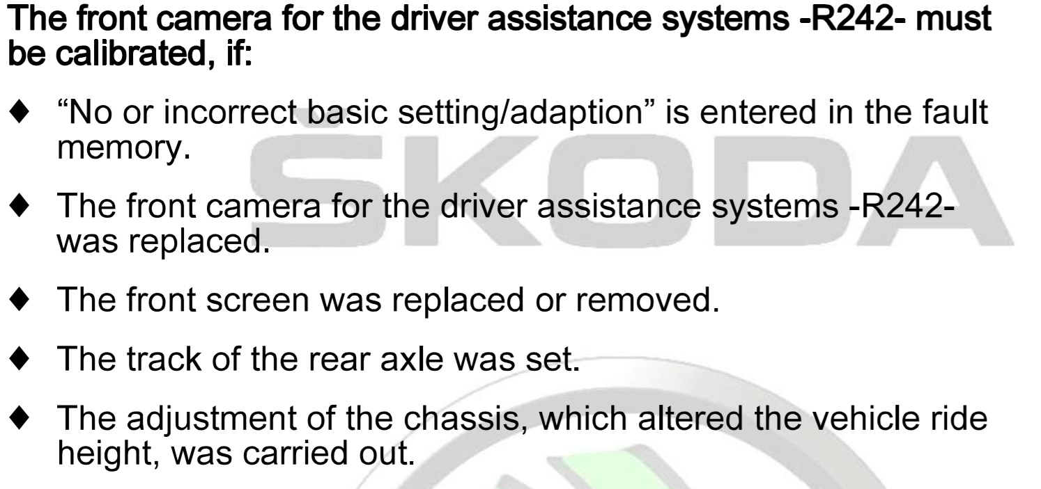

Of course the garages read the workshop manual:
Thanks to Peter K for his posting - but none of those conditions for calibration appear to apply to OPs question. I believe that it would be safe to resist claims for recalibration of the camera/front radar for relatively minor front wheel realignment to original specs.

I thought I was posting the definitive list of events that require recalibration

Fair enough but, unfortunately, a list the dealer appears to be ignorant of in the case of the OP. Or are they pitching for the owner to pay for unnecessary, expensive work?

On 18/03/2019 at 08:10, MarekMm said:
Latest update.
