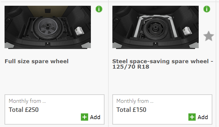

Just wondered if anyone knew, on the configurator it gives 3 choices, Space Saver(skinny), Temporary(215/60), and Full size, with no dimensions.

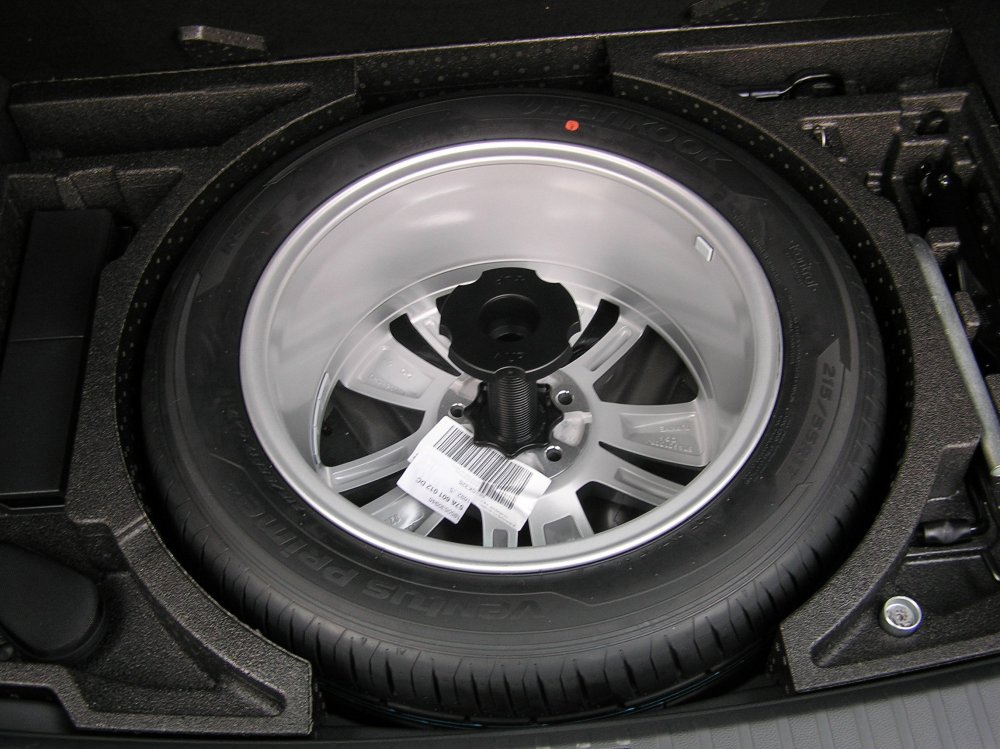

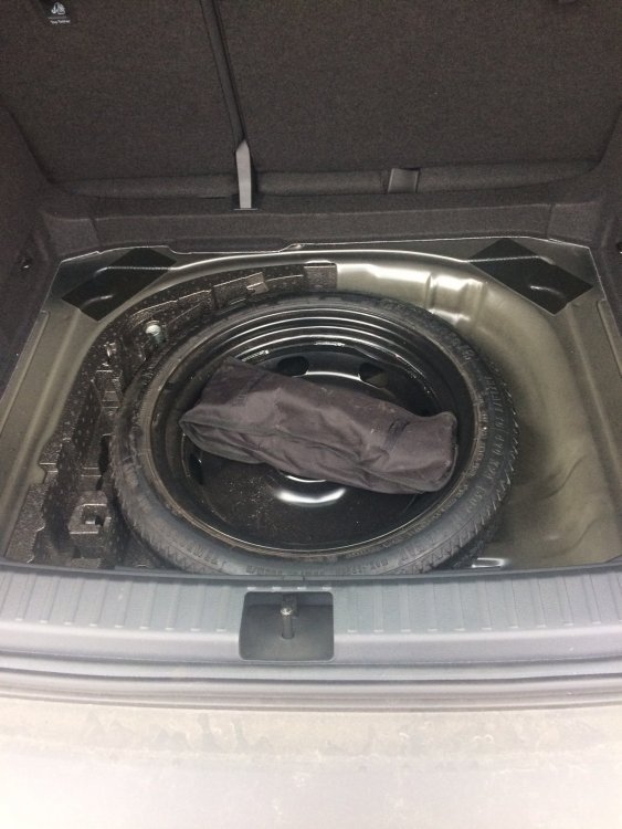

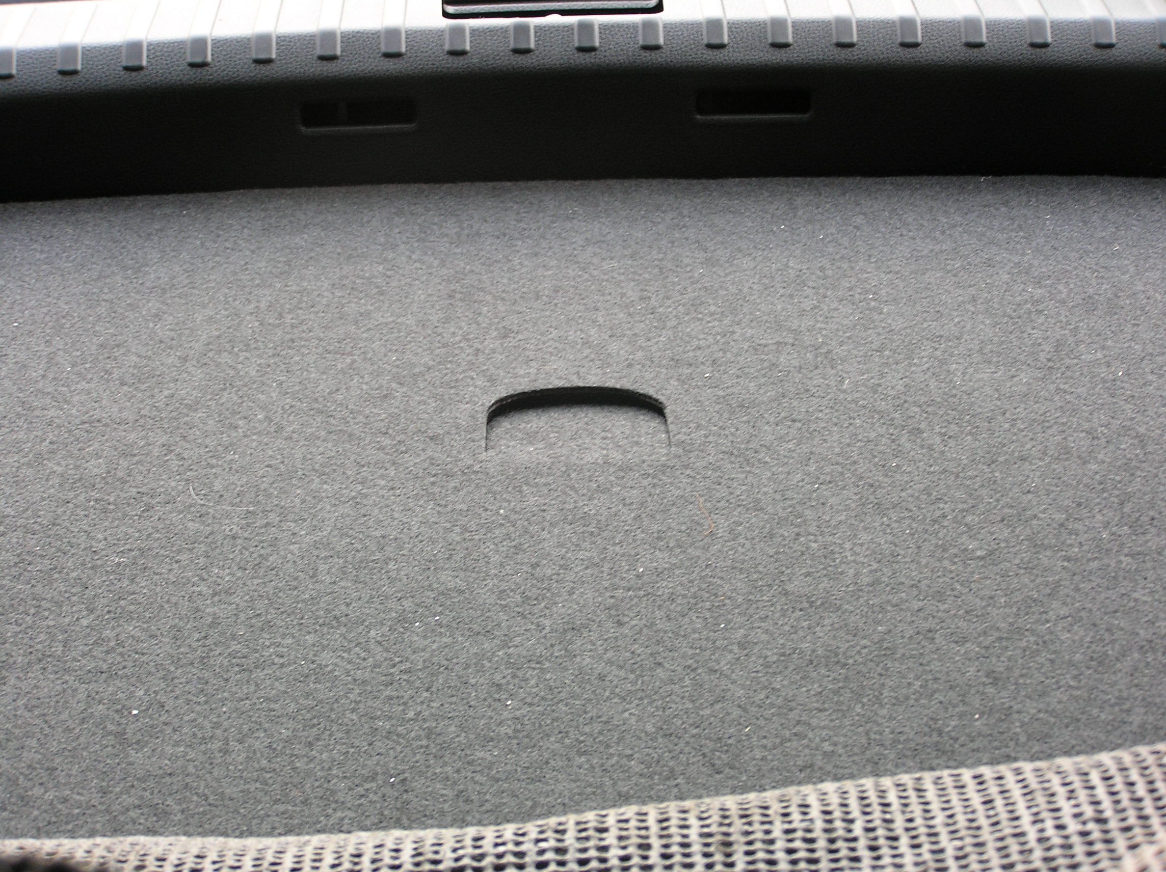

The boot floor is raised but not flat to the exact level of the boot opening there is a  lip/drop of around 2.5 inches, this was a factory fitted full size spare wheel option.

Thank you Apprentice, this is exactly what I wanted to know, great pictures.
It’s been driving me mad trying to stop my local dealer fobbing me off with the skinny space saver, which they fitted as my Karoq is second hand, nobody seems interested in looking  into it.
I know the Karoq full size spare won’t fit the 4WD or Diesel models, but it seems as is often the case, the buyer has to educate the staff.
It is definitely going back to have the correct spare I paid for, And I have your pictures to prove it.

An extra £100 for a full size alloy isn't bad...

Apprentice, If you get time, is there any chance that you could look around the polystyrene blocks to the left/right of the wheel to find any part numbers. Dealers are struggling to find the parts required on their ordering system I am trying to upgrade my SEL to full size spare, I have already bought a wheel and tyre but need the blocks to support the boot floor a the correct height.

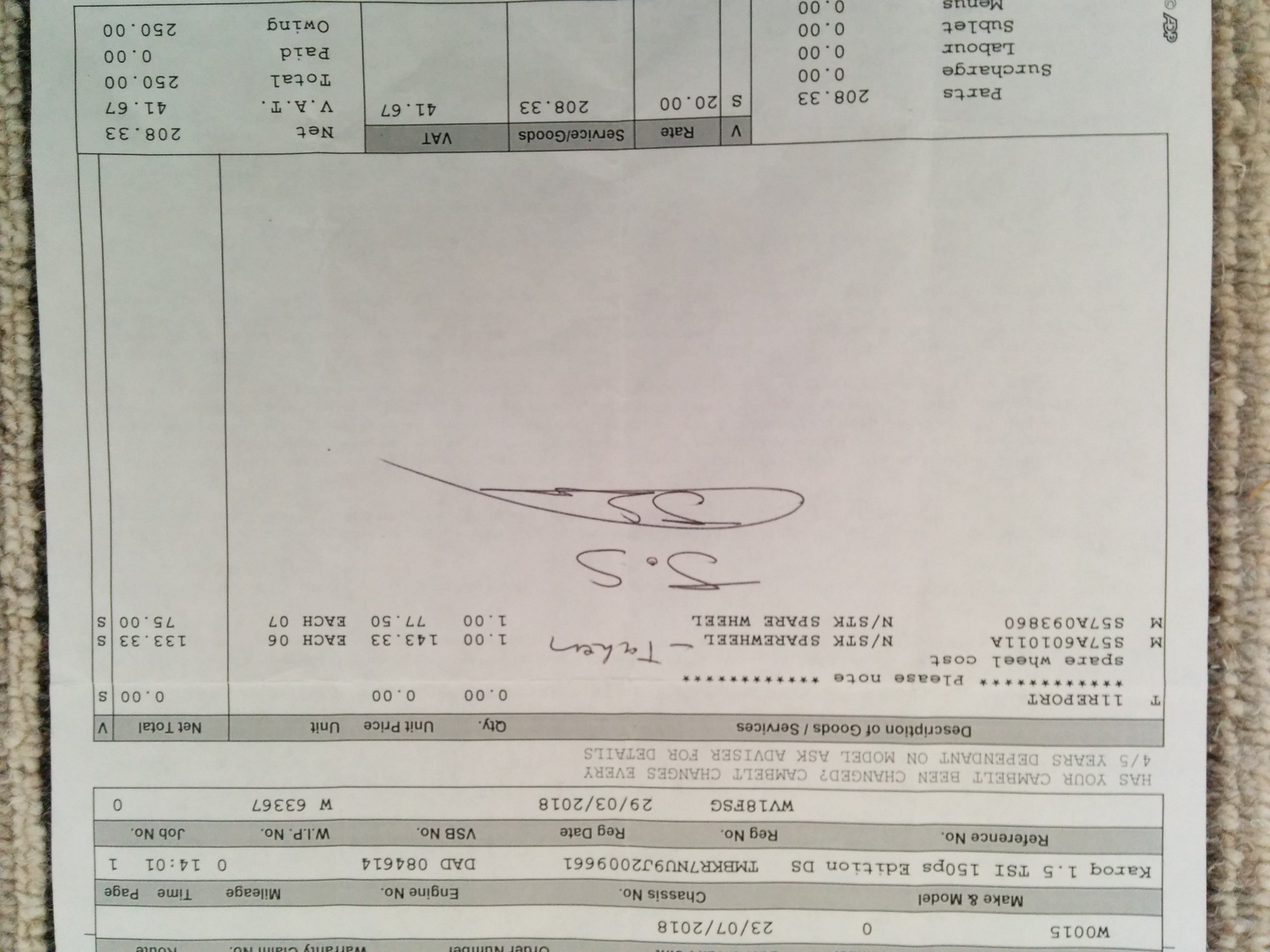

I have a 1.5 TSI edition with 19inc wheels, 2 wheel drive, I purchased separately a spare steel wheel from dealer, although it took a couple of months to get  it fits well in the space it included a foam edge with the Jack and other tools fitted into it. Cost from memory was £250.00 I know it wasn't cheep but not confident with the gunk supplied. Car was registered before purchasing so no input to the build.

Comparing the pictures of your installation with the link that you posted I'm fairly sure that my suspicions are correct which is why no-one can find them in the parts catalogues because they are using 4wd listed parts on 2wd cars.

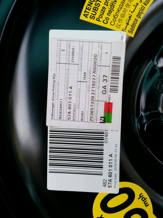

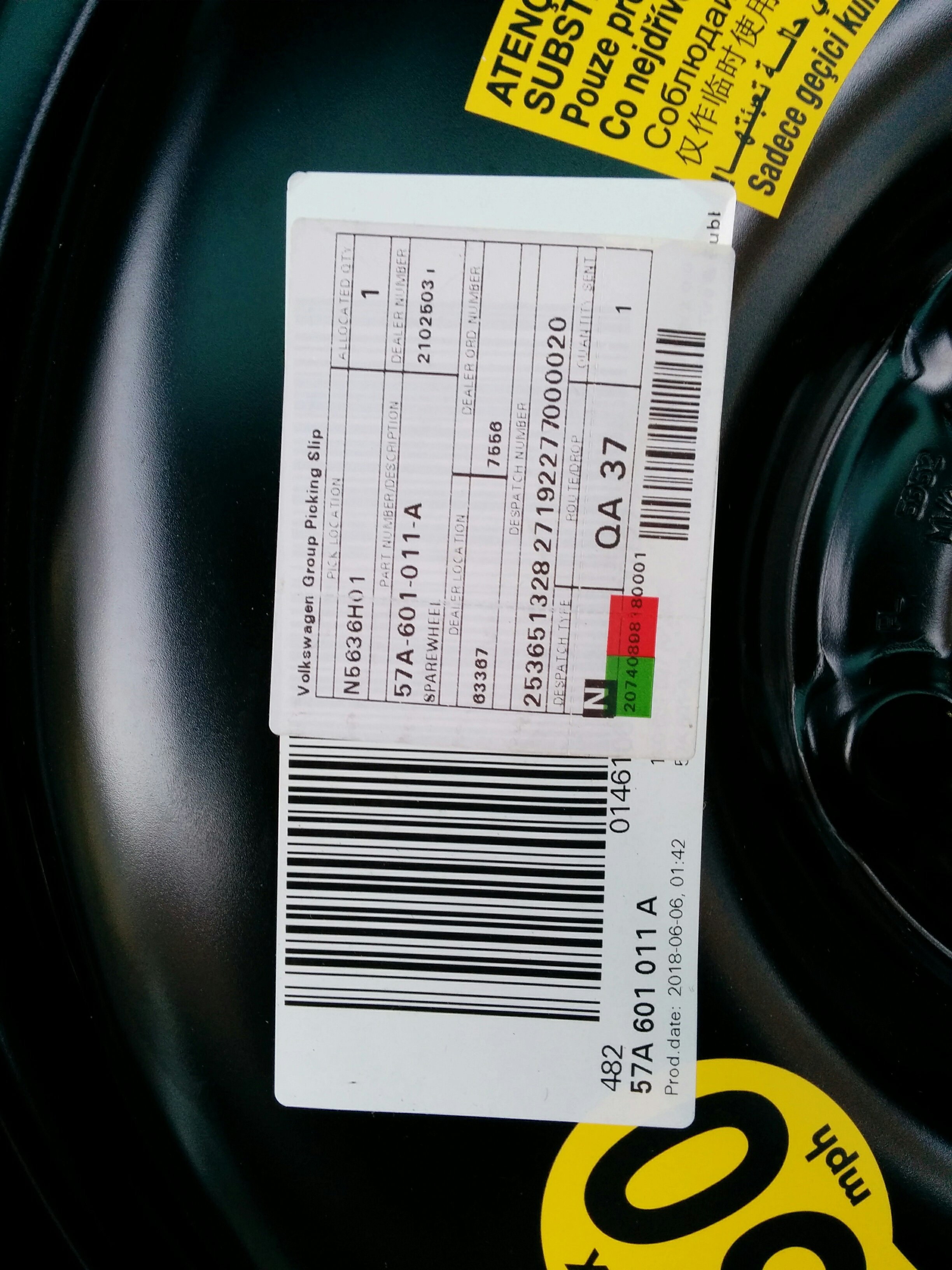

This was the sheet given showing all codes of wheel purchased. Hope it's if help

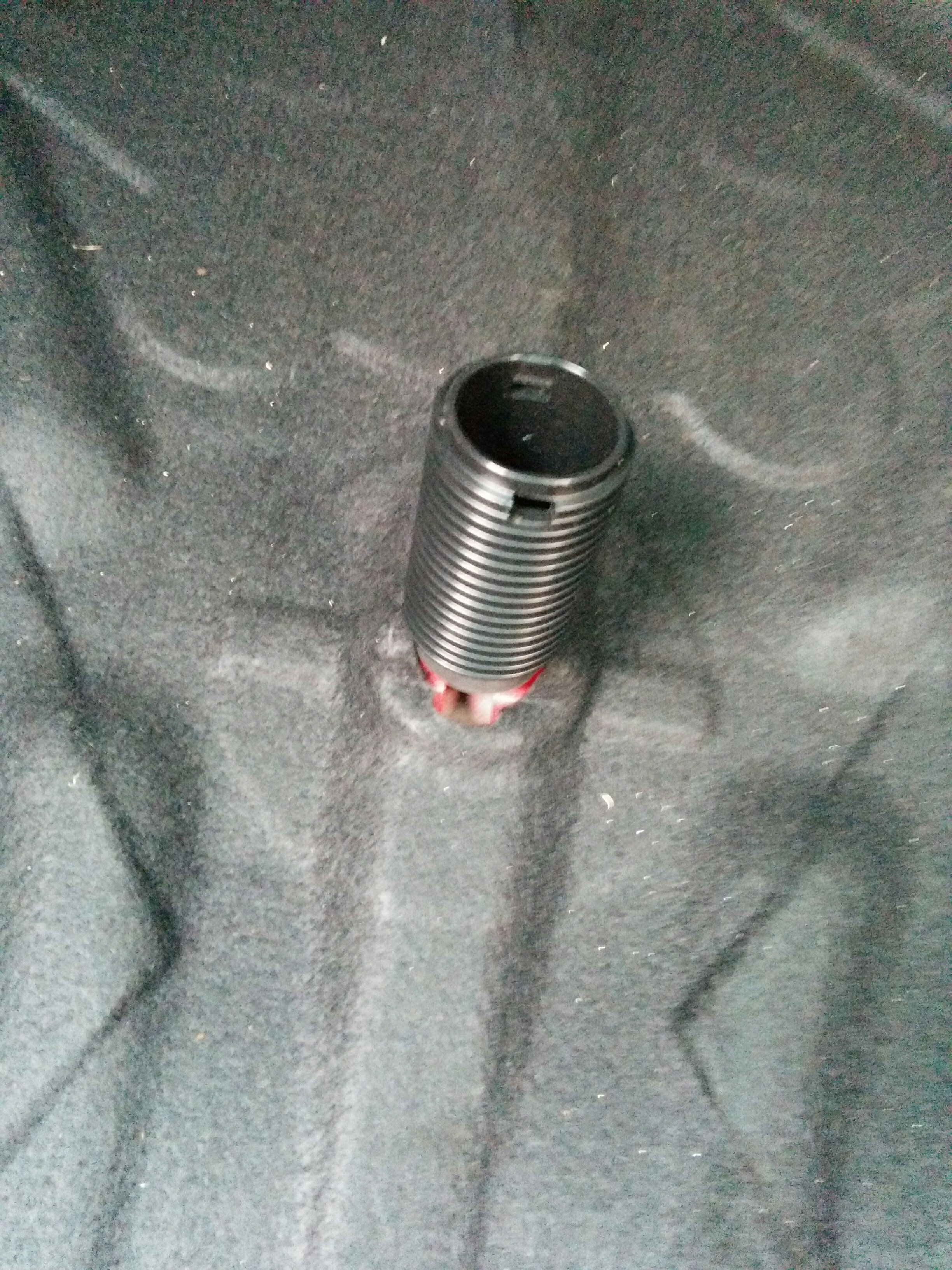

What have you got securing the wheel in the boot?
Only I have sourced a 18" VW space saver wheel and kit but the bit that fastens it all down in the boot is not the same / doesn't fit and I don't like it sitting there just loose........or it might be that I don't have the correct bit to fit to the Karoq floor?

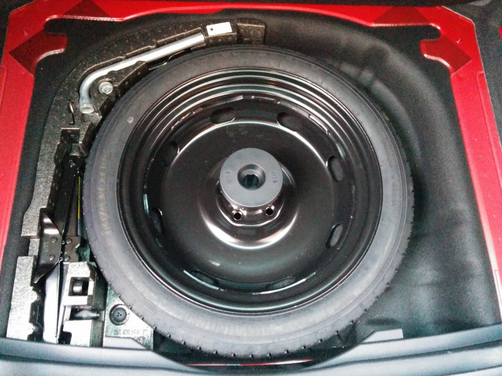

It came with the central pillar which twisted into place fits firmly with the large screw top, wife out in car will post pictures later if needed. It all came in 2 boxes 1 with the wheel and the other all the bits.

This is what I received. A space saving wheel 18 Inc so hopefully it will reach the ground as all other wheels 19 inc. it came with a spindle that twisted into a raised slotted section in the floor, wheel fitted over held down by a large threaded wheel on top of that fitted a PC to support the boot floor. Hope pictures show this
