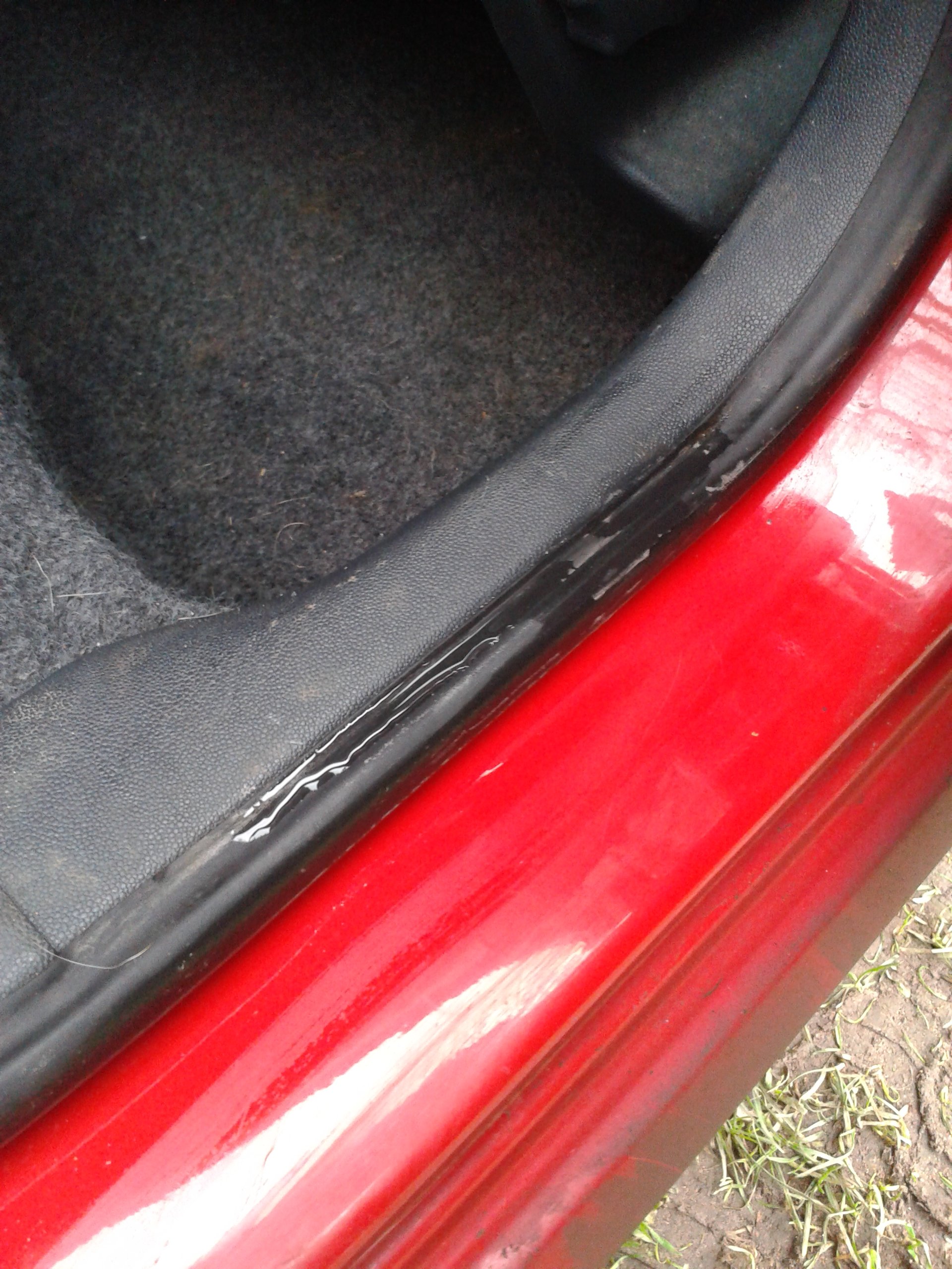

Have you checked all four doorways for puddles on the rubbers after overnight rain? See photo below.

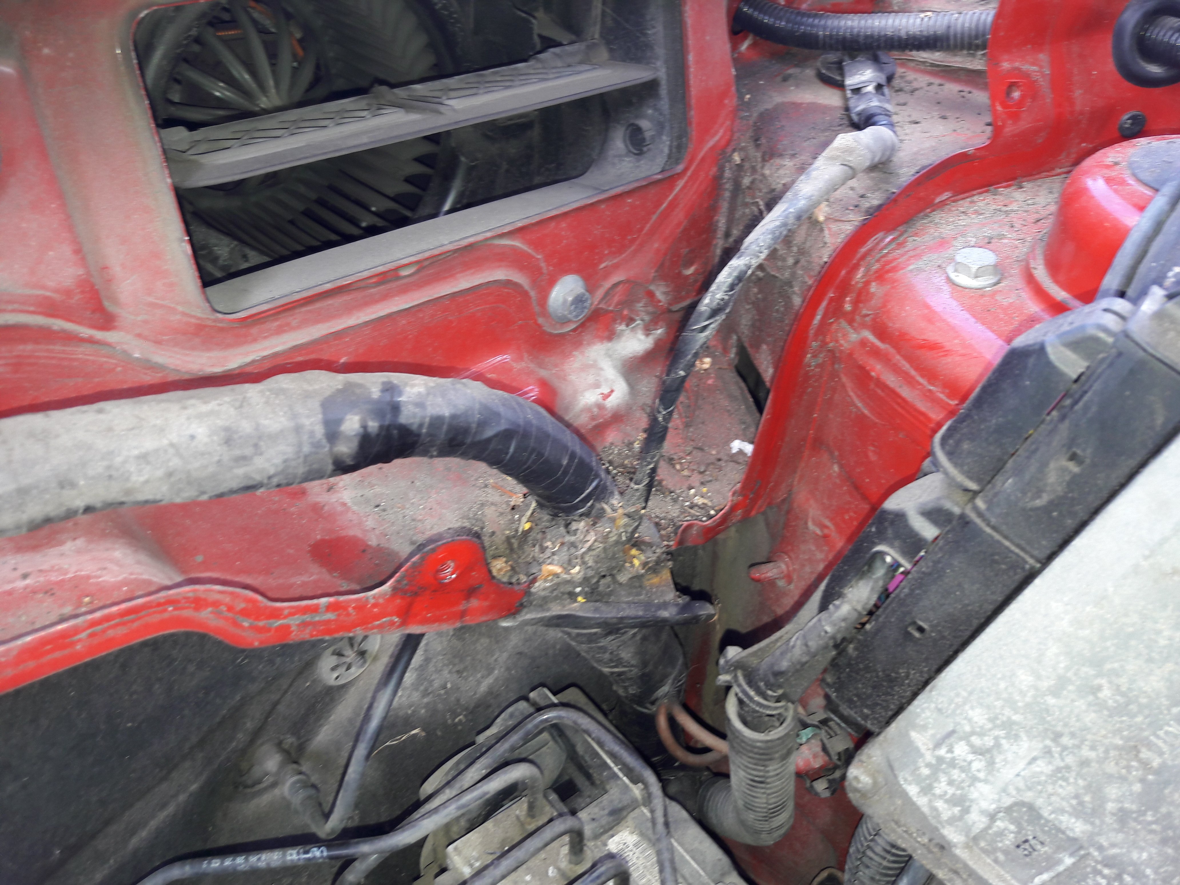

You can get to the exit points of the scuttle drains by removing the wheel arch trims, instead of wipers and all that stuff.  Then hook debris out of the slots until everything's running freely.  Probably only need to do the nearside one, as that's right under the entry point for the cabin air. See photo below, drain is the letterbox shaped opening just right of where the looms go through a big grommet.
