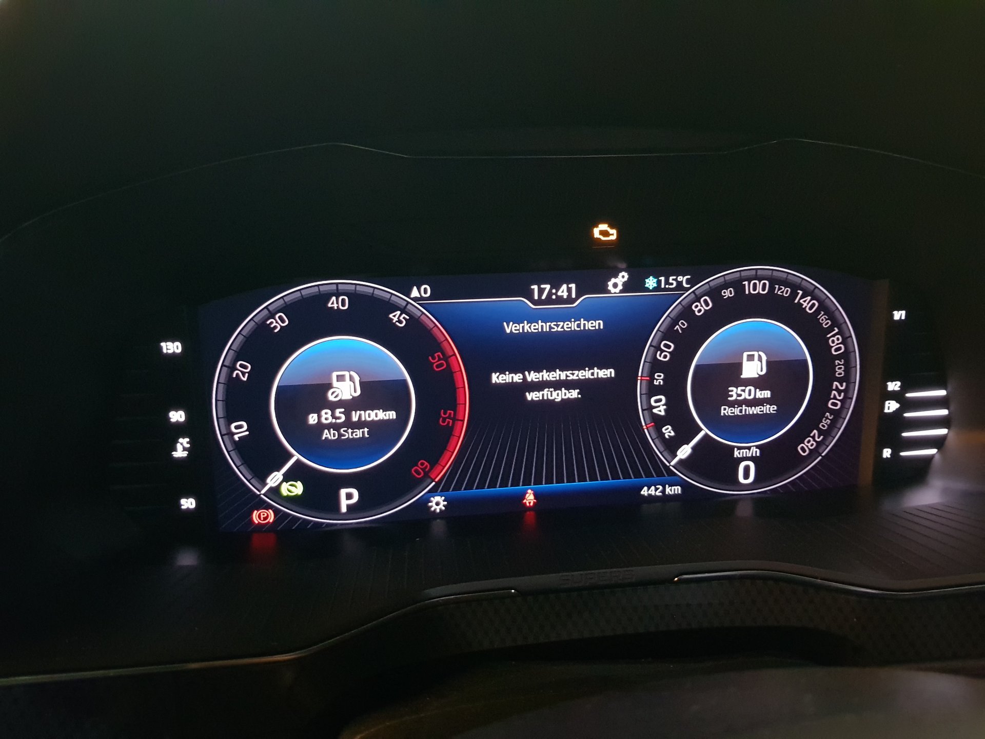

Hi @newbie69, i have a 272 S3 hatch, same as yours MY19 but l&k. I've ordered OBDeleven (still waiting to come) and just wanted to know if it is possible to change the Active Info Display like this one i found on skodacommunity using the OBDeleven. Or is this change only possible using VCDS?standard_280_fein.thumb.jpg.5e5fbabbda4dbd30c40b9417f9dc6a78.jpg
Sure, if you've got the VCDS instructions for this modification you can apply them via OBDEleven too.
What exactly do you want to change? As far as I can see this display has enabled the 280km/h max speed and (probably) the smaller speed values in between? Not sure as I'm not familar with the default display of the L&K.
You hit the spot, i want to enable the 280km/h end scale and the smaller speed values.
Default display on l&k should be the same of the sportline one, exept for the carbon look. Anyway, now it shows only bigger speed values and 260km/h max speed.
i have no VCDS instructions for this change, hope to find them somewhere. Any suggestions?
Easy then, just check this for more info: (I also did it with OBDEleven)
I think the fonts on the default L&K speed values are smaller than in the Sports skin that's why they fit one after the other, although I like this "two-level" display of the Sports skin, fills the speedo nicely.
Thank you, i'll give it a try as soon i get OBD11.
Did you have to enter pin code 23257? Somewhere i saw another code: 31347. Is there a different code for every main menu or is it the same for all?
It's different codes for different Modules but not all changes under the same module ask for it. Don't remember if this change did, I think not.
