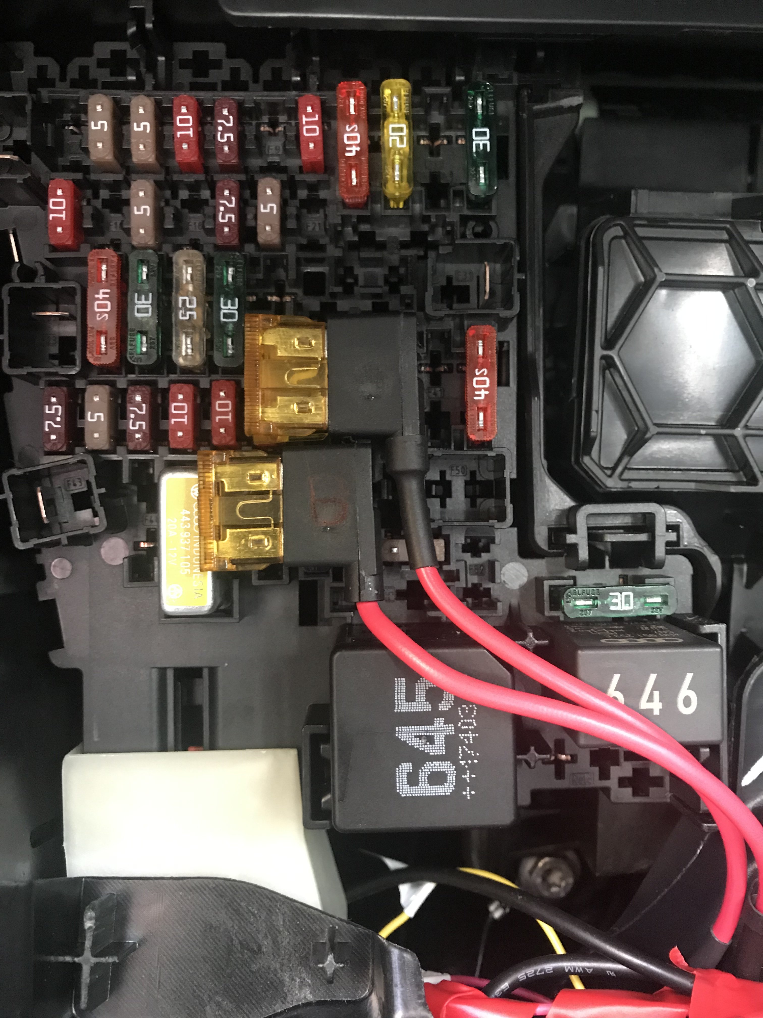

After finally having my Start/Stop fixed for 'power consumption too high' and/or 'start/Stop error' -  fixed with a software update from Skoda, I decided to re-install my cameras by piggy backing off the fuse box and now my 'power consumption is too high' issue is back. I disconnect the cameras from the fuse box but the issue remains.
So I have to assume that piggy backing off the fuses is upsetting the system some how as after I bought the car I did the same thing with cameras. Originally the start/Stop worked intermittently so I didn't think it was the cameras and Skoda had to fiddle with the system twice with no cameras and it was working flawlessly for the last two weeks until today.
I'm back to connecting and disconnecting my cameras manually off the 12V socket like a chump!

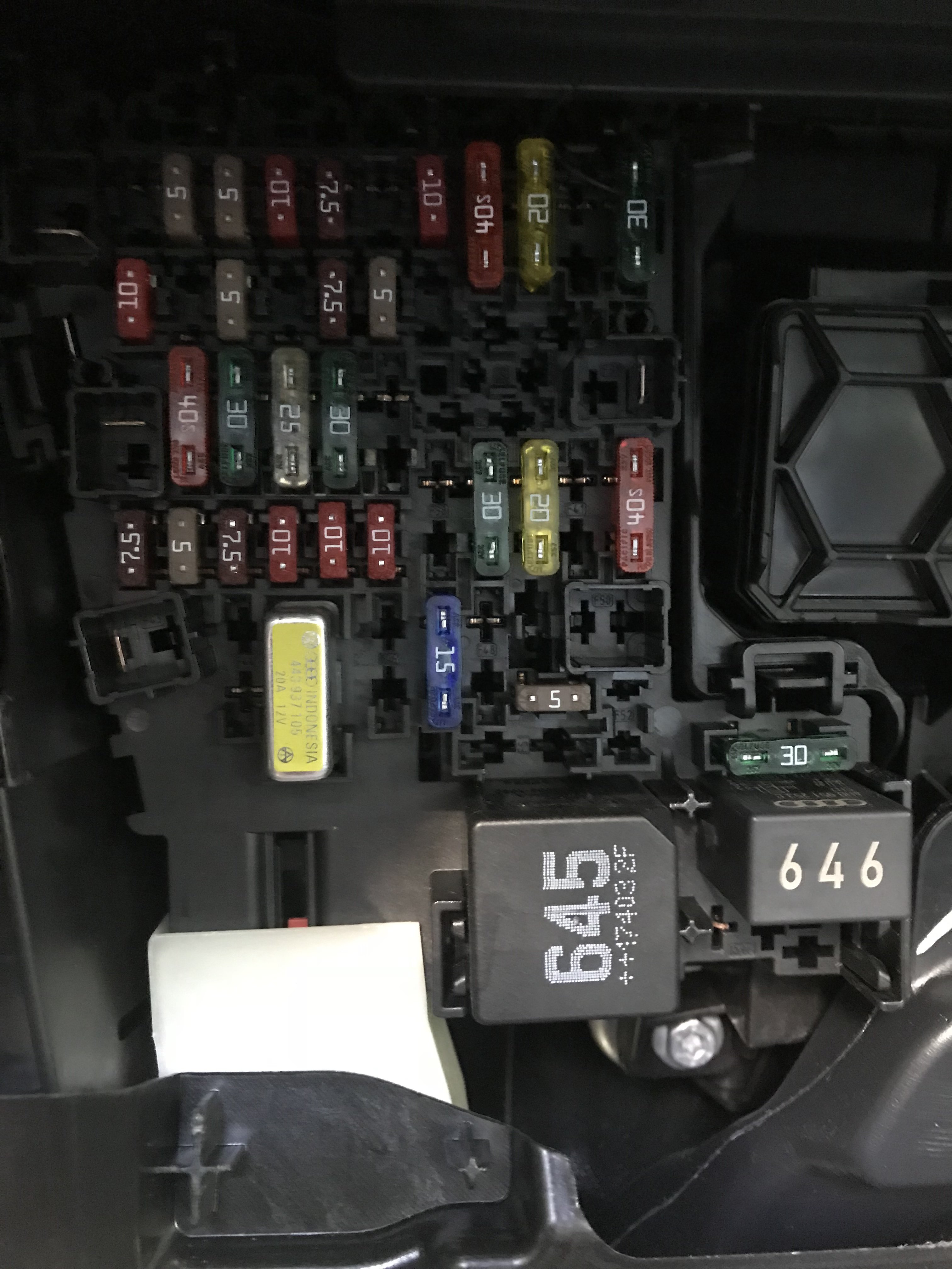

I piggy backed off slot 40 '12-Volt outlet' for constant power - this has a 20amp fuse in it, and slot 48 'Assist blind spot monitoring' for ignition - this had no fuse. I have a Vico Power Plus unit (monitors power consumption so cameras can record even when car is off and locked and will switch off if battery gets too low) hooked in which has a 12volt socket which my cameras plug into. I had the bypass on the Vico power so the cameras switched off with the car rather than continue recording.
This all worked on my MK2 Octavia so I don't know what's changed?
Q - is the system that sensative that plugging into the fuse box would cause this issue?
Q - why does the car think power consumption is still too high with entire camera rig disconnected?
Q - anyone else have problems piggy backing off fuses for their cameras?
Q - can i disconnect car battery to force the car to re-adjust itself?
Q - does the car run a cycle where it checks all systems? How often does it do this?

The thing that's thrown is it was working perfectly running the car cameras off the 12v cigarette lighter socket. As soon as I piggy backed of fuses it's gone to **** again. I followed the guide on this forum for install and had no issues on my MK2. Cameras work fine and everything installed correctly.
What I don't understand is why if the cameras  are not connected does the car battery module not see the load is normal again?

Which number fuse slot did you go off? The cigarette lighter socket is always live if its the 12v slot, which is what I used for constant power as it's powered when car is off and locked.
I switched off/bypassed constant power on the monitor box as I was worried this is what caused my original high power consumption.
I followed this video https://www.youtube.com/watch?v=bUIHTMkl7M0 , which if I remember correctly, is someone on the forum.
It's an accessory fuse, so goes off about 30 seconds after the ignition.
I notice they installed with piggyback wire facing up when I've always read the golden rule is for it to face down (in VAG cars at least), with incoming 12V on top of fusebox, and output voltage fed from fuse back to the bottom pin on the fusebox. Couldn't tell you why though.
