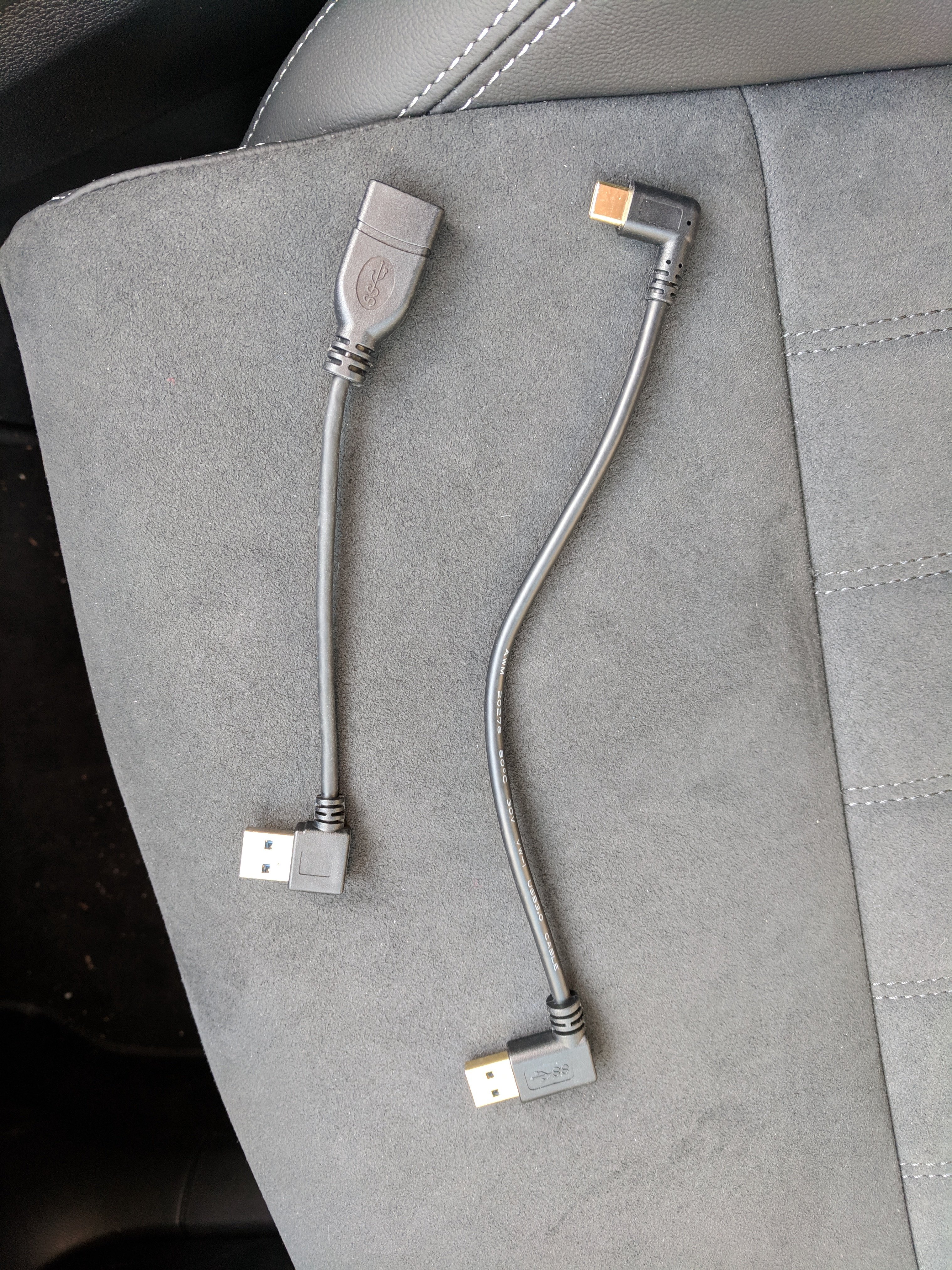

Had issues with a few cables disconnecting. Currently using this from Amazon. Which works fine.
It is USB C one end and my Google pixel XL fits in with the cover closed.
90 Degree USB 2.0 to Type C Right/Left Angled Male Cable Gold Plated USB C Extension Cord Data Transfer Sync lead (90°Type C-USB 3.0 A Right) https://www.amazon.co.uk/dp/B07HVWYXJ1/ref=cm_sw_r_cp_apa_i_UDsOCbKBBFTT3

Remember the one I linked was for a USB c as the input to the phone.
I also bought this one which also work and can used different connections depending on your phone.
Short USB 3.0 Extension Cable, 90... https://www.amazon.co.uk/dp/B07BPLYB26?ref=ppx_pop_mob_ap_share
