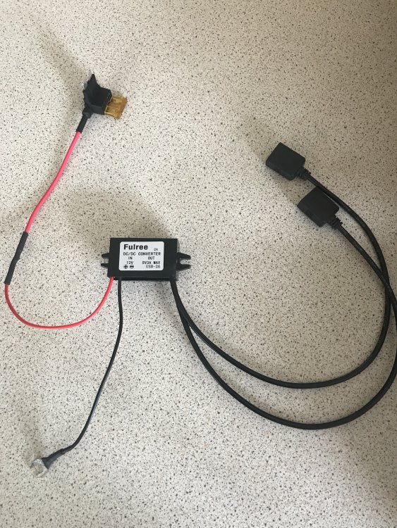

Before attempting to hardwire dashcam into my car again (and hopefully not upsetting my start/Stop system) I had a few questions for the technical people out there please.
I have purchased a 12V to 5V adaptor with dual usb connectors and soldered on a full size fuse piggyback connector.

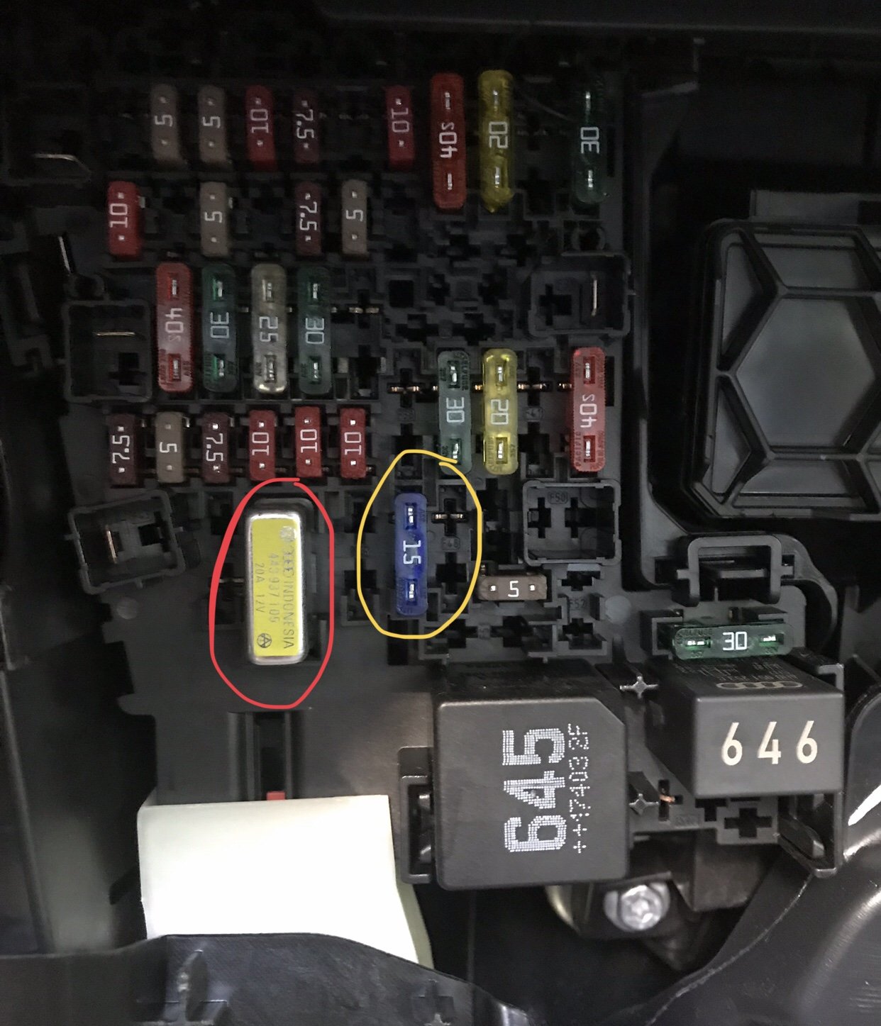

I was planning this time on piggybacking off fuse 47 'rear window wiper' (circled yellow) but the piggyback fuse holder won't fit back in lead down and fuses to the left as it's catching on the large silver fuse 45 (circled red).
Q - I've read many times that the lead from the piggyback holder should always be running down on VAG cars. Does anyone know why? And would be be OK in this instance for the lead to run up with fuses facing right?
Q - am I right the original fuse should go in slot one of the piggyback holder and the new fuse for cameras goes in the second, back slot?
Q - I did originally trying running my older setup through a Vico power plus power monitor through fuse 48 'Assist system for blind spot monitoring'  as this is live but has no fuse in it. My car started having start/Stop system 'power consumption too high' issue so I'm guessing as my car does not have blind spot monitoring the car could see a load on this fuse that shouldn't be there. This a fair guess?
It's possible my Vico unit had developed an issue since I used it on my MK2, but having had start/Stop issues before I didn't want to risk it so have ditched the unit altogether. This is the reason I'm not risking running my new setup off fuse 48 although there is space there for piggyback fuse holder.

I can't go off fuse 40 '12-volt outlet' as this is powered at all times so my cameras will keep running even when car locked. With all other fuses being used for what I'd call critical monitored systems I'm kind of stuck using fuse 47 'rear window wiper' but only if I can have the piggyback holder lead running up. I've not tested this method as I have no spare 15amp fuse if it blows and I also don't know why I've read that you shouldn't run the wire up?

It involves moving the 12V socket fuse down half a position (so the top part of the fuse goes into where the bottom part came out of and the bottom part of the fuse goes into the socket below... this makes it a switched live)
The trouble is your fuse No. 40 pictured above has no terminal in the slot below (the same as the Superb)
What about using fuse 14 - Air blower for air conditioning,heating

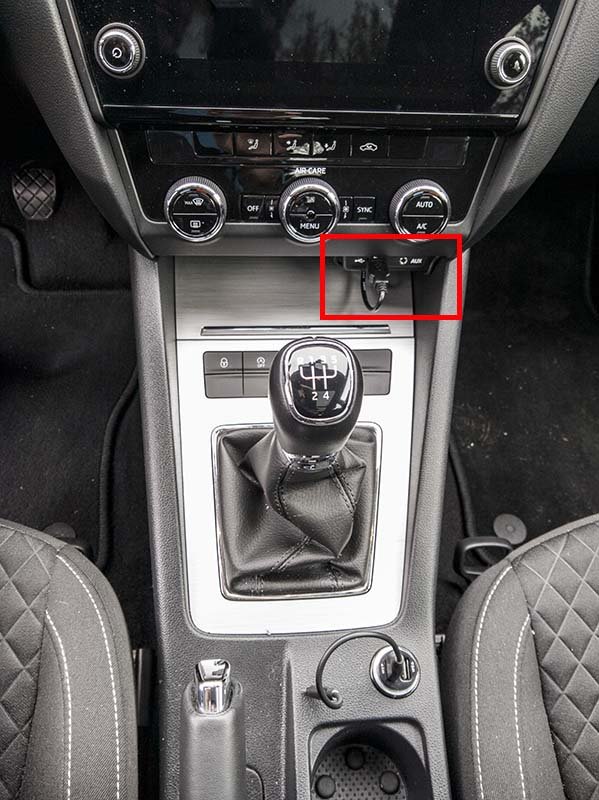

As my car is still under warranty, I didn't want to pull off trim or mess with fuses so I just fed power to my dashcam from the USB socket in front of the gear lever. This socket is powered only when the ignition is turned on (and it stays powered until about 1 minute after the ignition is turned off and the car is locked). As my phone is connected to the system by Bluetooth, (and charged from the 12v socket by the handbrake) this option works well for me. My car is one year old, bought and registered in France.

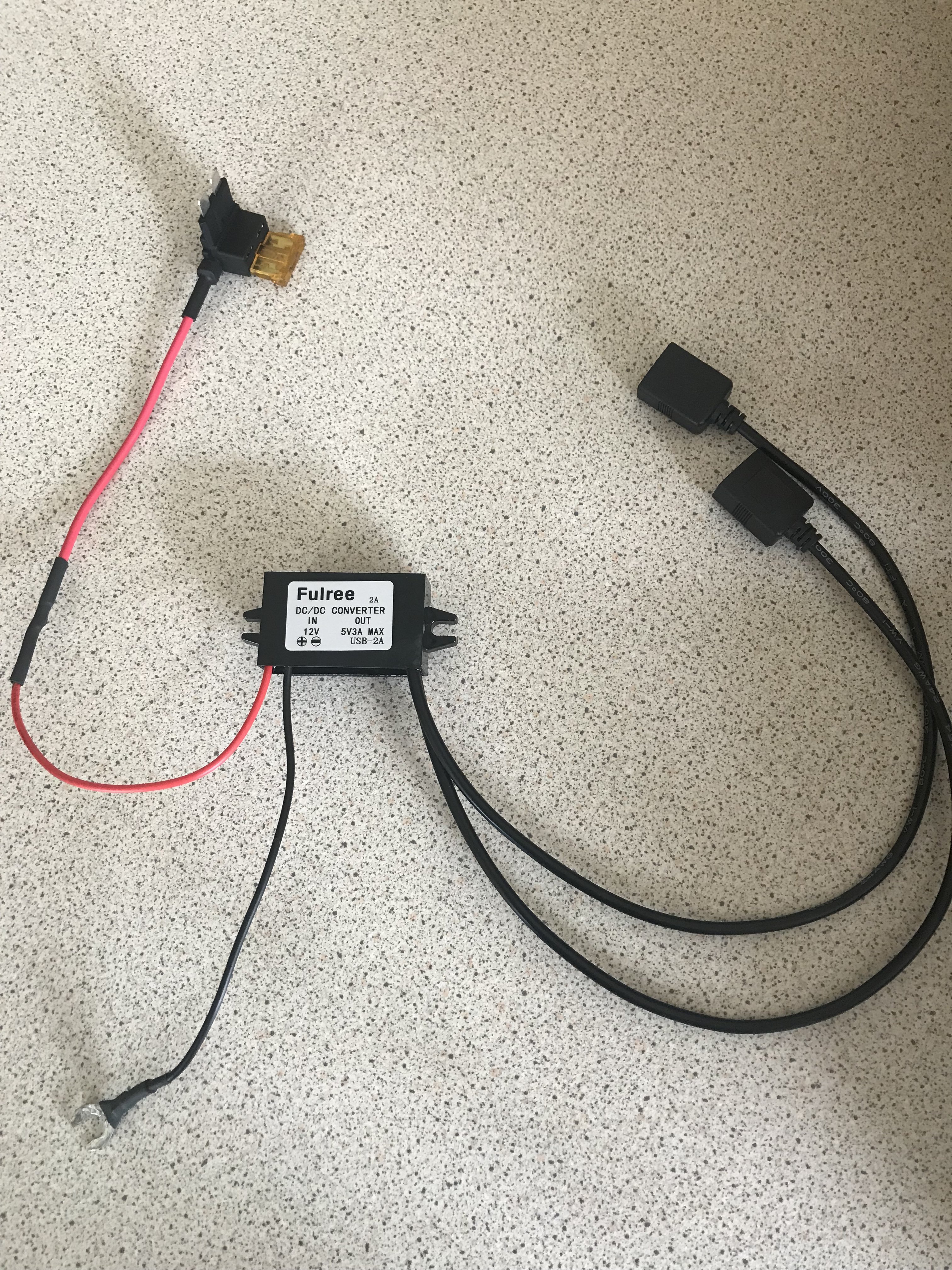

this configuration of pigtails allows me to convert the 12V plug to switched have power to the power magic pro for the Blackvue dashcam.

Thanks for sharing. That's a fair solution but I have two USB plugs as I have front and rear cameras and really want to hide the wires.
Thanks for sharing. For me the solution I need is to connect only one piggy back holder to minimise any drain on the system and avoid any start/Stop system issues.

Thanks, this could be a solution although would it be a heavy load on this one socket if fans are running high and the two cameras are on?
depends on your camera, but usually they don't draw much.
DDPAI 2 mini i have uses roughly 0,2A
Saw a number on a Street guardian type used even less 0,07A
So not an issue
