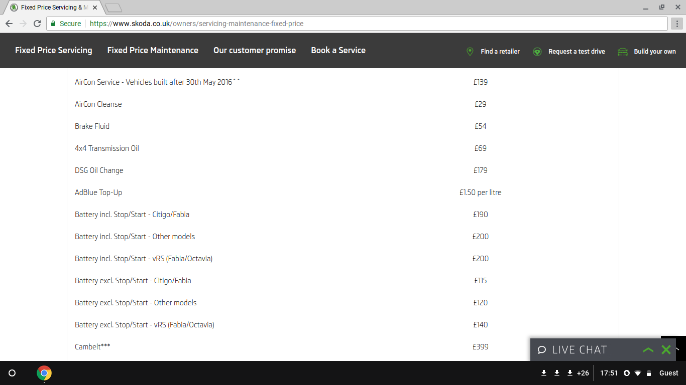

@daveb99
Skoda UK have a Fixed Price for 3-10 year old cars on fixed services. & that is £69 for Haldex & £179 at participating dealers.
A DSG serviced for £125 is good.
I hope they actually did it.
How much was the Haldex Service?

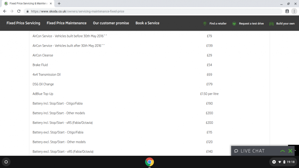

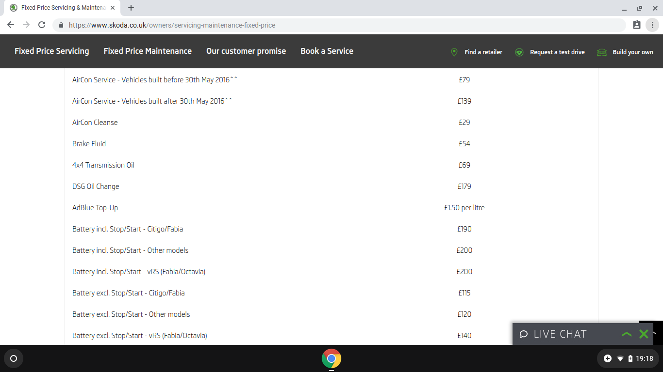

£179 & Participating Main Dealers under the Skoda UK fixed servicing prices.
