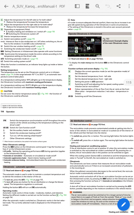

Check the aircon operating mode in the infotainment, it can be set to various levels,
Operating modes Automatic mode works in three modes - moderate, medium, and intensive. Setting the different modes is carried out via the function surface on page 114. D» Fig. 150
@Berisford

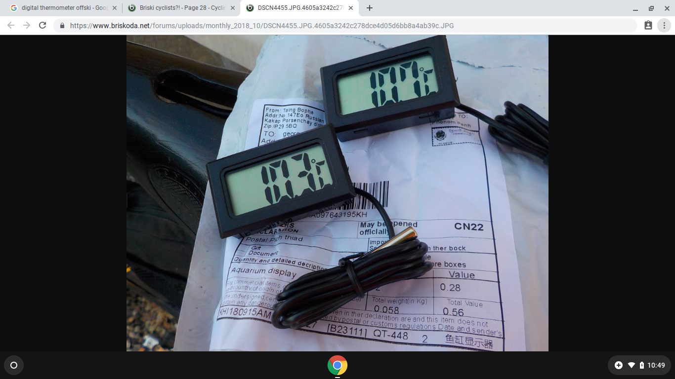

63 pence each all the way from China.  So handy.
Yes, I have similar - after digging around on the interweb last night it seems the face vents may not be the best place to check output temperatures as there is a (unconfirmed) theory that the air from those vents may not be as cold as they could be, insamuch as, they are purposely run less cold so as not to chill the hands / arms too much.
More testing to be done me thinks........
