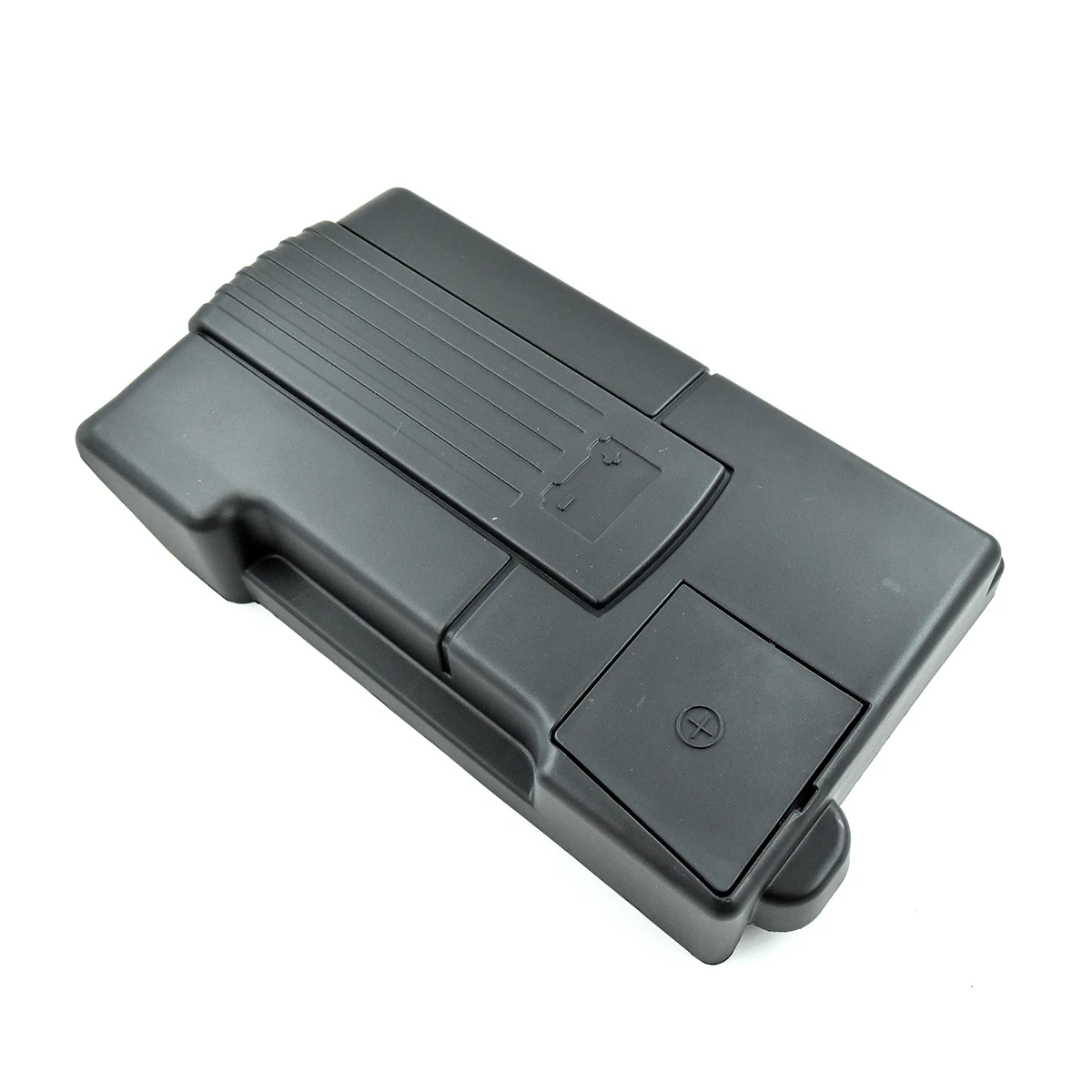

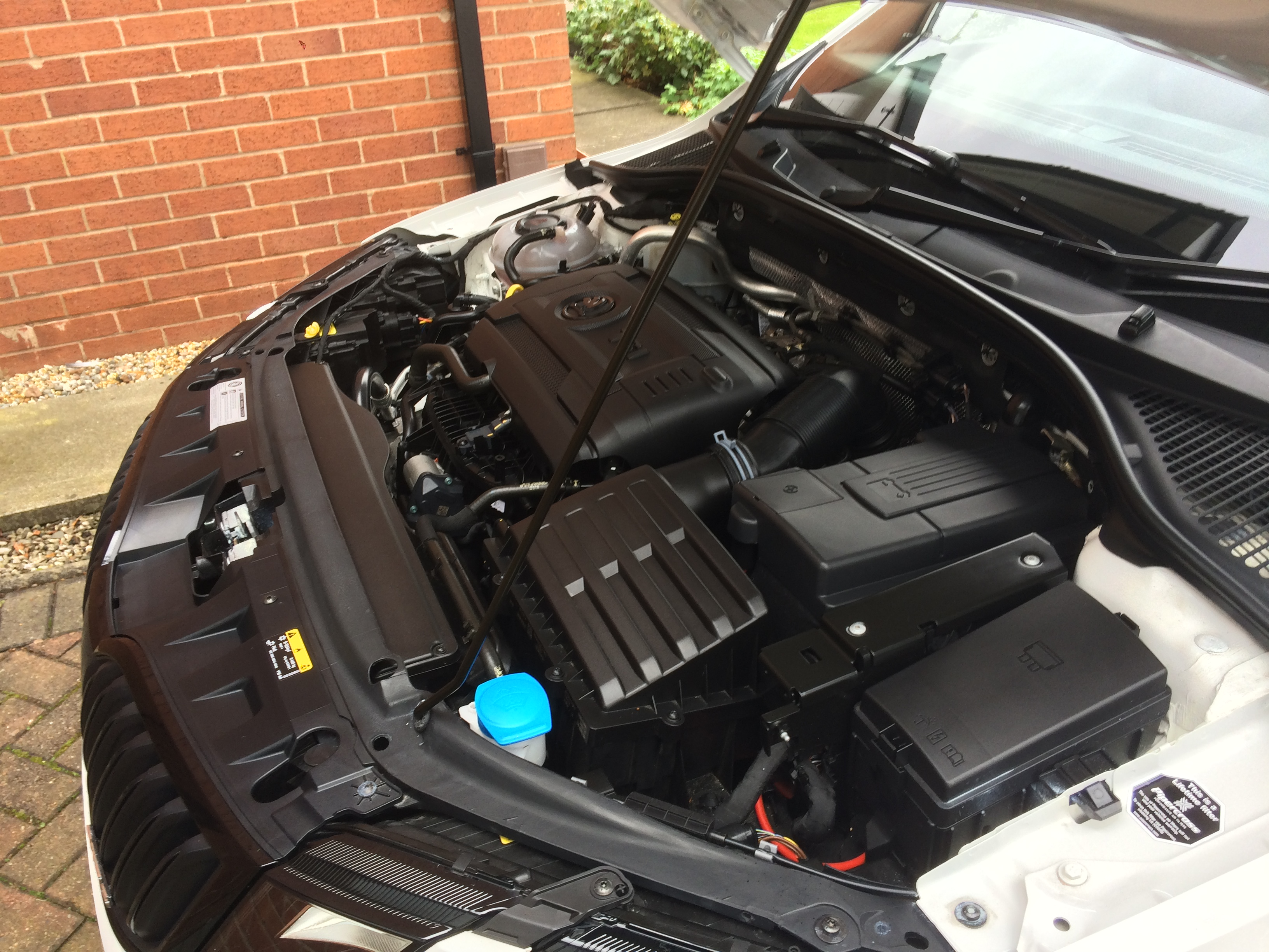

Fitted the AliExpress battery cover today, it's a perfect fit and looks totally OEM.

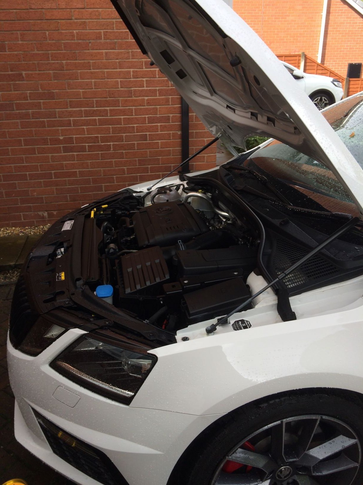

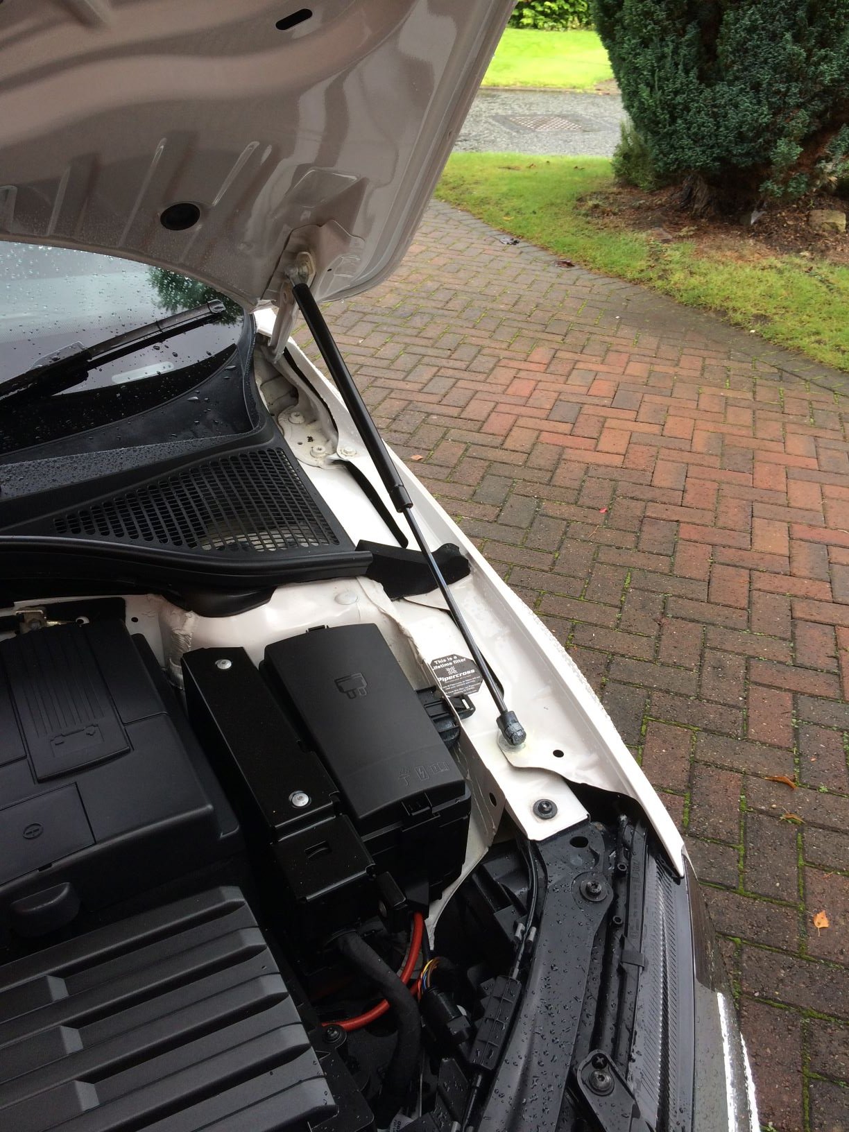

Bonnet Struts.
Got them from aliexpress $18 less a $3 discount as a new customer, so ridiculously cheap. They arrived today and look excellent quality.
I watched a couple of videos on fitting just by googling Octavia bonnet struts then set about it.
You will need a 10mm spanner to remove existing front wing/headlight bolts.
A Torx T50 to unfasten the bonnet hinge bolts. One of mine was pretty tight - I'm not sure a mole wrench would have shifted it.
Some grease - I used spray white lithium grease from Toolstation.
I also added a couple of steel washers (2 supplied) and rubber washers behind all 4 where they bolt in.
Job took about 30 minutes - which is handy today as I managed it between showers. Now I have that satisfying noise when I lift the bonnet and no messing about with a prop.
Overall satisfaction 10/10.

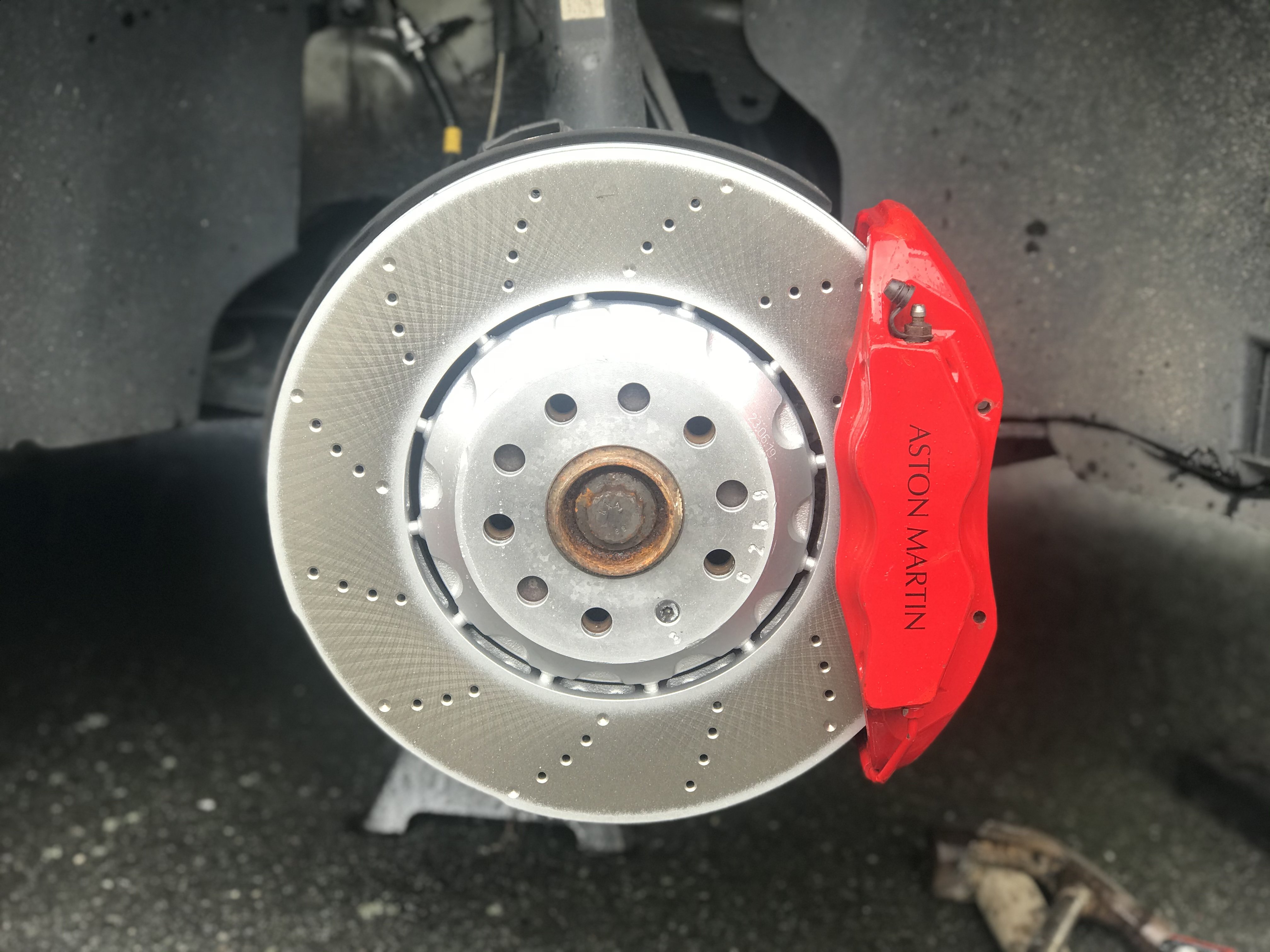

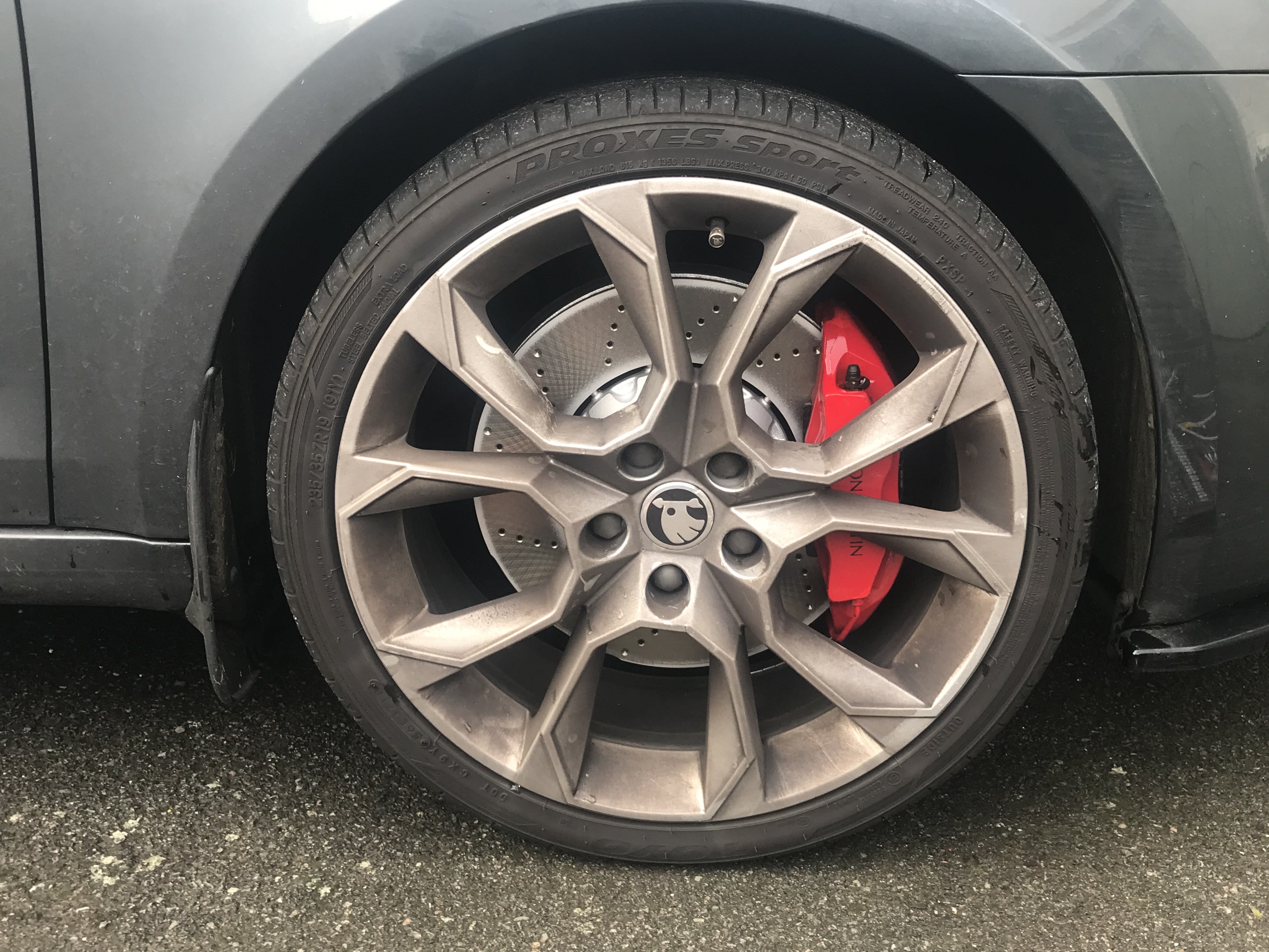

You could have cleaned your Extremes before taking the photo, brakes looking good. Might buy a set of genuine Silver 19" Extremes next spring having seen how good yours look back in July at Donington.:thumbup:
Next weeks job, it’s hammering with rain now. Want to re coat everything with ceramic before it gets too cold. Inside one of the wheels is badly damaged from evasive pot hole hitting. Bloody farmers!!
Do you have a link to the cover you bought, a search throws up too many
Ha841e70a05d24cae956b35b61d45e8a55.jpg?width=1200&height=1200&hash=2400That's the one.

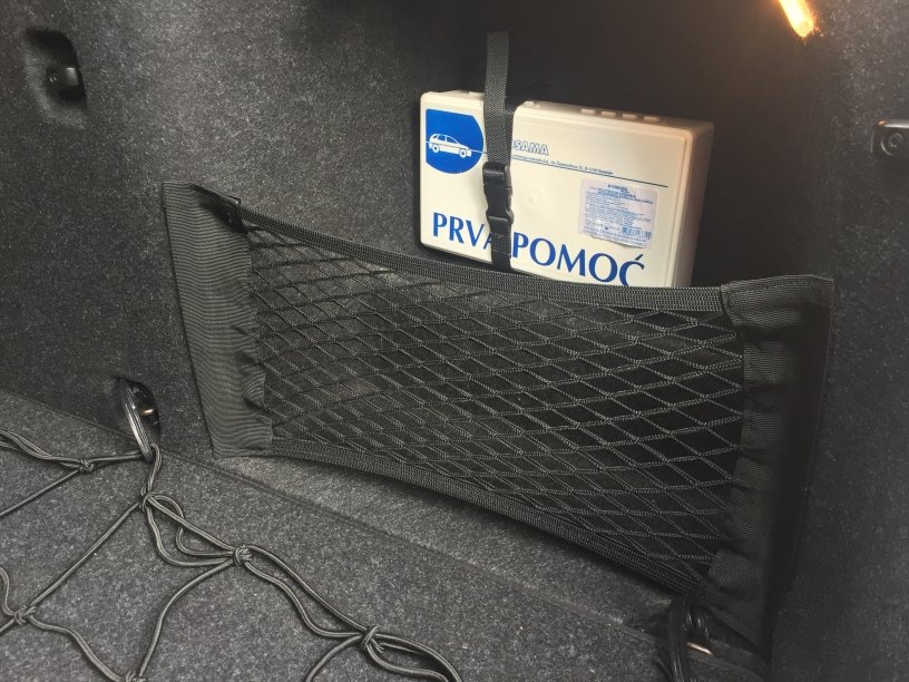

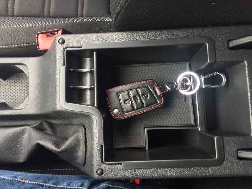

  • Small elastic net for the side of the trunk.

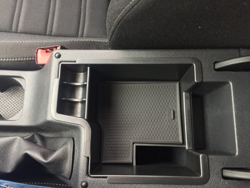

  • Little rubber padded shallow shelf for the storage box. Looks like it was designed for the pre-FL Octavia III, but i don't mind the little hole.
  • Leather key cover.

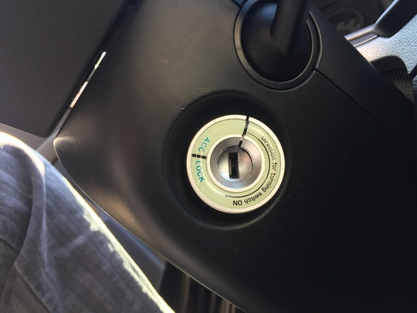

  • Little glow-in-the-dark cover for the ignition switch. Should have went for a black one instead of sliver 😐
Nice. Where did you get the rubber padded shelf? I would like one!

Hi, how long did they take to be delivered, site says 20 to 40 days?
Ordered Sept 12th delivered today 28th so 16 days. Not too bad, not something you can claim to need urgently really. Although I was getting a bit impatient and checking the China Post tracking 😁

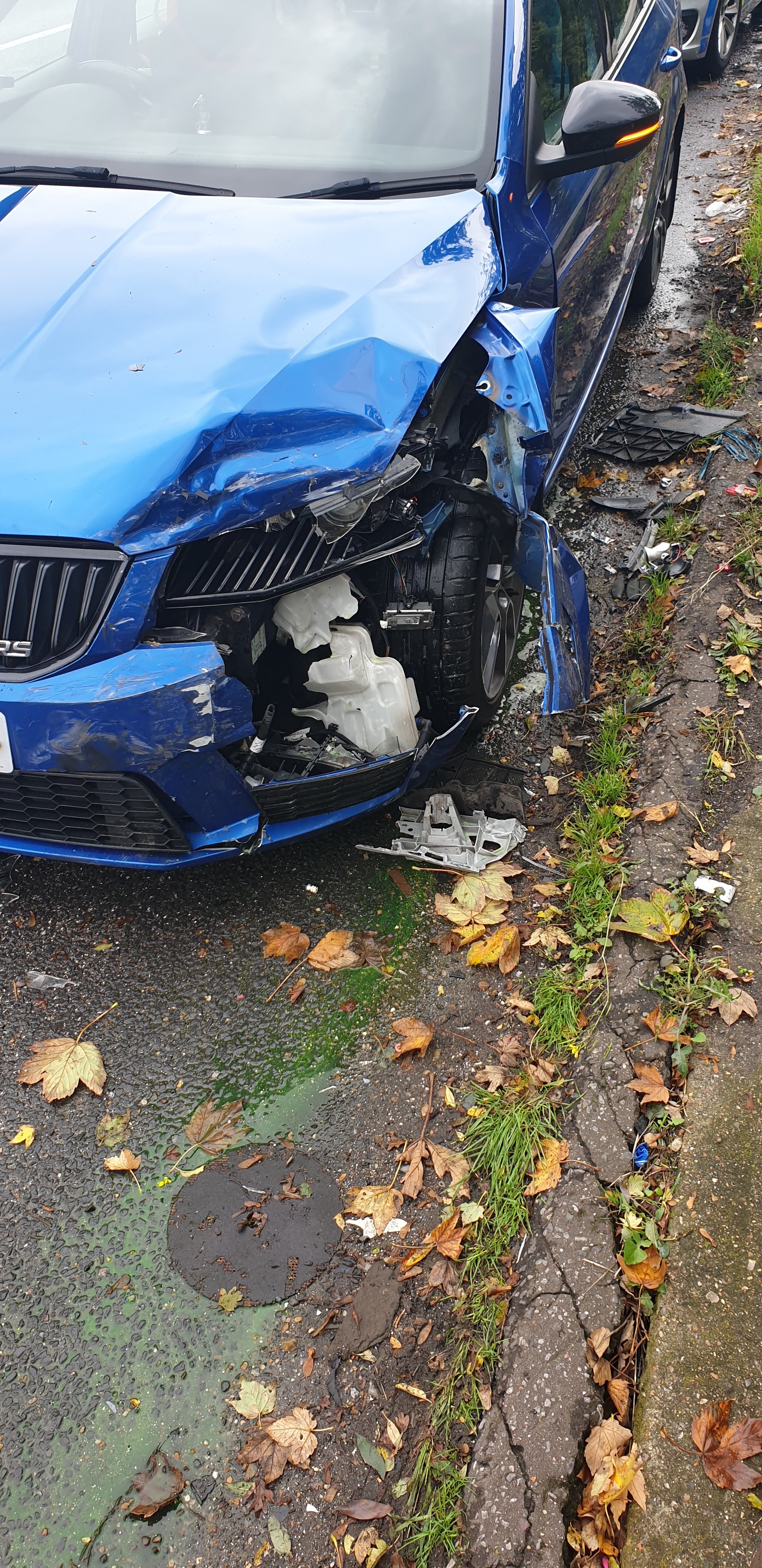

Hit a parked car while avoiding a recovery vehicle that swerved across 2 lanes of traffic.
Thankfully have it all on dashcam and nobody hurt.
What made me laugh was when i moved her after the accident the last warning message was
Top up washer fluid.
Now just hoping chassis is still in alignment
Oh and if you don't have a dashcam. Get one. Too many awful drivers out there who will just drive off.
