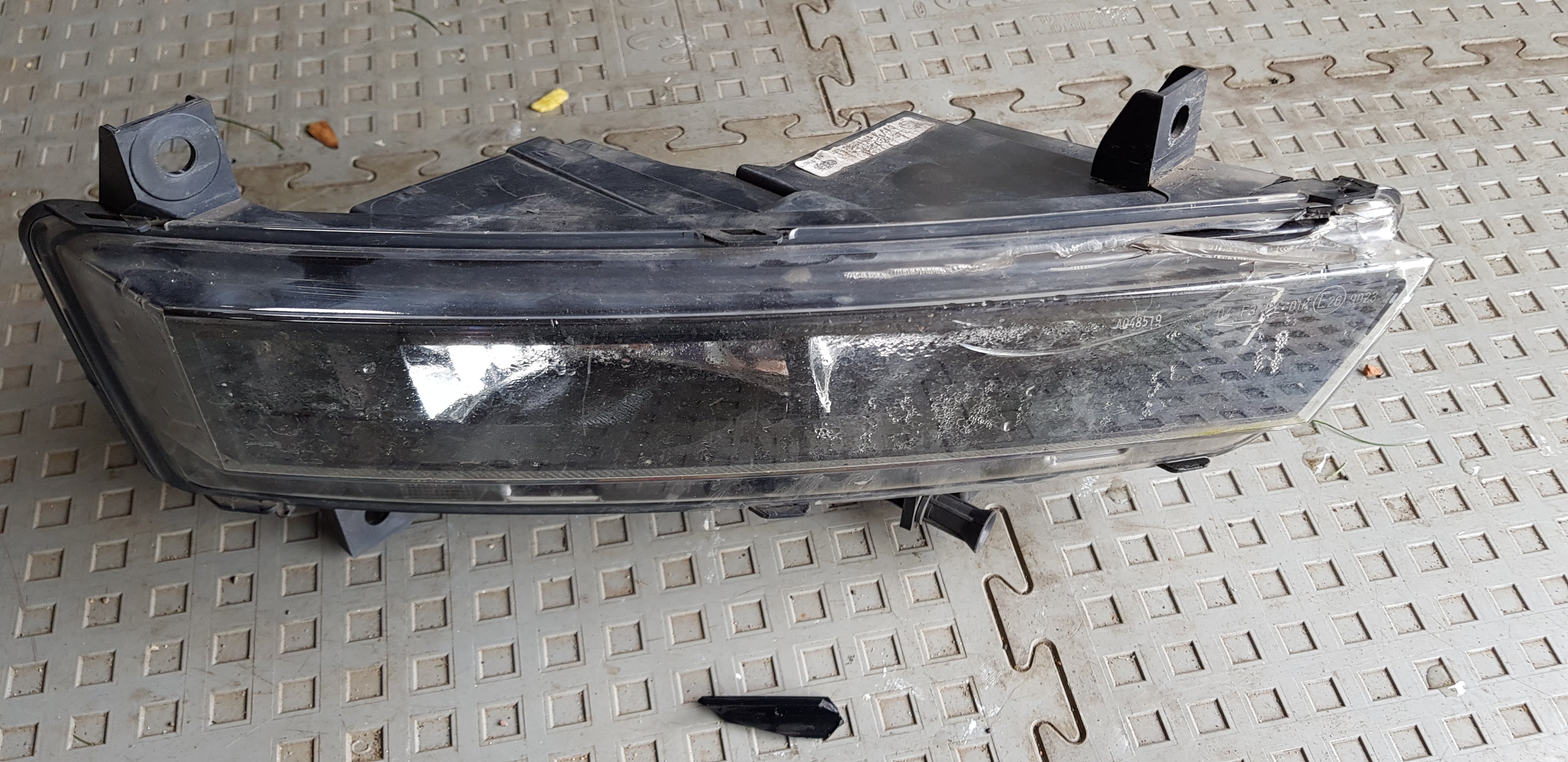

I have a cracked fog light lens and have brought a new light unit from Skoda £78.
I have used the search but left a little confussed. Is it possible to change the unit without removing the bumper?

to be honest the bumper is not too hard and the effort in removing it would make the job so much easier. I wouldnt attempt a full unit change without removal, it is tricky to switch the bulbs without removal as it is.

i think you could get away with just taking out the arch liners

As suggested by @JohnnyType2 it was possible to change the fog light unit with the wheel off and arch liner out.
A nice £125 save over the price quoted by Skoda.
