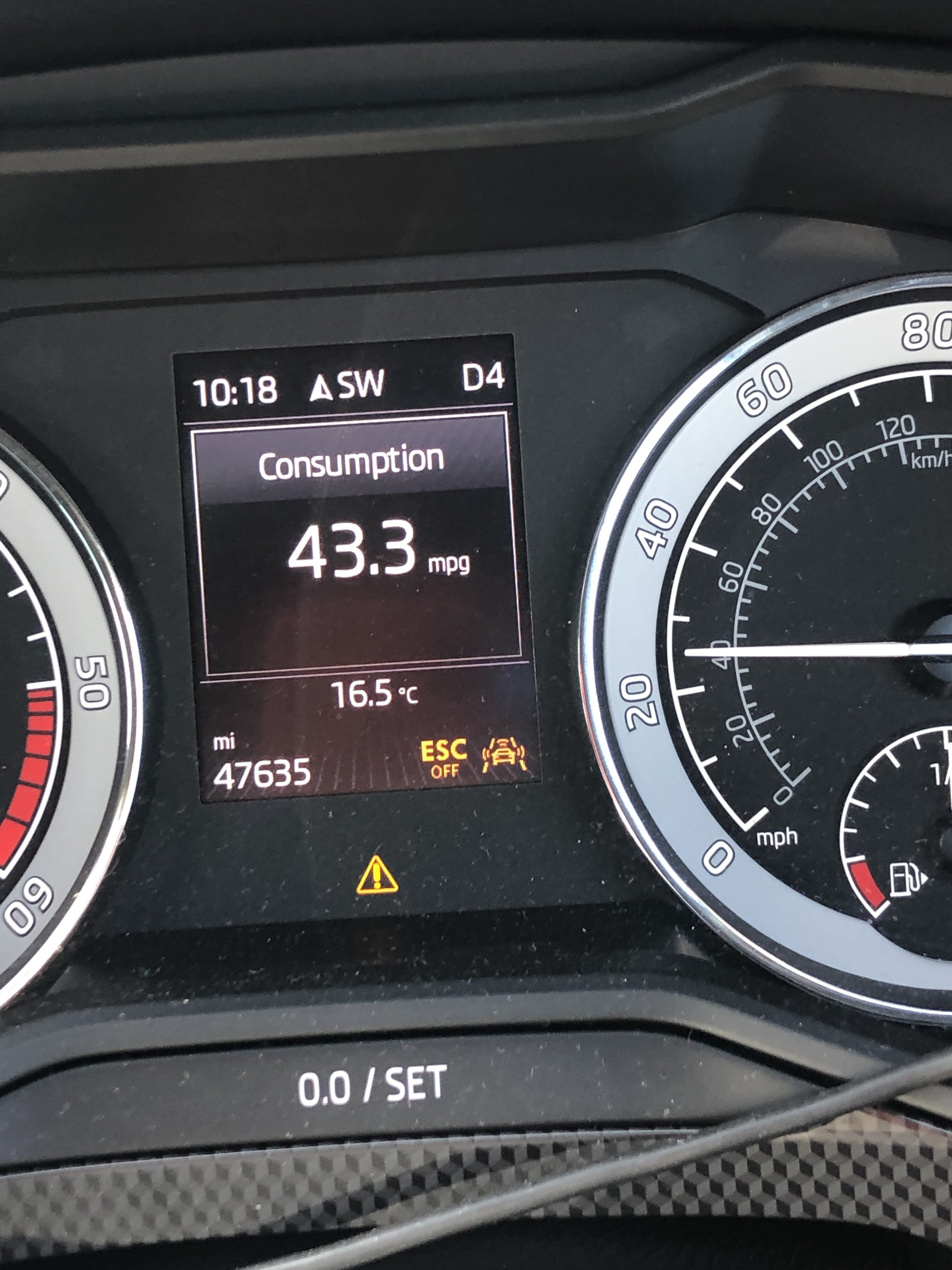

The one that’s gettimg on my wick is that when you switch traction control off and esc off it still switches back on at 60mph. !!!
Have managed to get vcds to code so it switches off completely on a long press of the button which is great but still comes back on at 60.
