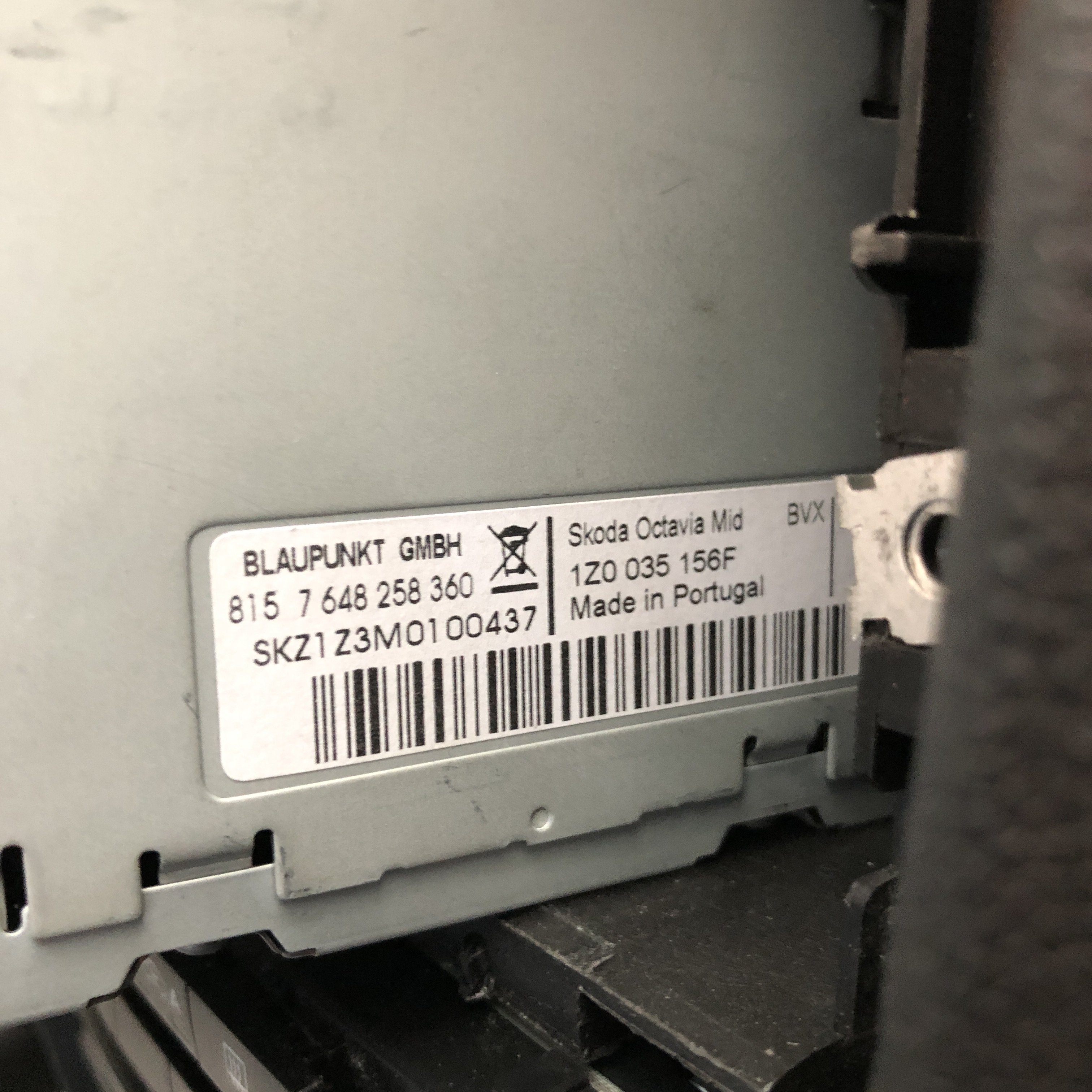

In which case, a module like the one I posted is probably correct. The only this to check is the Bolero version, older Blaupunkt (1Z0 035 156 F) has issues with more recent BT modules. On a 2012 you're more likely to have the newer Delphi (1Z0 035 156 M) version which should be fine. It should be printed on a sticker stuck to the unit.

Morning, after a week away I’ve managed to get my hands on a plastic pry tool and a T20 screwdriver to get the stereo out and I have the not so good version! So I’m guessing this will be an issue now :sadsmile:?
