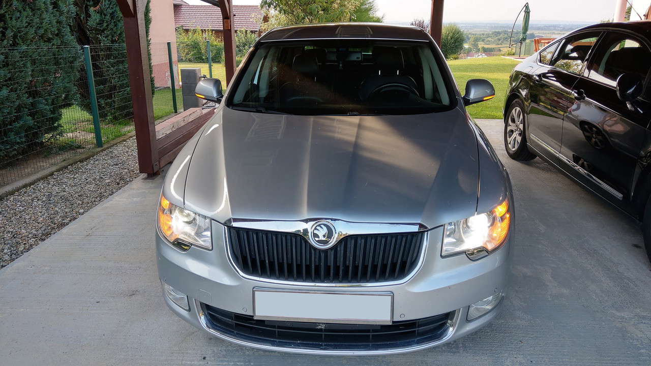

The car is a 3.6l VR6 Black Superb Combi FL (see picture).
Actually it was love at first sight ;-)

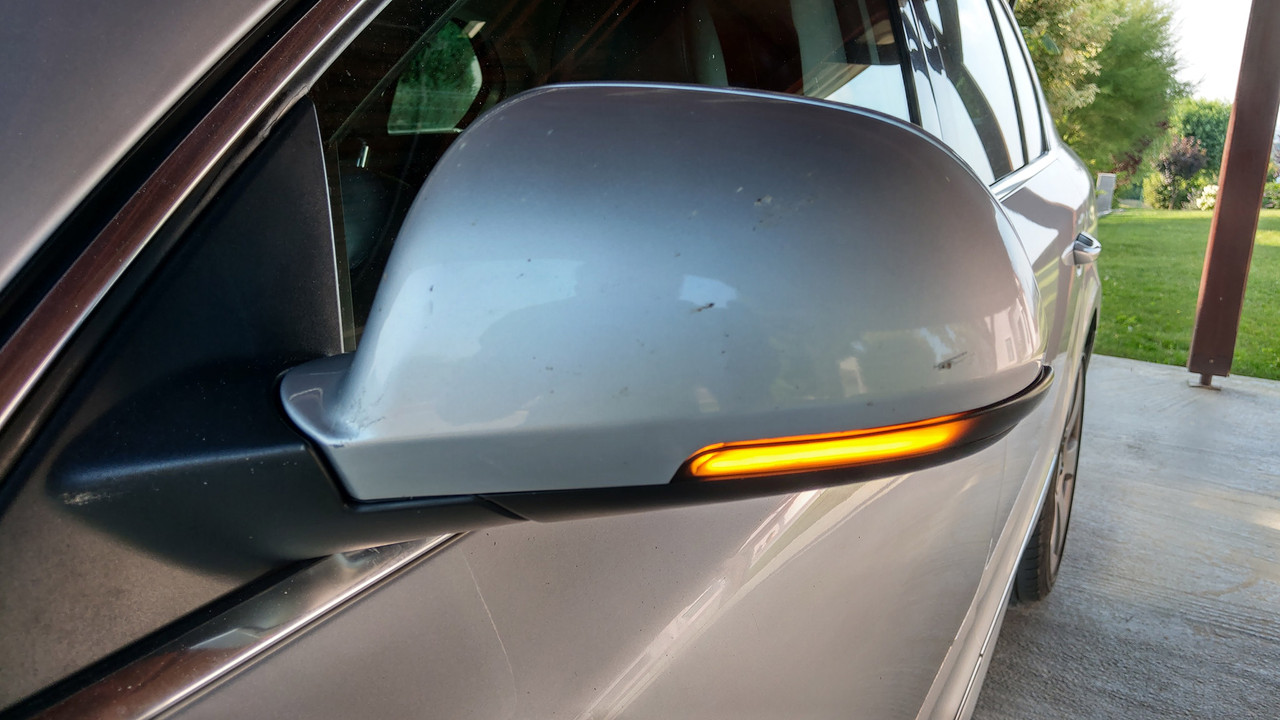

Did retrofitted them today, also took the opportunity to replace the puddle lights by LED ones.
In terms of ease of installation, a breeze with the left one. A little bit more difficult with the right one.
The effect is much better for real than on the phone recorded movie (because of the phone camera sampling rate).
It really makes a big difference.
A very short clip so you can have a feel.
Thus happy to confirm it also fits the S2 FL

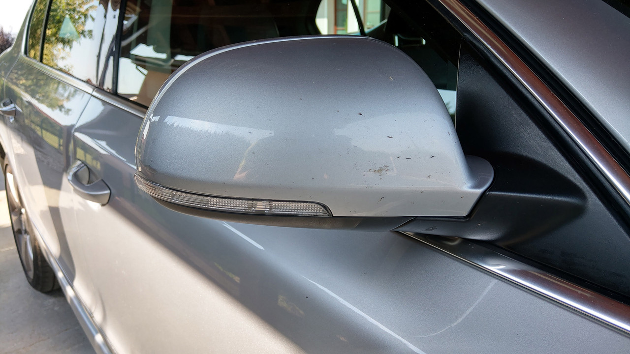

I did the swap on my car today. What I've noticed is that on the light car colours, the new lights black base colour better complements the car as opposed to the genuine indicators clear plastic (makes it better looking and more in sync with the wing mirror black base).
I have ordered some and my S2 looks to be the same colour as yours, they look great! Much nicer I agree!!! Cheers for the pics.
Fitted these to my white superb and agree that the black looks better than the clear factory ones when off and like the effect when on
