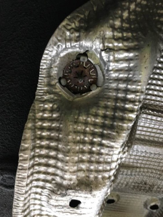

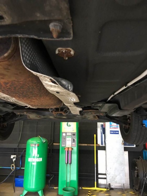

Hi All, ive had my citigo sport since new in 2013 and over the last 6 months it has developed a really nasty rattle/knock on start up and when i put it in reverse and let the clutch out, i found the problem to be the mid section heat shield, one side has rotted away from the rivets and is handing down on the mid section of the exhaust, looking for surgestions should i just remove the heatshield all together or should i try and remove the rivets and re attach it if i can?

the shield has corroded over the washers, thats why i dnt no it it would work again trying to fix it or just take it off all together
From the photo it looks as if you still have the threaded 'stud' from the floorplan. If the washer is not large enough for the hole in the shield, then I would find a bigger diameter washer. You can then use a starlock washer to hold this in place. Peter3197 suggests a cable tie, good idea. I discovered that there are metal cable ties available, so you could also use one of these on the 'stud' to secure the oversized washer and starlock wahser in place.  HTH
