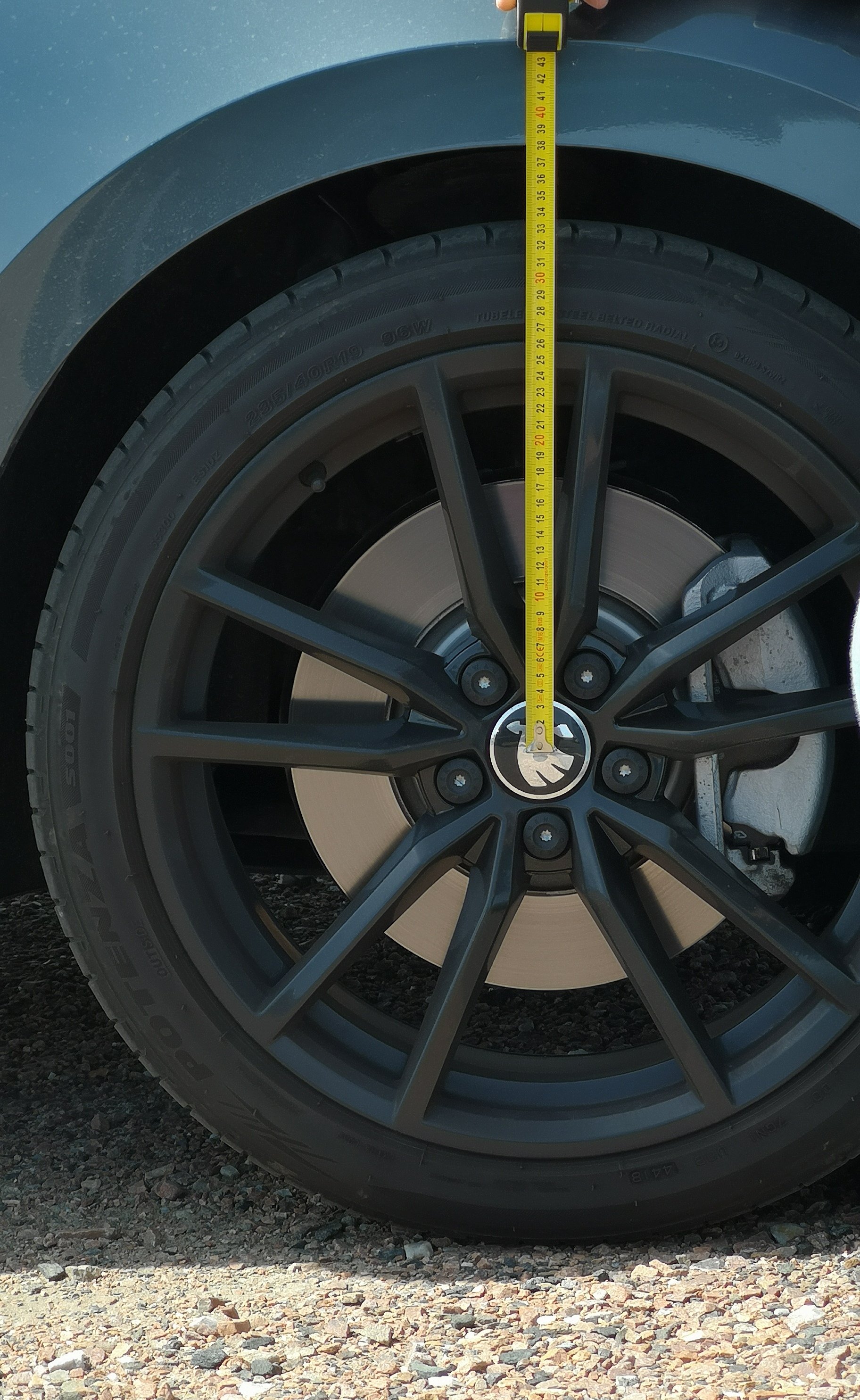

    Done. It handles beautifully  second pic is a before.

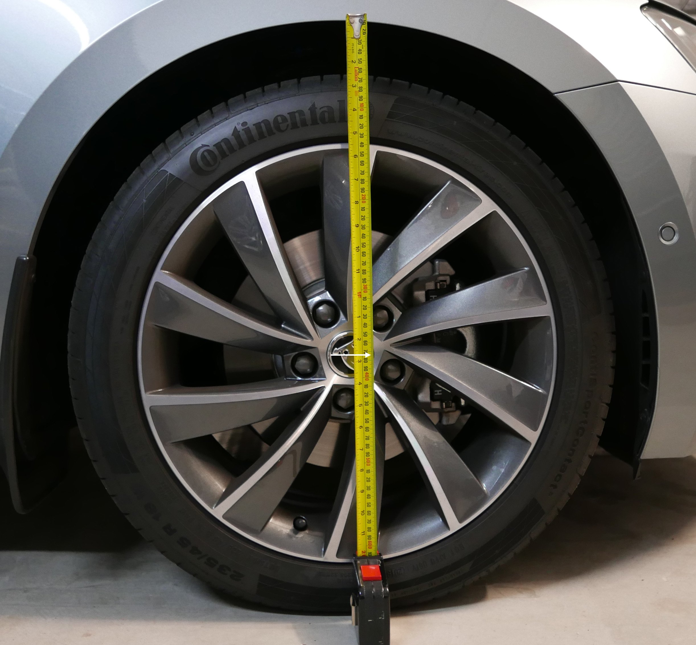

Measured my stock Sportline today: Center to fender is 390mm (took several measurements). That means that as I was fearing, H&R live to up to their reputation and drop at least 10mm more than advertised (exactly what I didn't want). Given the 345-350mm values measured on the lowered car here, we are talking a further 40mm (let's say 35mm accounting for slight inaccuracies during both our measurements) drop from a Sportline DCC, or a 45mm drop from a stock Superb (officially quoted 35mm).
For what I want to achieve: a mild drop that would halve the current arch gap but not nearly eliminate it, I would rather go for the Eibachs that quote 30mm and have a "milder" reputation. On the other hand, for whoever is after the most drop (car does clearly look lowered!) the H&R are the way to go.
Preferences aside, thanks for providing that info and pics @Esseesse200. Helps us all make a more informed decision.
UPDATE: It's in fact much closer to 380mm as seen in the post and photo below, disregard the 390mm value.

Assuming I mis-placed the tape slightly you can (at best) go with 385mm front 380mm rear for a DCC Sportline but not lower than that I am 100% positive.  But I will repeat it today with a friend just to be able to take some photos also.
That's a 10mm difference from the the non-DCC, when in fact we knew it should only be 5mm between them (maybe you mis-placed it slightly too?)
In any case, the photos posted in this thread are quite clear. There could be max 5mm deviation and wouldn't change the fact that H&R seem to drop more than advertised (not a surprise to me personally).

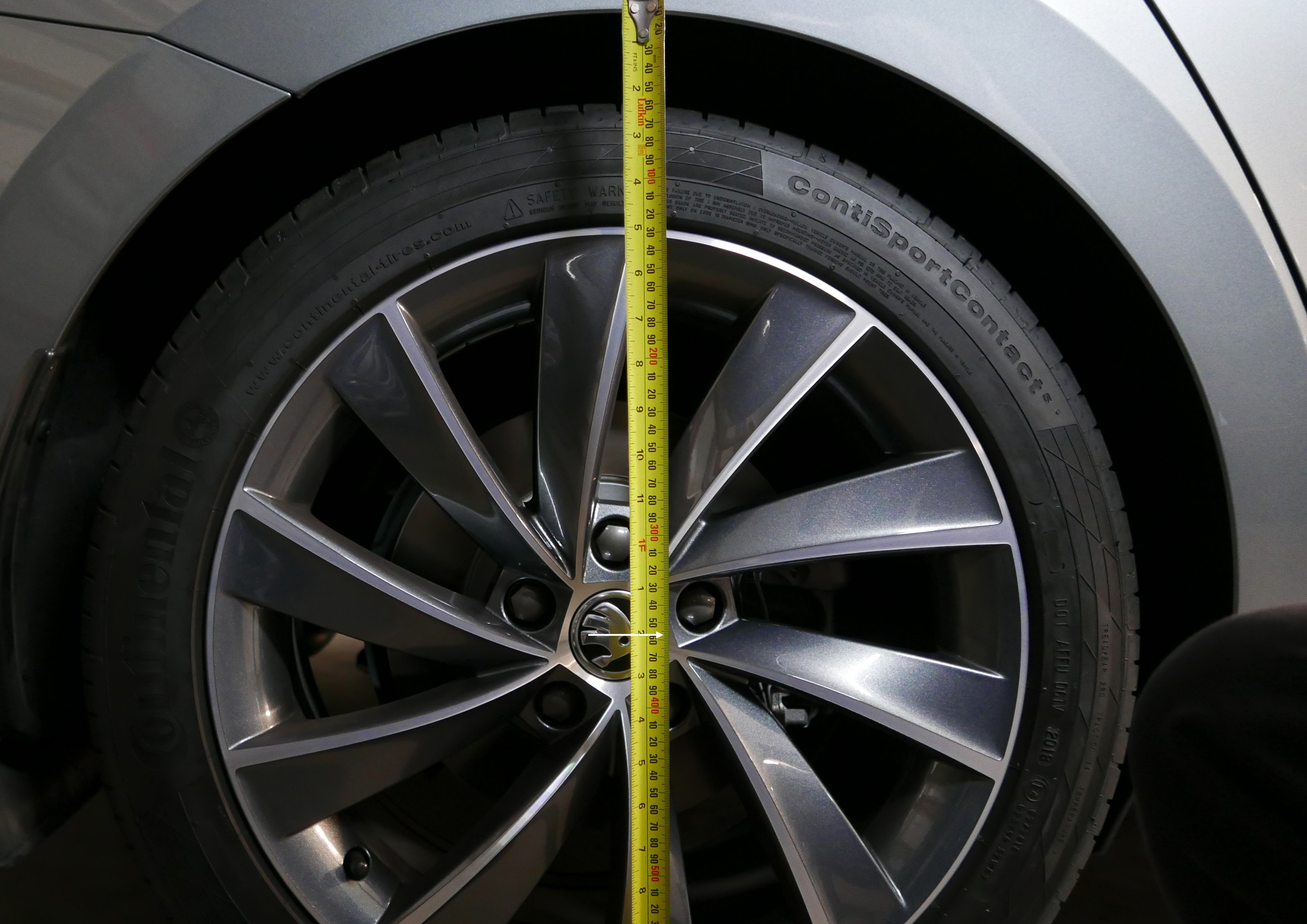

Best I could do with only two arms.

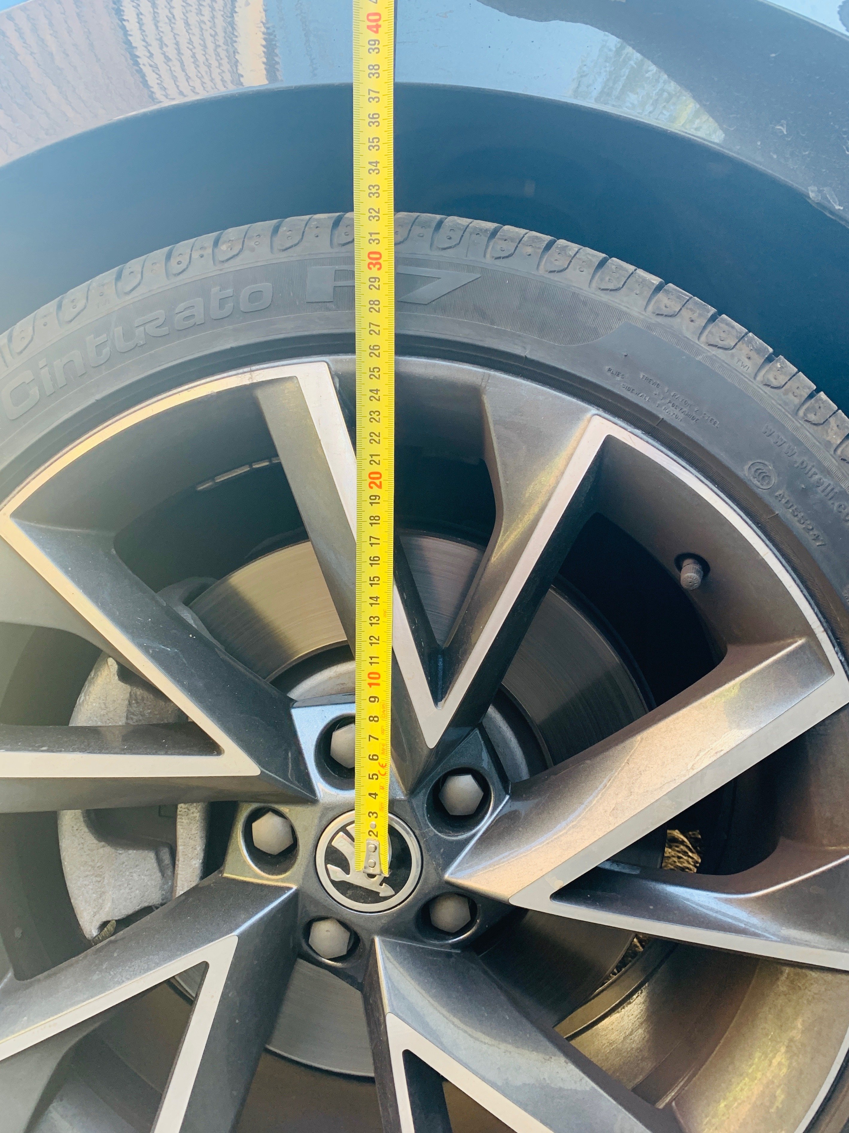

So I repeated this today using some sticky tape to secure the end of the tape on the centre of the wheel, and a friend to take the photo and yes, stock DCC Sportline actually sits a bit lower than the 390mm I measured yesterday: Bang on 380mm (maybe 1-2mm off centre if you wanted to be extra picky) which is exactly 5mm higher from a non-DCC Sportline as @ewlmr confirmed :thumbup:
Still, compared to the H&R measurement of 340mm that's a further 40mm drop from a Sportline, meaning a 50mm drop from stock while they're being advertised as 35mm :o

Because I got curious... Stock Hatch DCC Made 2018 (Nov) last used in comfort mode. On level concrete. The top was precisely aligned with the apex of the wheel arch, camera is at the height of the axle, so it looks off but isn't (at the top)
Front - 373 mm
Rear - 357 mm

Mine (non-Sportline with DCC) is:
Front - 380mm
Rear - 370mm
Half a tank of fuel, 19" tyres.

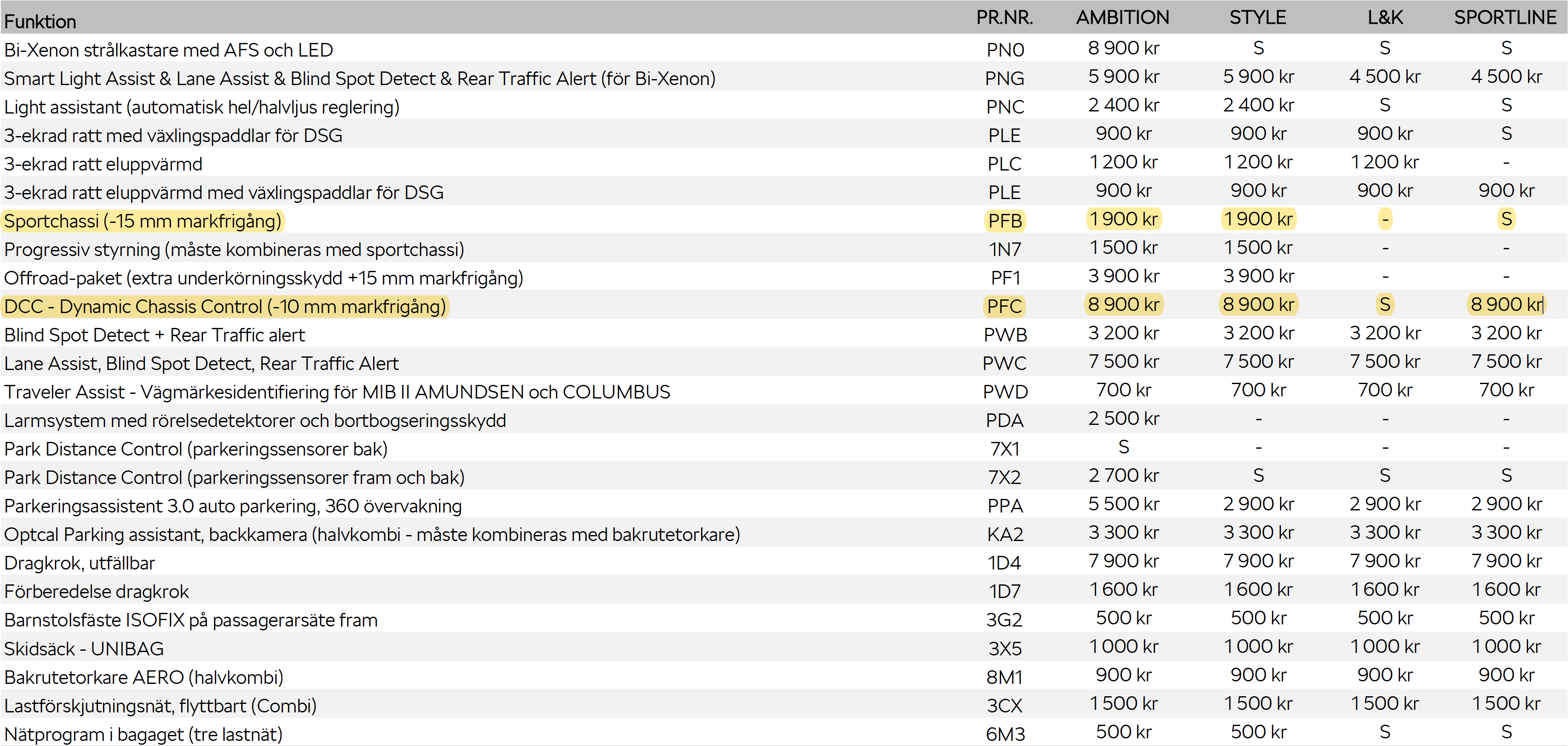

Thats not how it was explained to me by my dealer. What I was told is that the standard Sportline has the Sportchassis (So it is 15mm lower than std) but if you spec the DCC it is only 10mm lower since its the same setup as all other DCC equipped cars. The L&K comes standard with DCC so is 10mm lower than a std non-DCC Superb.
The options pricelist seems to back that up. But as you said the only way to know for sure we be to check part numbers.

Apologies. End of the working day and not thinking very clearly. You must be right regarding the height. All DCC cars should be at the same height L&K or Sportline (Another plus of opting for DCC on standard cars as you drop 10mm).
I was thinking along the lines of the Sportline DCC handling better than the L&K DCC (a conclusion confirmed by reports in this forum) but that is down to different DCC setup (dampening algorithm), not lower springs.
