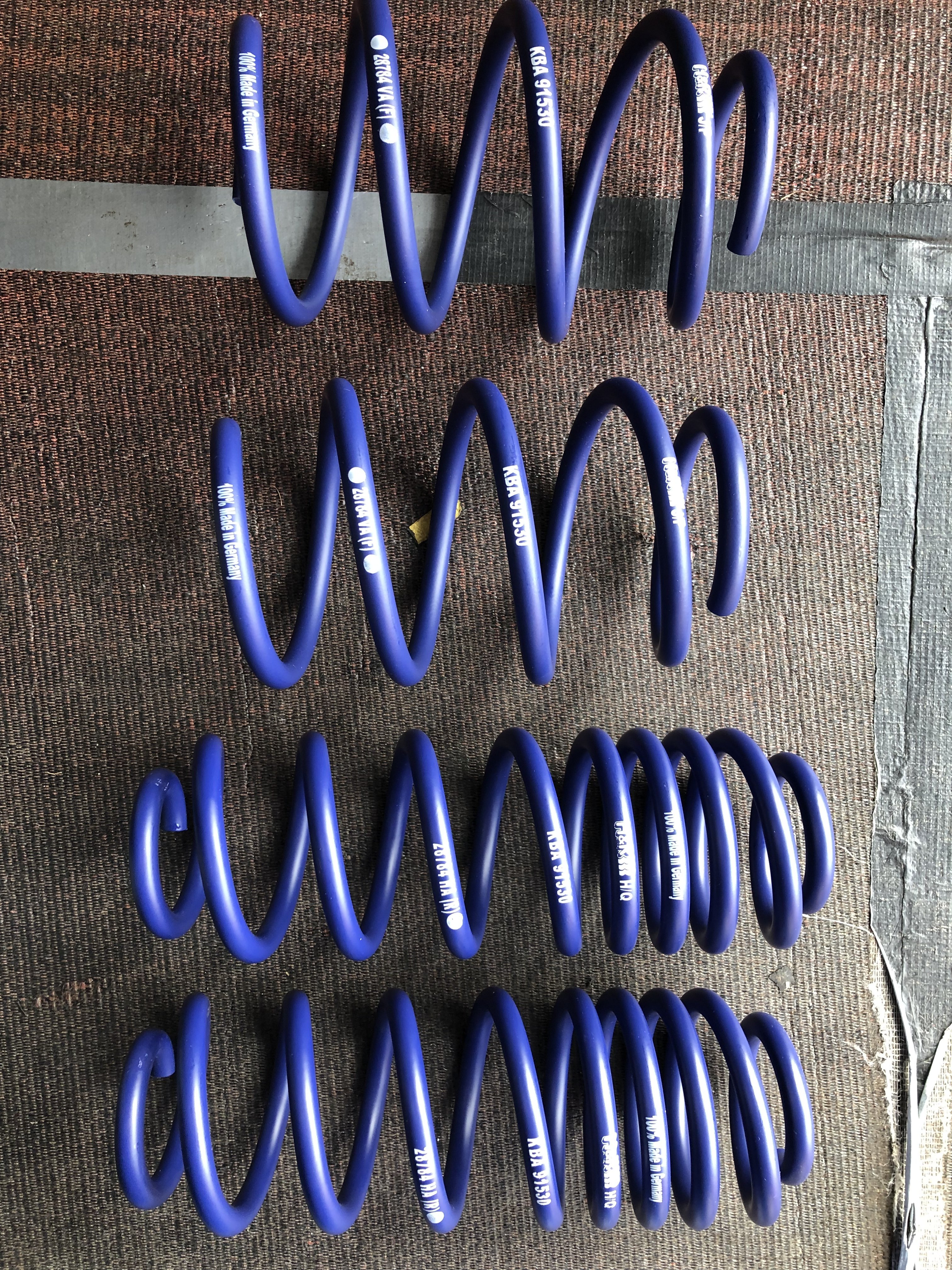

Ooooh blue goodies turned up today

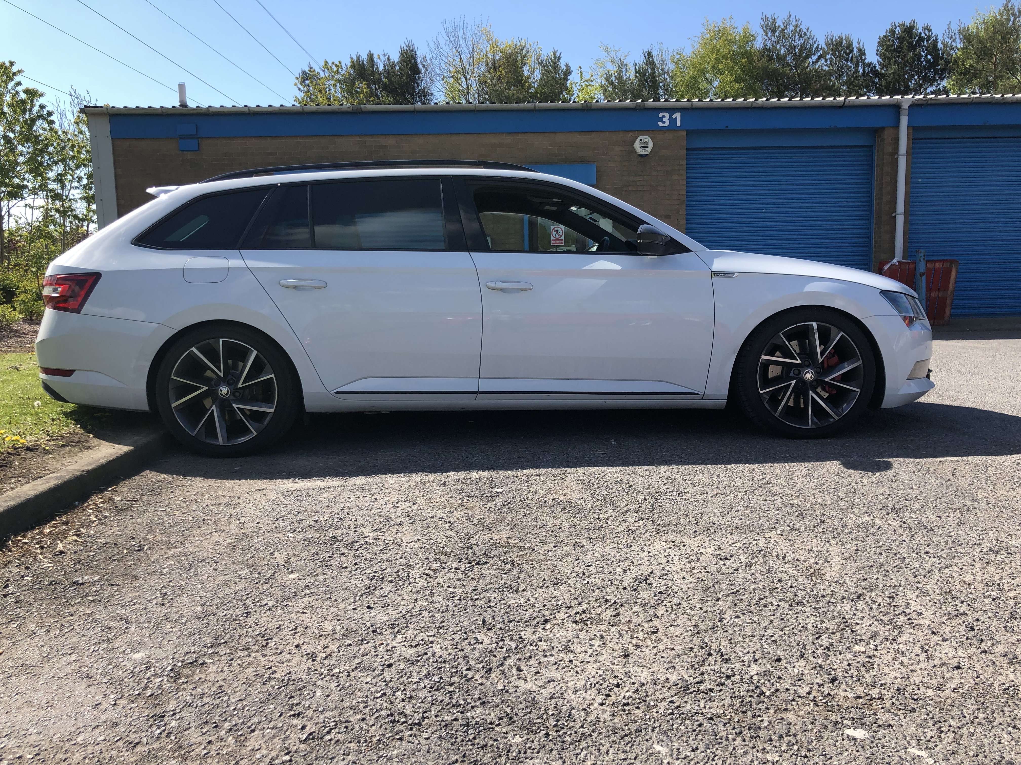

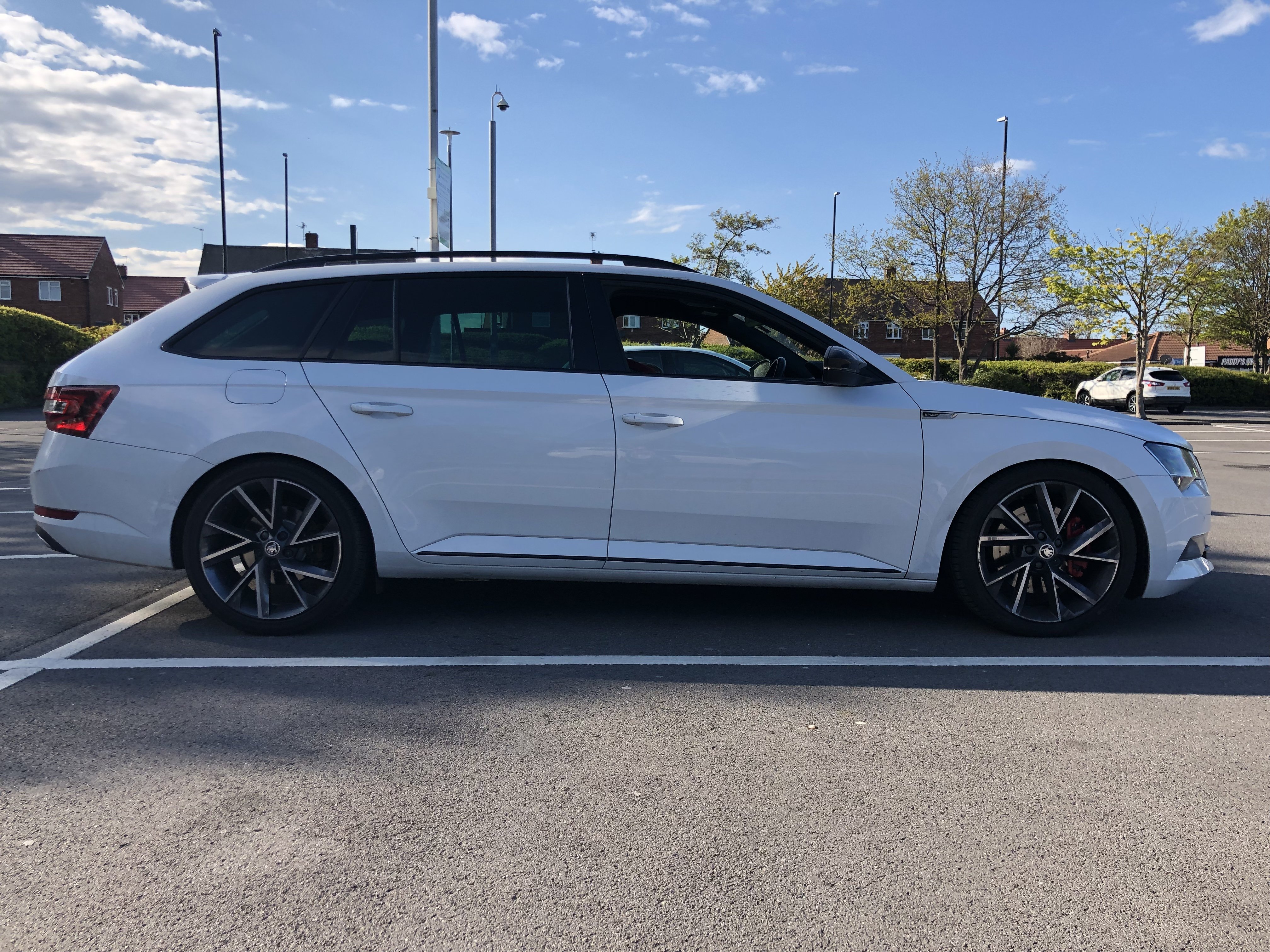

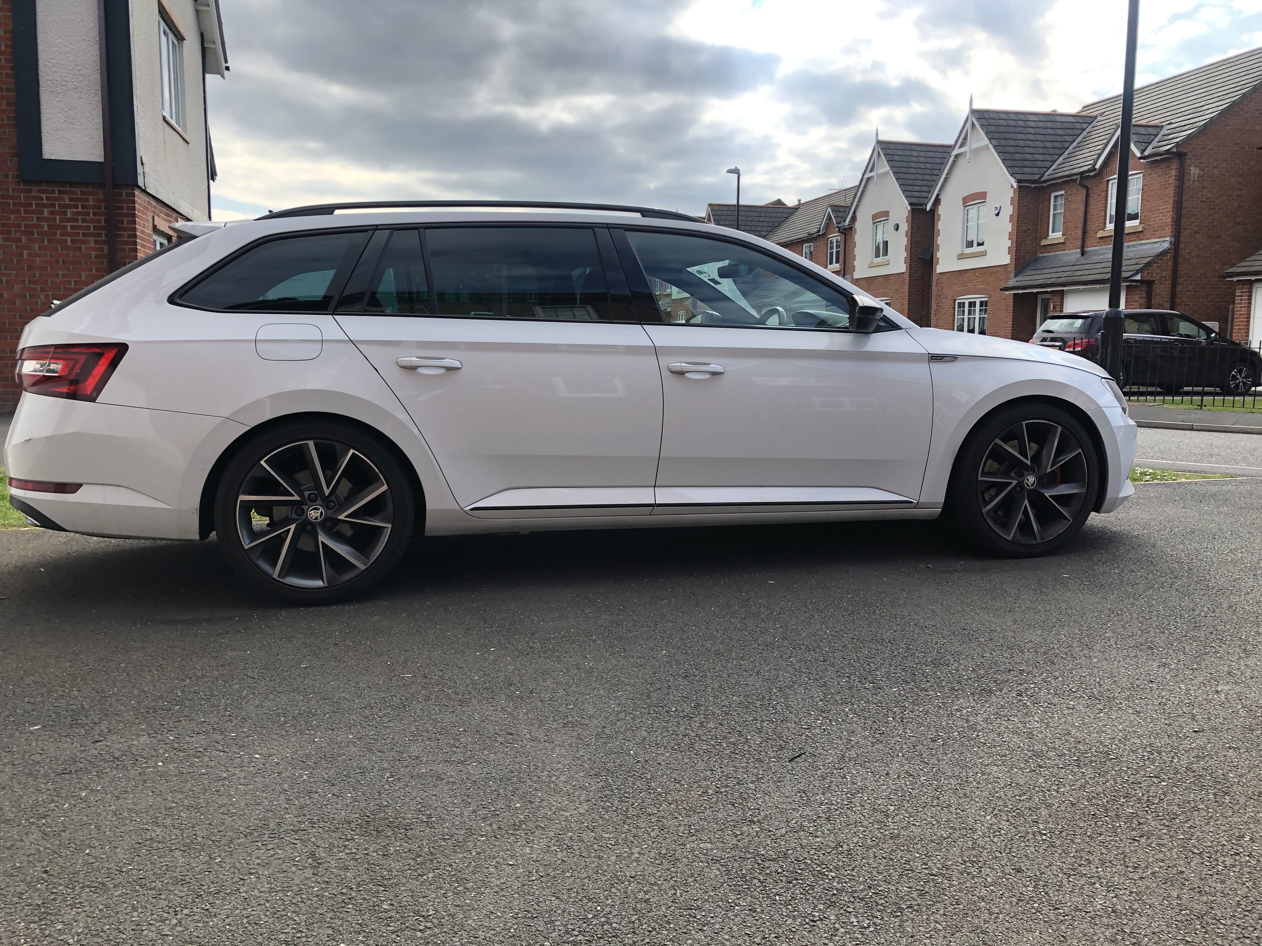

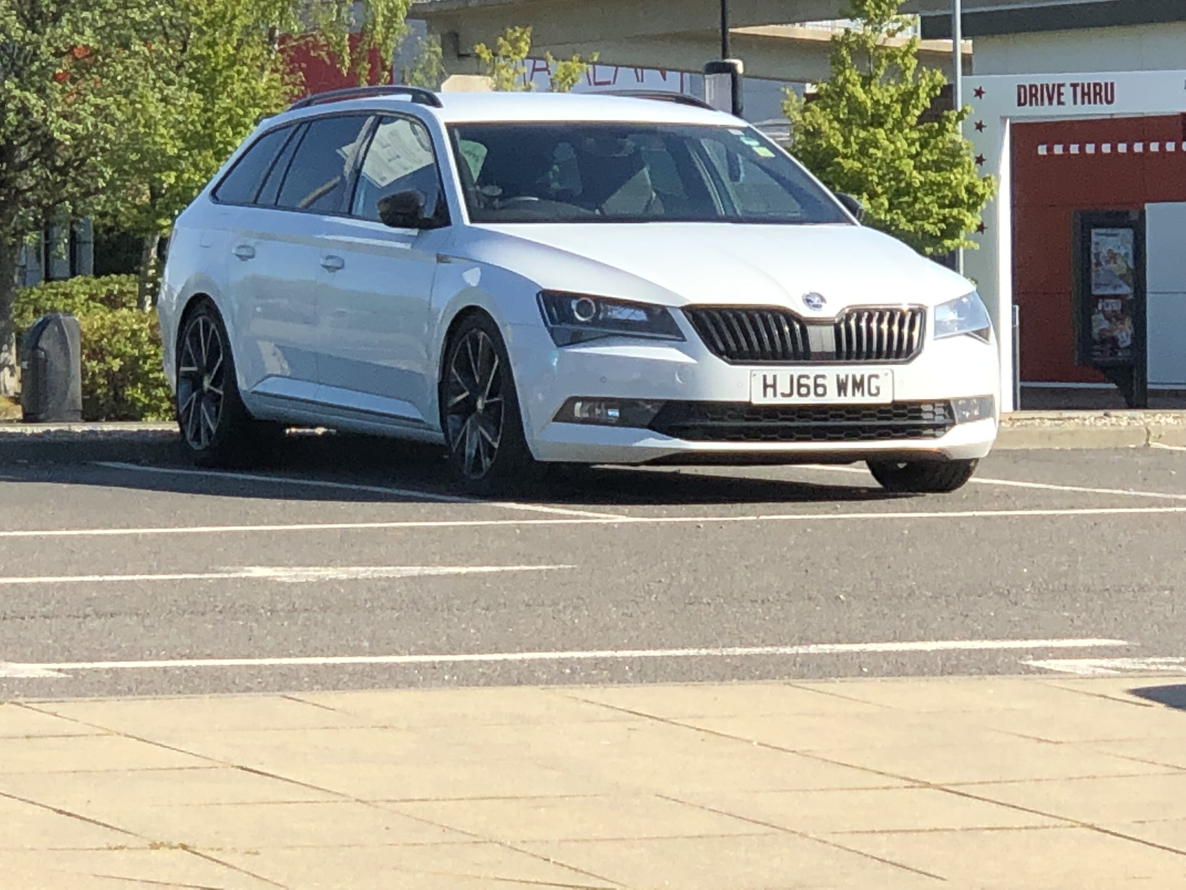

    Done. It handles beautifully  second pic is a before.

Yea mine is non dcc so I’ll do a before pic tonight in the car park then another tomorrow once they are on and I’ll measure too. Obvs it will take time to settle but h&r tend to be really good and don’t sag. This lower the sportline about 25mm I reckon

Yea I’m gone for the cheaper option of springs first and the H&R have always worked with great success. Had them on my previous Octavia vrs and it was spot on. If it still still not right I will go with Koni FSD as I had them on a previous vehicle and they were simply amazing. And I’m reality not that expensive. About 550 for a full set for the superb.
Also so the spring rates for the 272 Should be different to account for different weights (that’s what the performance spring companies do) however Manufacturers being what they are may just use 1 spring rate for both and they may be more suited to the slightly lighter petrol lump

Any difference on the bouncing or possibly too early to say?

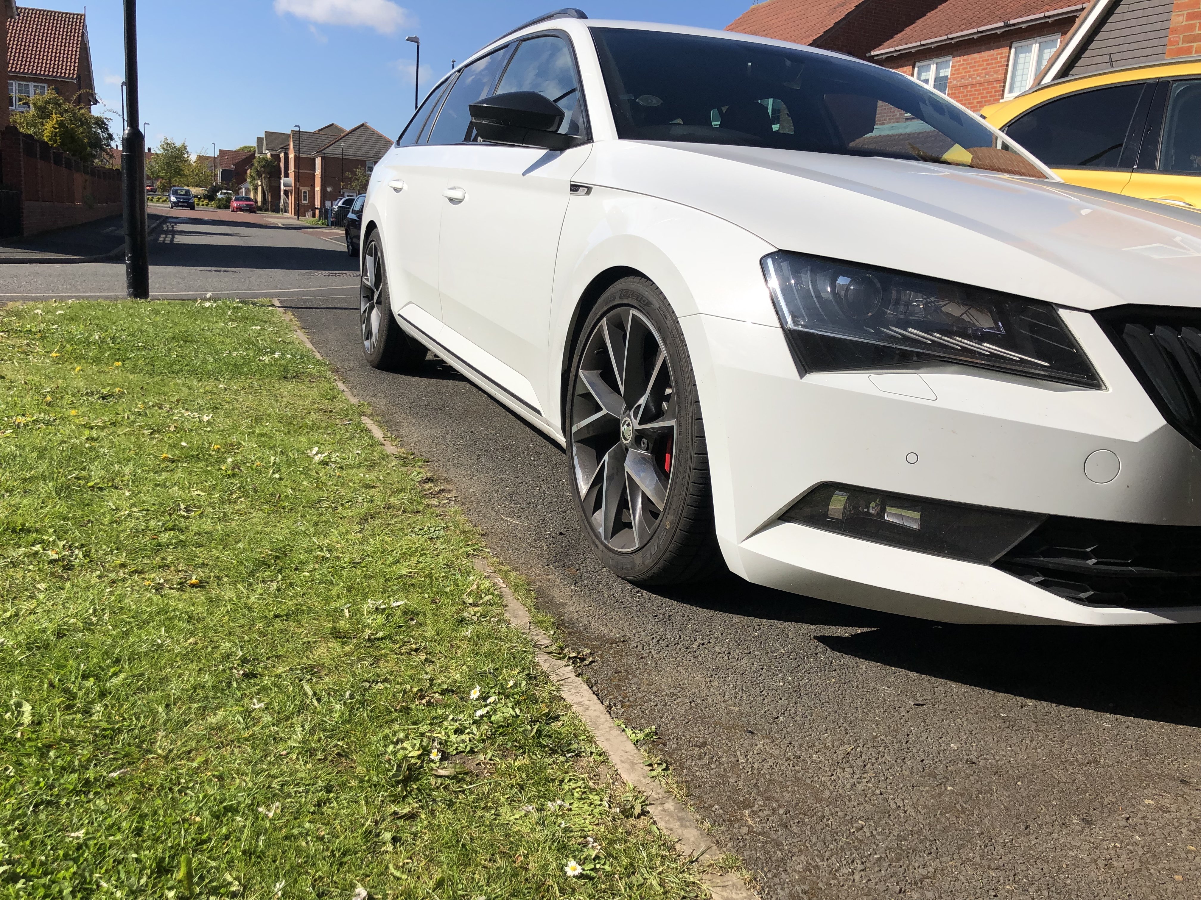

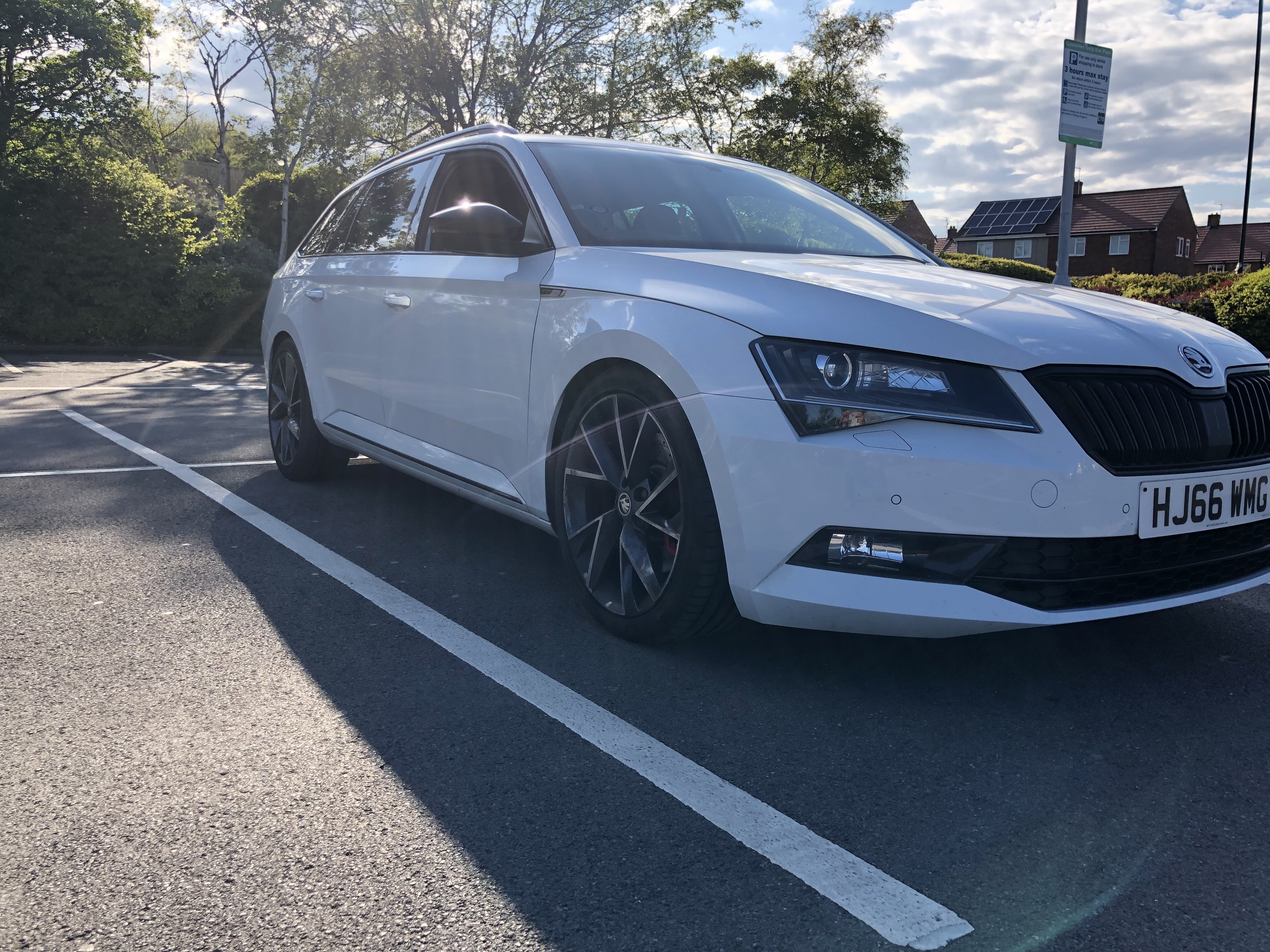

Seems no bouncing now at all and it handles night and day. Doesn’t seem to have taken the back down a lot but I think it’ll settle but from is most Defo -20mm
It does look as if the front is a bit lower over the rear compared with the before pic but you might need to get a few bodies in the boot to get it to settle down! Looks low enough though, might be too much for me (from standard suspension) but I would like to get rid of the bounce and floating
It has dropped the back a bit although the springs were actually about 10mm longer uncompressed than the standard ones. However they will settle in in sure as my Octavia did exactly the same when I lowered that with the H&R. It does handle a lot better tho

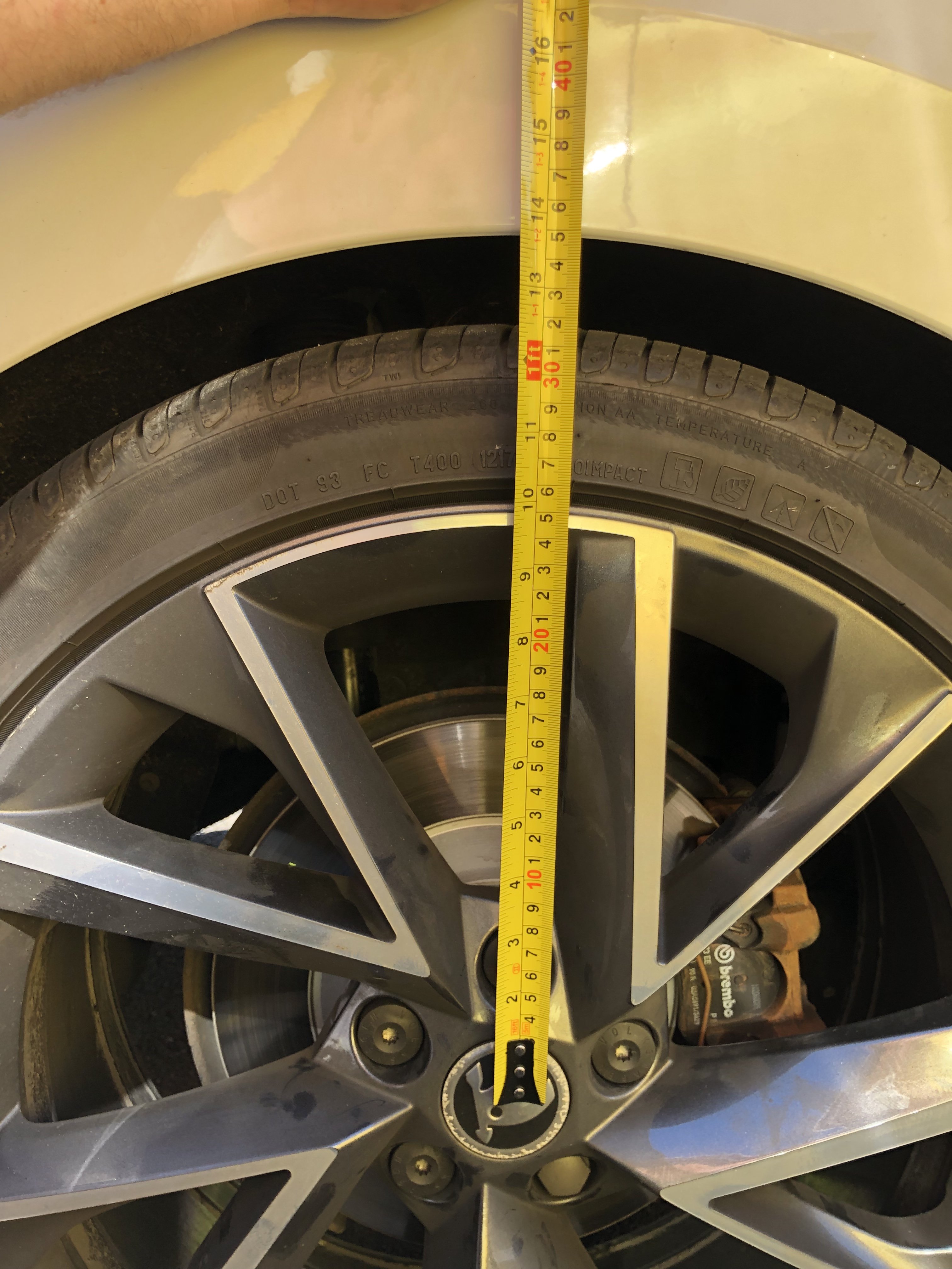

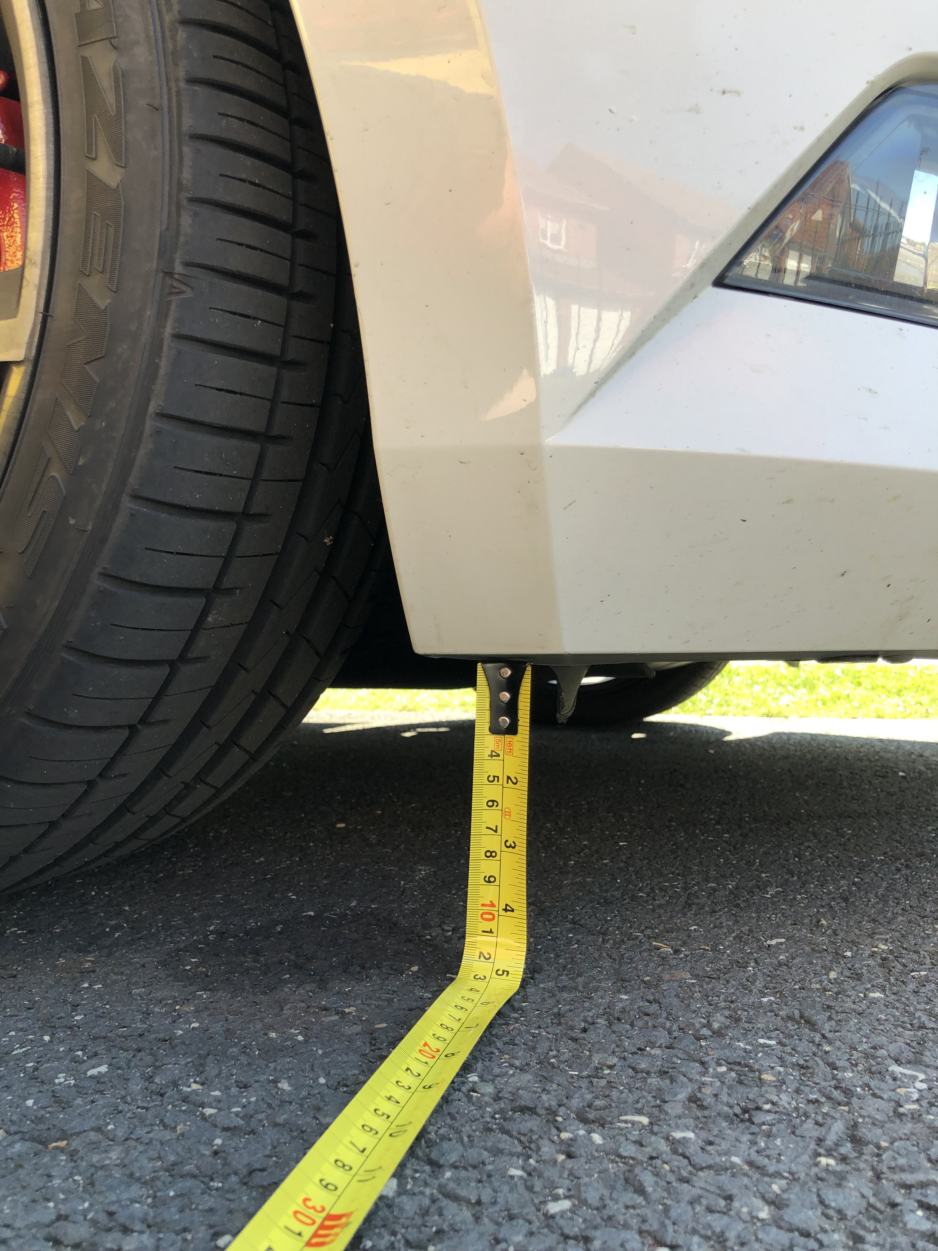

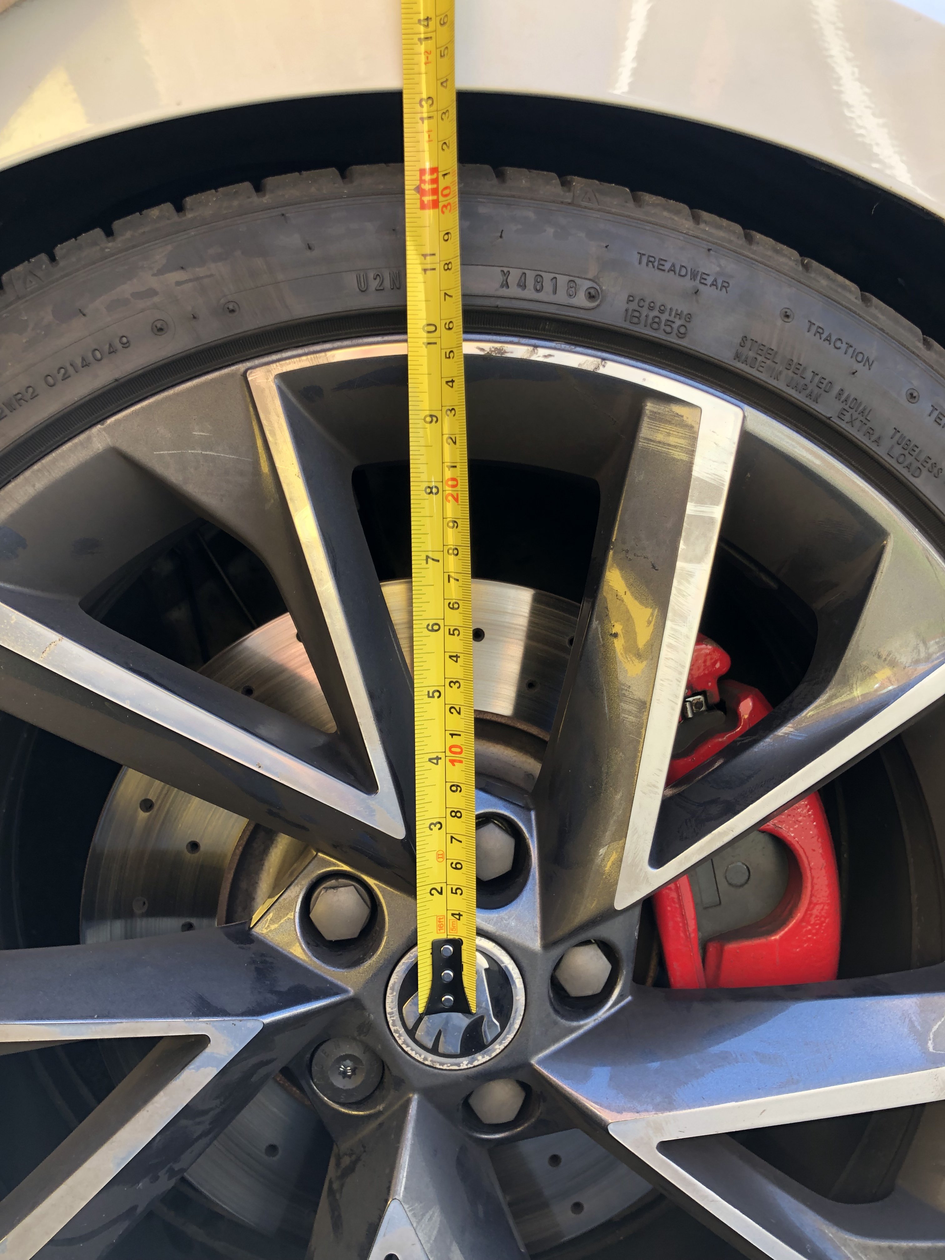

Looks purposeful! But still not sure it's the ideal height that I'd like mine to sit. Would it be possible to take a "wheel center to fender" measurement?? That would help a lot.
10030.jpg&key=5941eae0b2876f0ce478e29ed9
Yea course mate I’ll do it later on.

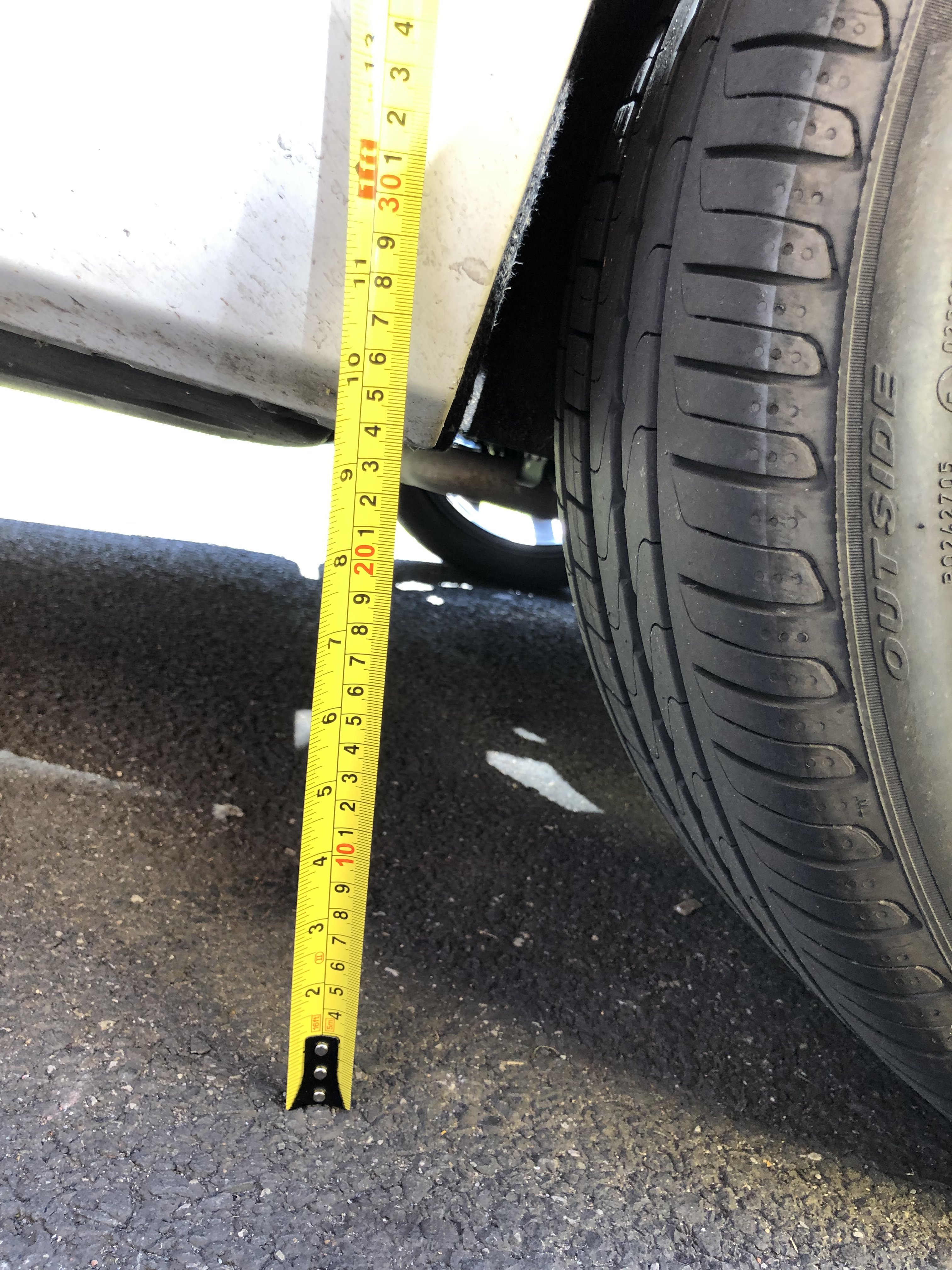

Rear springs settled a bit now. I love it.
Looks even now, nice job, if you get a chance to get a measurement from bottom of front apront to ground and rear bumper behind wheel to ground it would be much appreciated. I'm only on 17"s so hard to compare. I noticed that the springs for the 2wd tdi drop 30mm front and back which might suit me better!

The back might be a bit lower on very flat ground. My drive isn’t absolutely spot on level but it gives you an idea mate. I’m on 12mm spacers too
