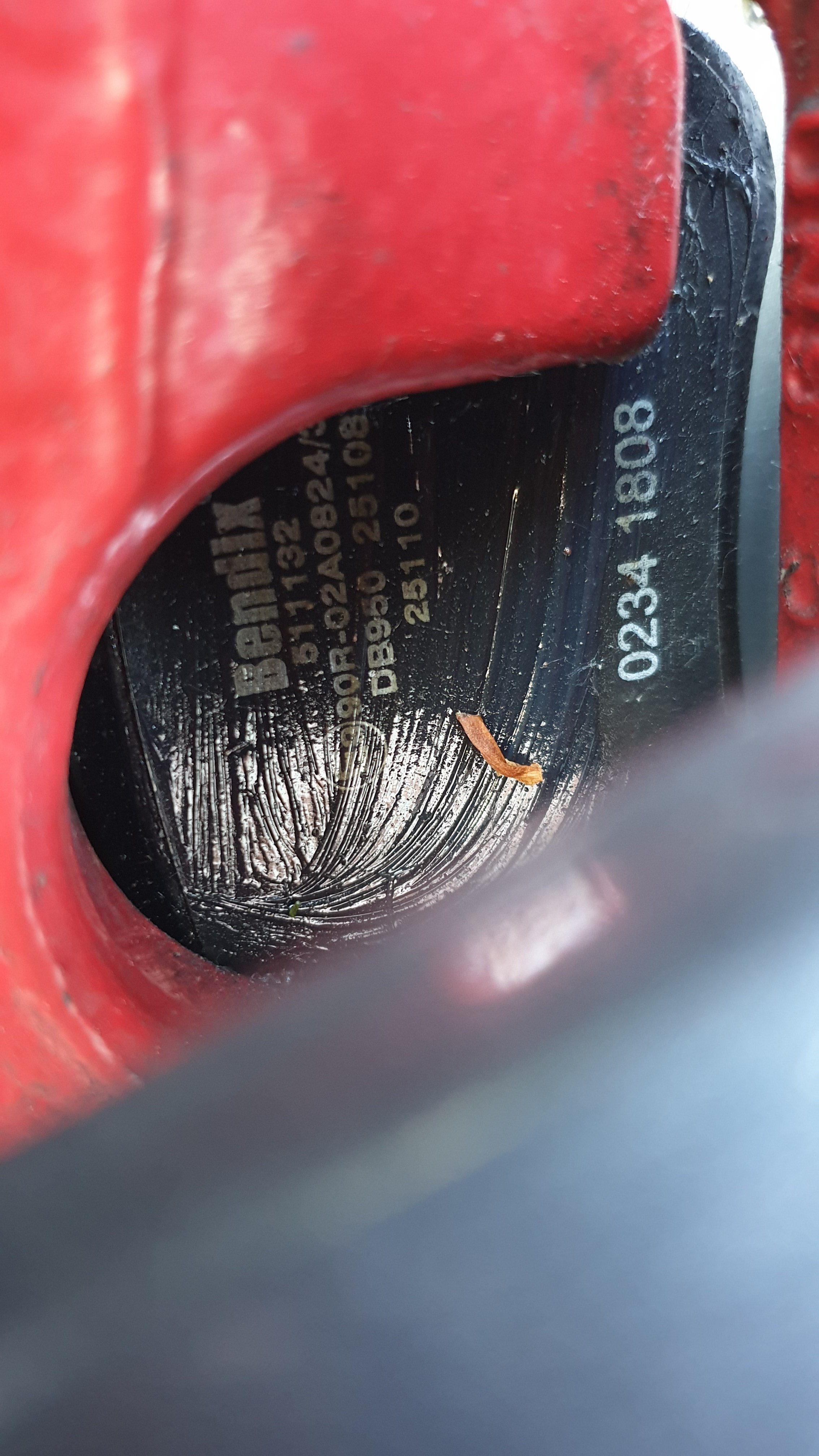

The Vrs was one of my dream cars back in the day and roughly a month ago I made a quick decision and got my hands on a 2014 manual petrol black vrs ;) love it. The rear brakes were really not in a good shape so I paid a visit to a local brake expert in Watford and had the discs and pads changed. After a week the pads started moving up and down for about a millimetre or two and gave a funny cracking noise sometime. I decided to take it back to him and he exchanged the pads last Thursday however they started making this noise again...any idea? This is getting really annoying. I paid 170GBP for the discs and pads. Sometimes I feel there is a good reason why Skoda dealers charge much more but get the job done.

Find out which pads they are. Sometimes 3rd party lads move slightly in the callipers.
This one is at the back. At the front i can see an audi sign😎

It could be that the pads are supposed to have spacers fitted to stop them moving slightly. A good pad kit would come with new ones.

My local Audi specialist did my rear discs and pads (i supplied) for £75.  I used MTEC disks and Brembo pads.  Never had a problem (used the same setup on my Oct 2, Cooper S and A4 Quattro).
Ive never heard of those pads before tbh (in your pic)
Edited by ScoutCJB
I've never used Bosch pads so dont know what they are like but Brembo are good - you could also always go for standard pads from Skoda.
Not saying the Bendix arent good, just never heard of them and strange you have only had issues since trying to use them (assuming the first replacemnet set were Bendix also)

Bendix are a decent brand and place about the middle in terms of quality, should perform slightly better than OEM.
Funny when i checked out their website there were no pads for skoda at all. Anyway i ordered the brembo pads. Lets see
