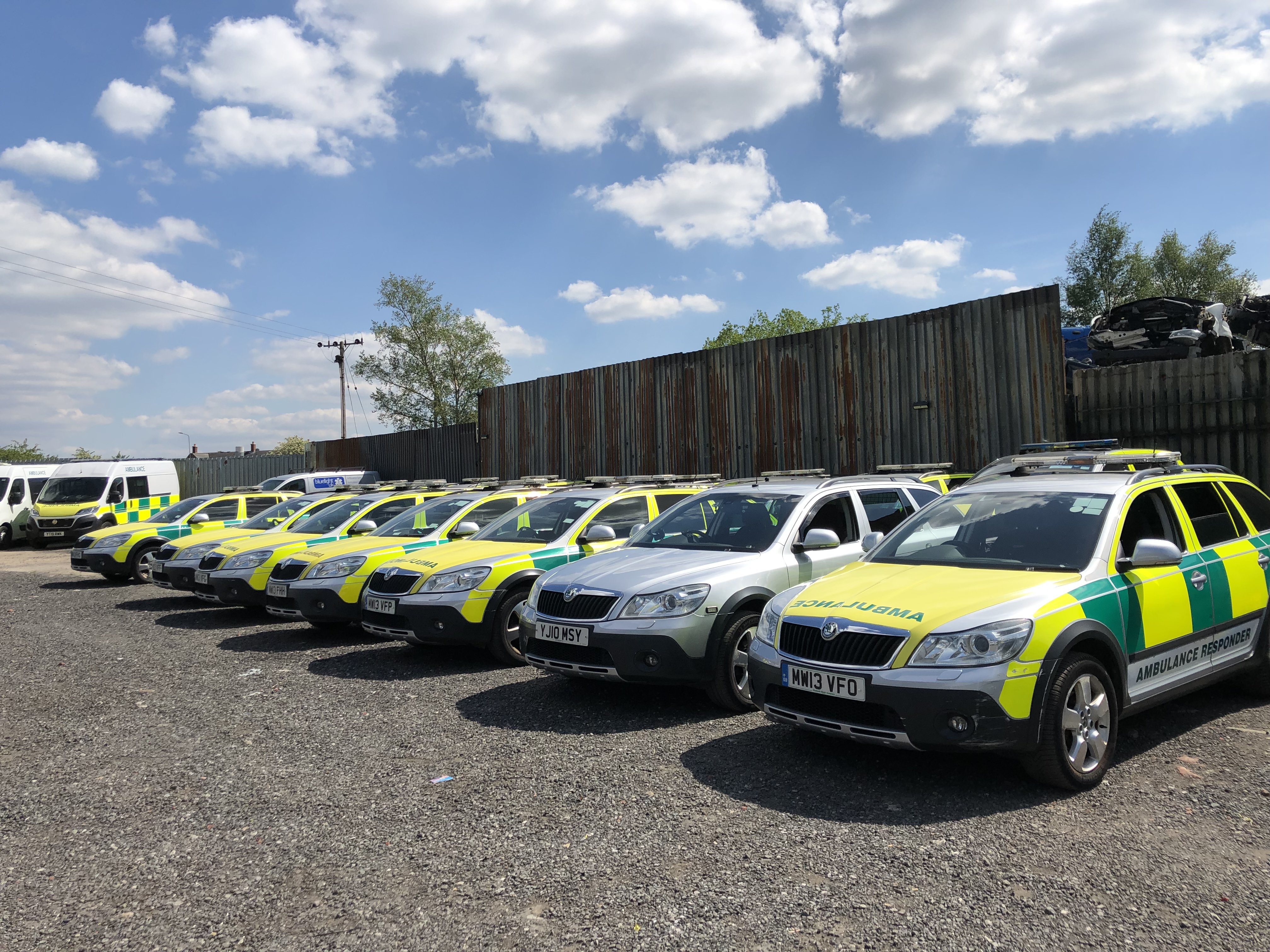

   P.S mine is the silver one... de-commissioned Rapid responce vehicle (paramedic car)
 all parts that I’ve swapped and changed are from the rest of the fleet.
I own the company who does the servicing, wiring repairs, Bluelight conversion etc etc.
