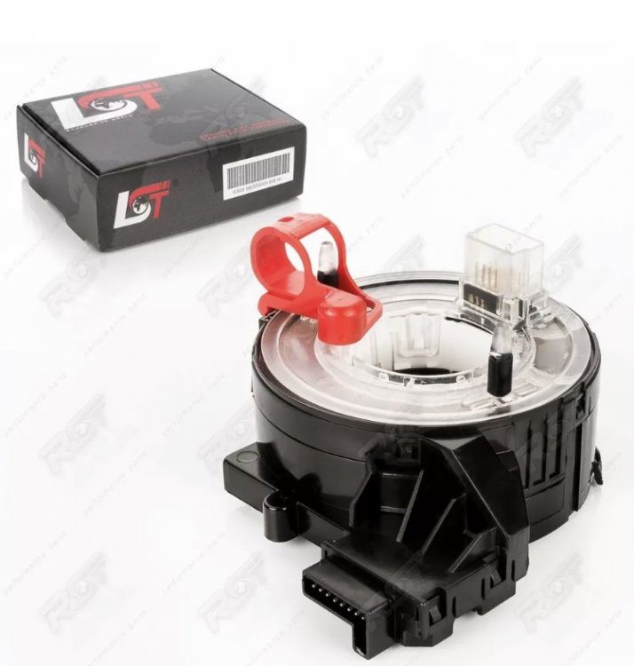

I still want to know what a clock spring is
In vehicle steering systems a clock spring or clockspring is a spiral-wound special rotary electrical connector which allows a vehicle'ssteering wheel to turn while still making an electrical connection between the steering wheel airbag and/or the vehicle's horn and other devices and the vehicle's electrical systems.
The revolving contact ring behind the steering wheel. Allows for electrical contact and steering wheel/airbag functions. May also contain a steering angle sensor. aka Squib, contact ring.
Thanks both - I'm astonished that in all my years of car ownership and maintenance I've never come across this term.
Every day's a school day!
They don’t give to much issue to be honest. Maybe the odd clicking. Days of old they would have purely been for a horn button connection (although that also used to be just a brass nipple on a spring that sat against a contact ring, hence the name). But as tech has evolved and more and more steering wheel features have come about it’s now a £200 component and a little more prone to failure.

See gentleman on eBay who repairs squibs /clock springs located in Oldham or Birmingham. Only takes about an hour.
Only just had it done so hoping to repost if still going in 6months time.
I take it you mean this one, did you take car to him or did you remove the part?
https://www.ebay.co.uk/itm/363728064538
Yes this is the one. I took the car to him. He removed it and reinstalled it in front of me. Amazing how quick. Just send him a message to ask when he’s available. It was the Oldham one but as you located further South I can’t comment on the Birmingham one.
