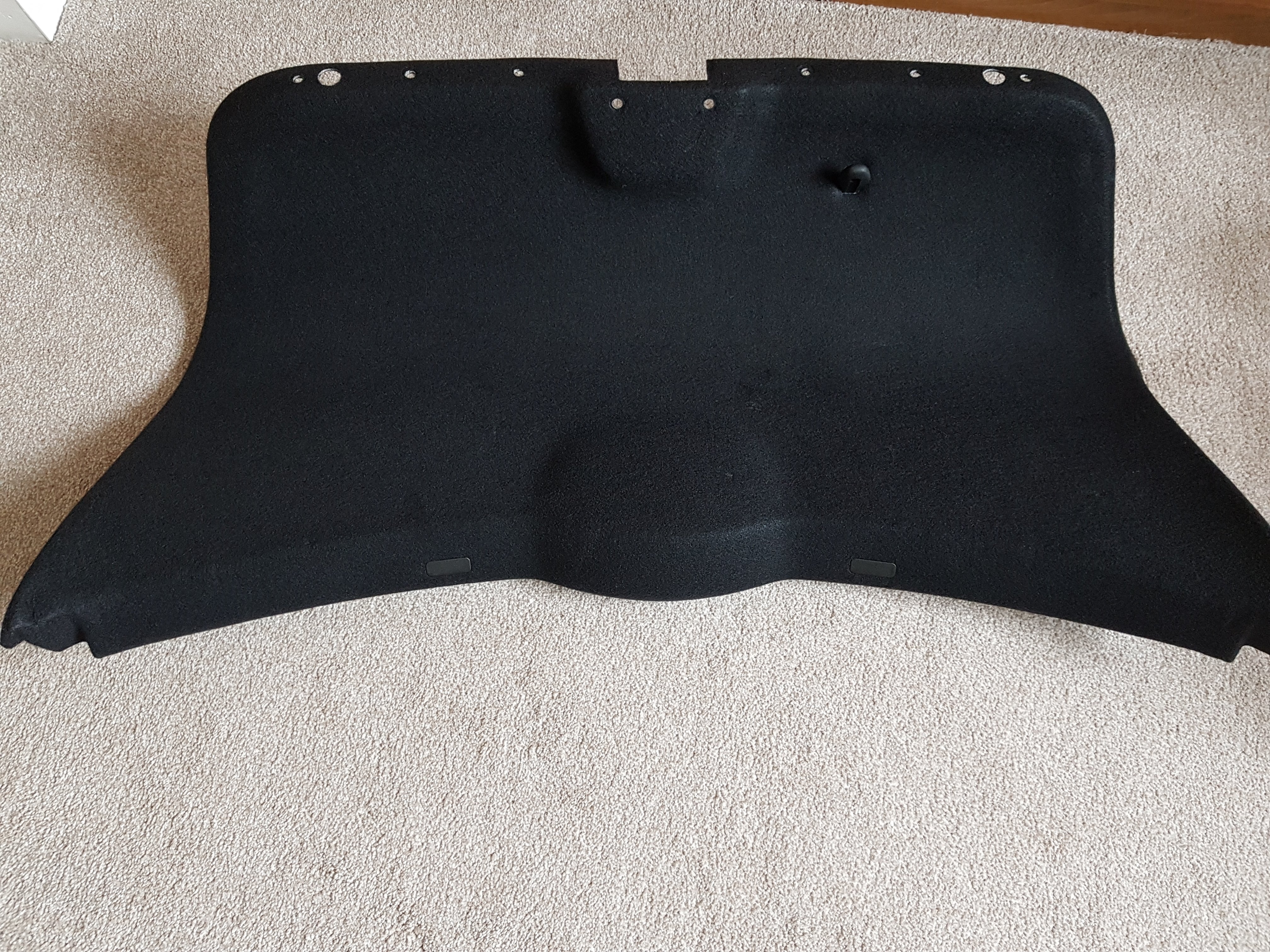

Car is a 2015 hatchback/saloon. Here's my notes from removing the boot trim.

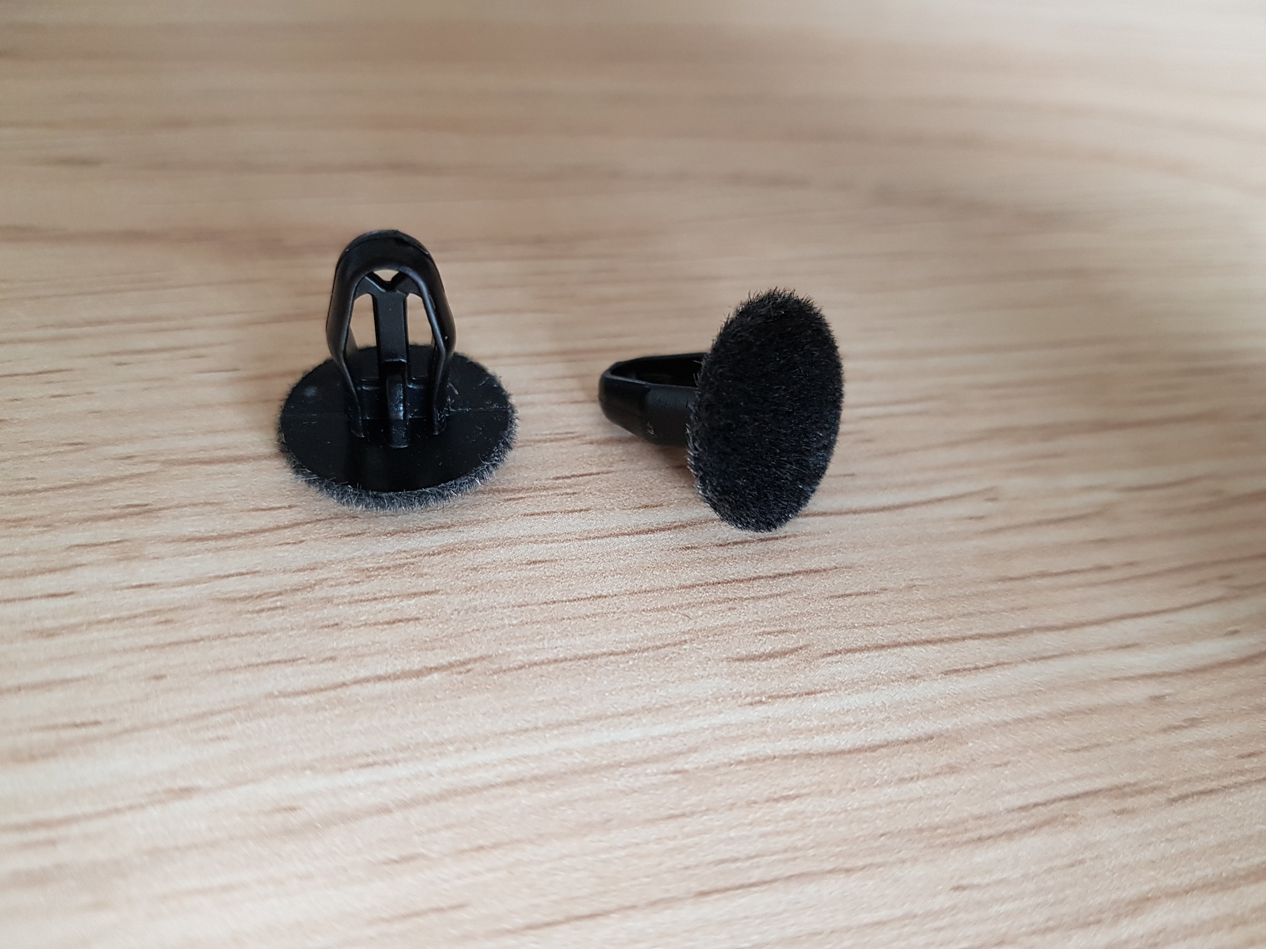

There are 8 of these clips to be removed using tool or a fork, you can see the holes where they were on the top of the trim in photo below.
Trim photo:

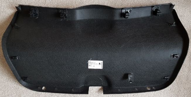

    I'll add some pictures I took that might help anyone else - I know there are better write-ups:   So firstly, remove the tailgate inside using a trim tool. You can then see the back of the bo
  • Fitted mine today, now realise that the Chinese thing I have bought is not Android although I cant see what functionality it lacks, anyway the camera was plug n play, i did nothing regarding the rever
reverse of trim. remove torx and start with clips on the side and work your way around.
