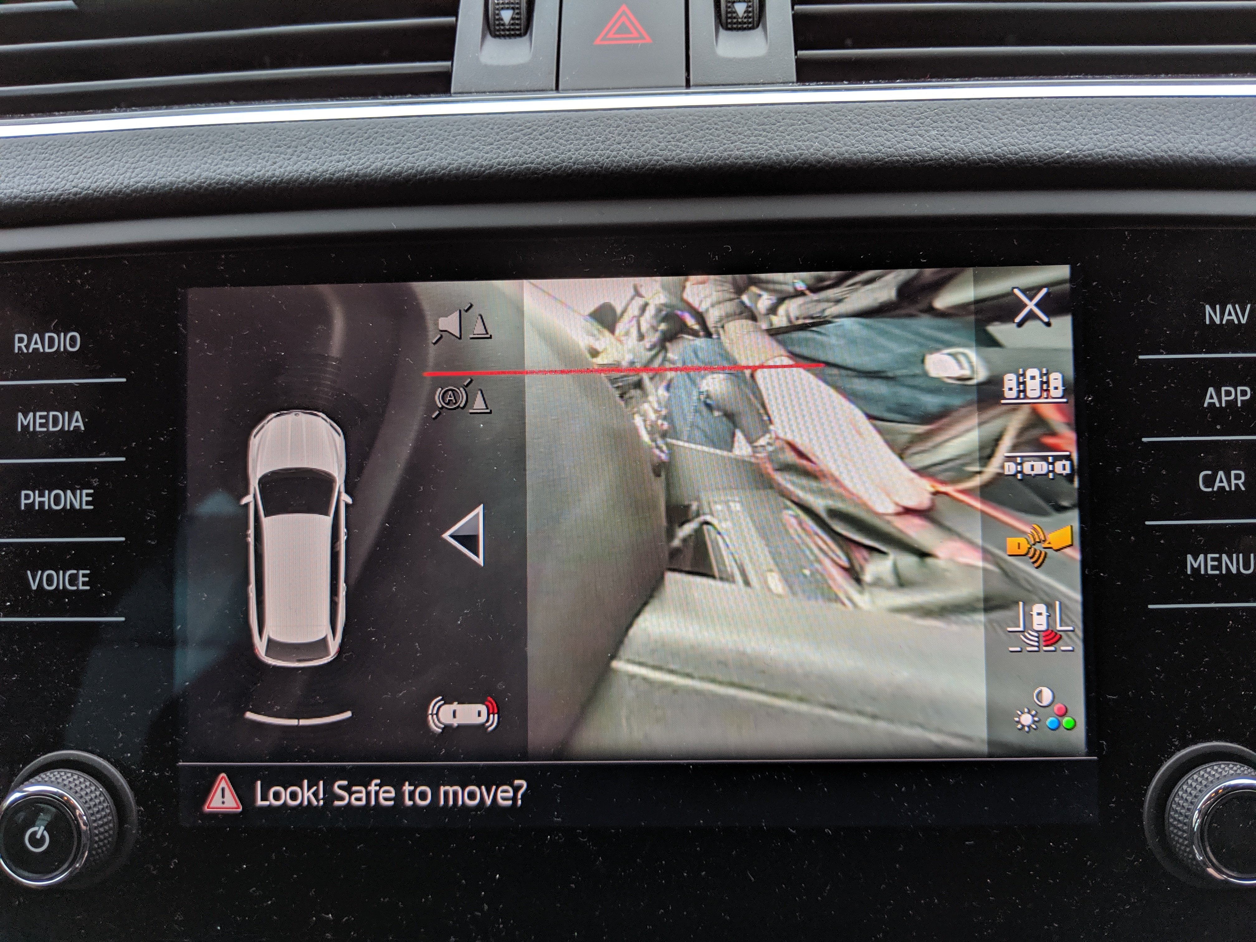

Got it fitted at last,
https://www.aliexpress.com/item/32964908529.html?spm=a2g0s.12269583.0.0.3e5b78afY3YGVA
not too impressed with the picture quality, not what I'd call HD. Seems rather fuzzy and indistinct, anyone found a similar unit with higher resolution?
Followed the instructions about coding in, which went okay, went for a drive yesterday and had to slow up and keep tight to the overgrown hedge on a tight corner due to oncoming car and heard the front N/S sensor beeping! My 2015 car has Park Assist so has sensors back, front and sides, but in the last 5 years only activated after reverse had been selected, now it seems activates at below certain speeds on front sensors. I will have to check this out more thoroughly to see exactly what circumstances this happens in.

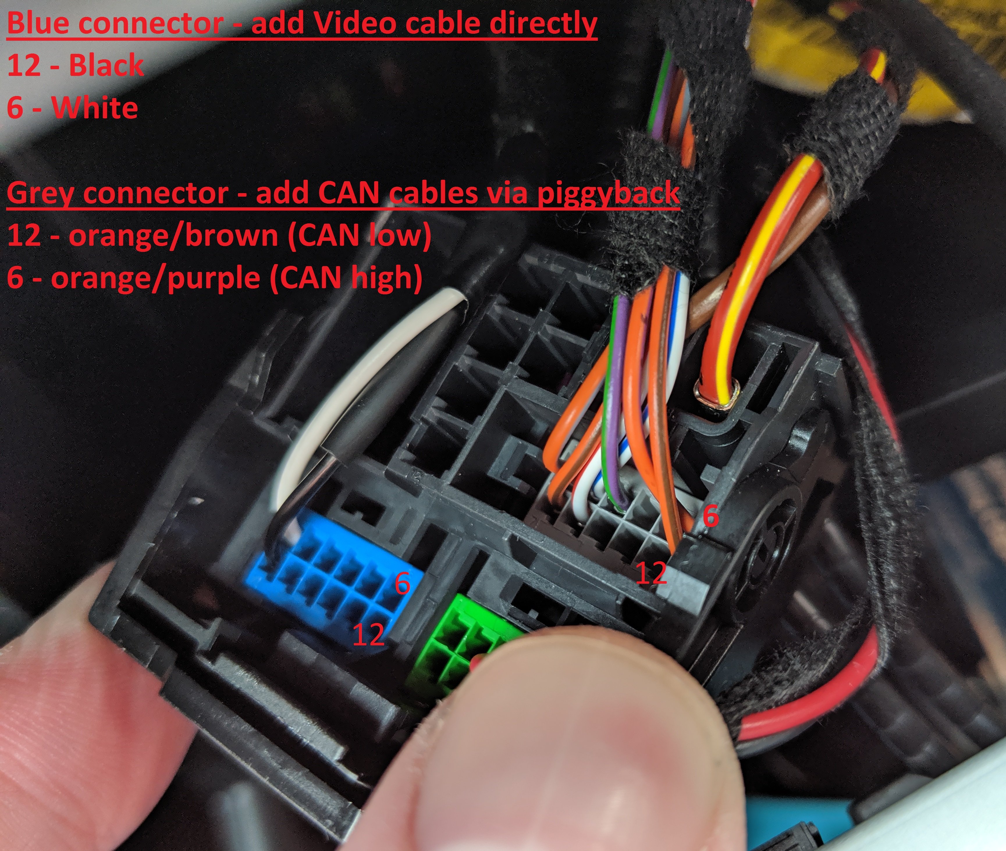

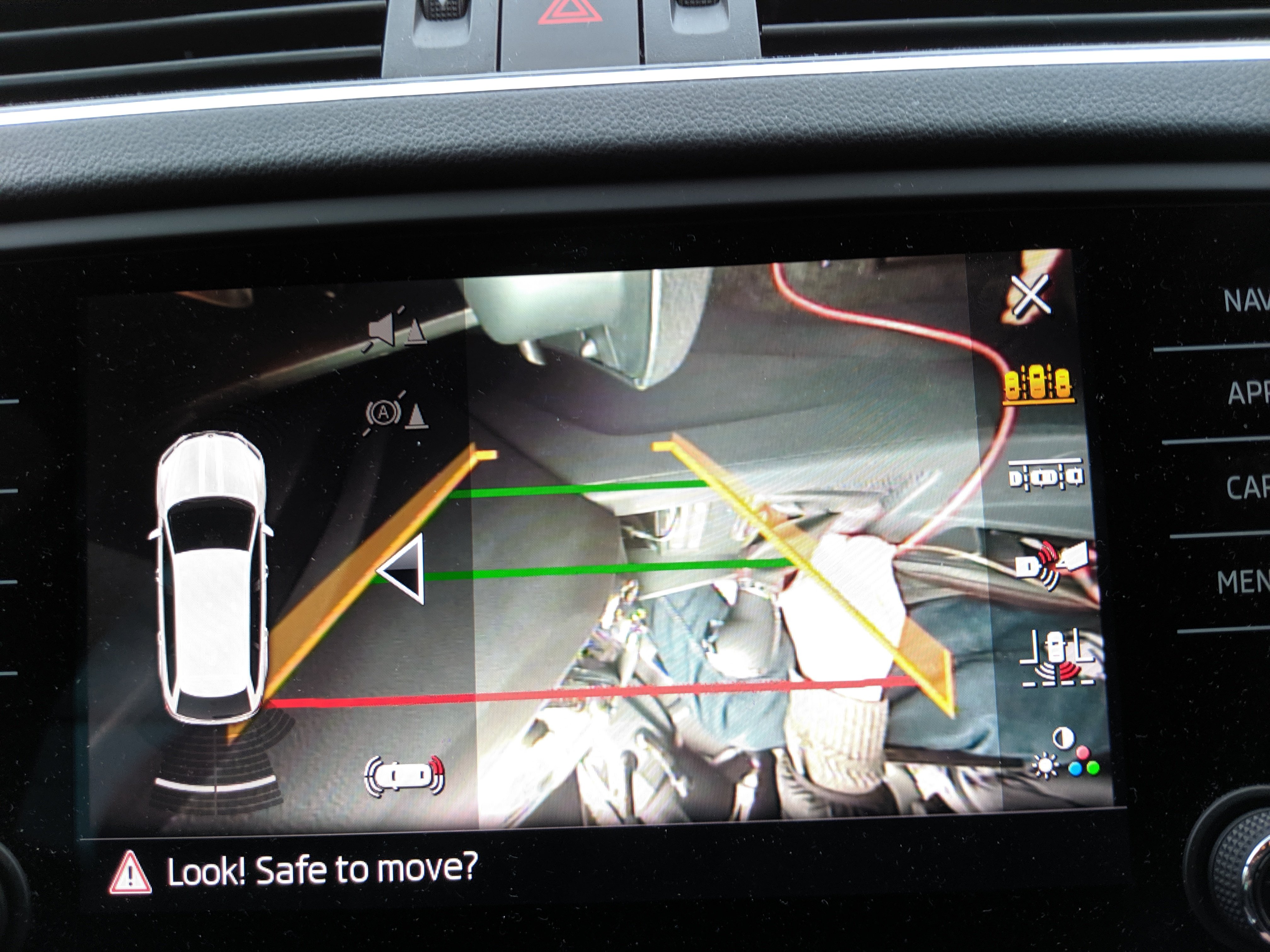

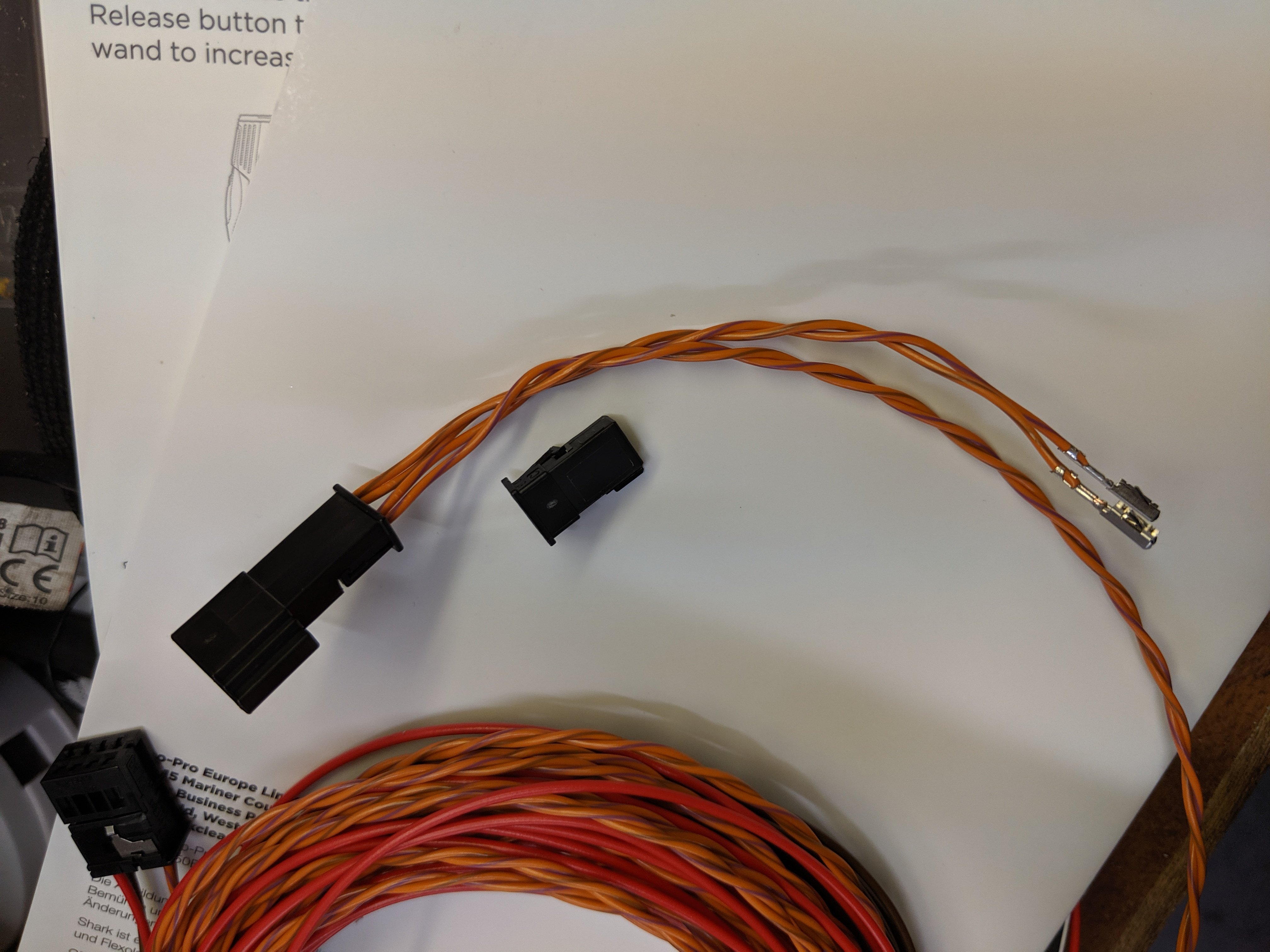

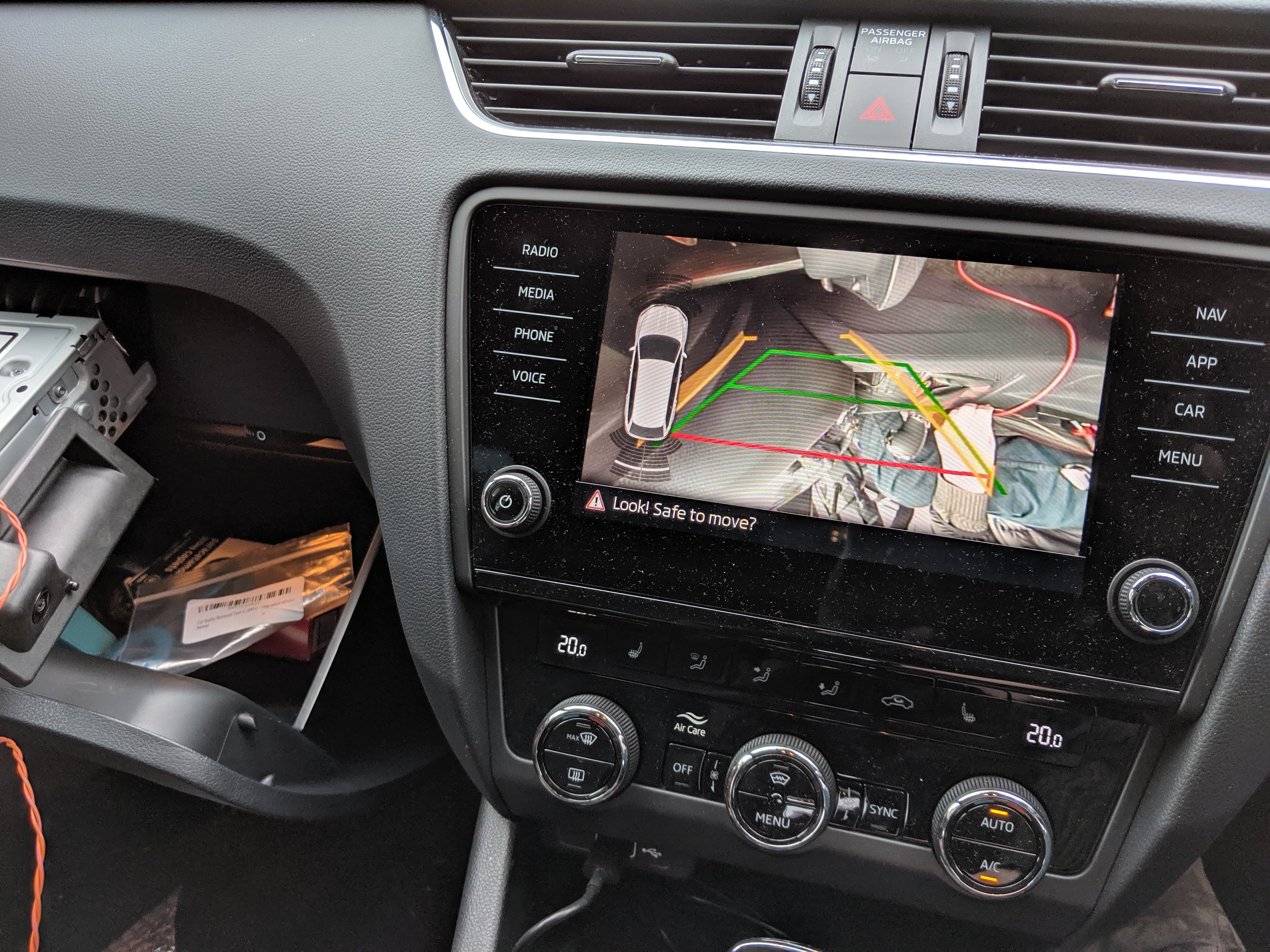

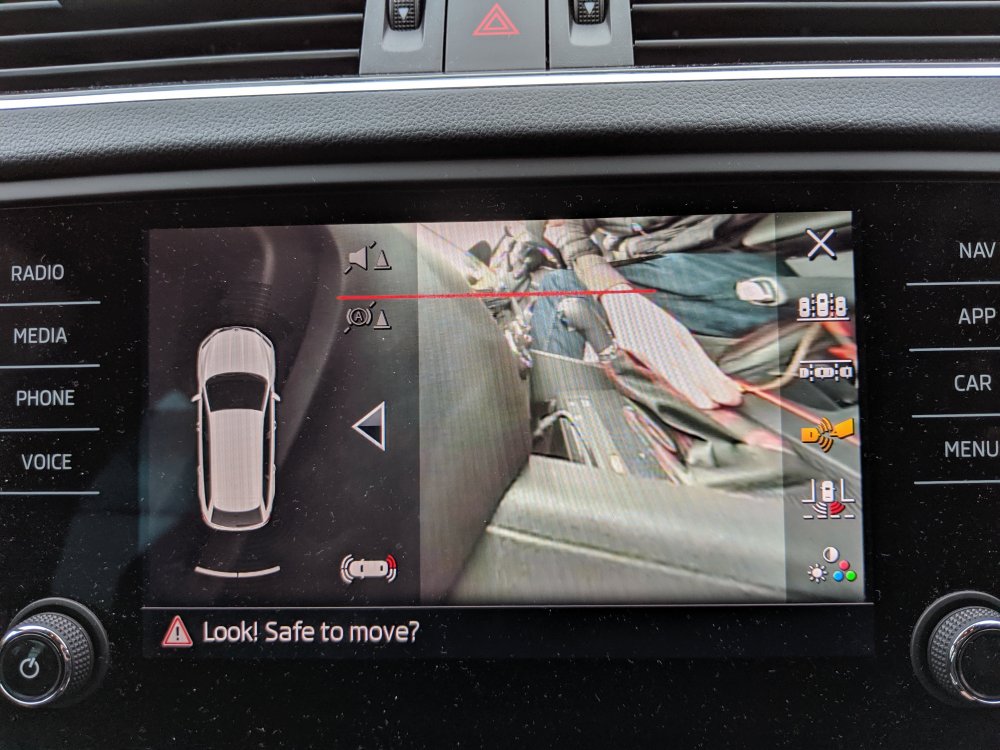

I have a highline camera and loom from the same Hungarian seller and got a chance to connect it up and test today (actually pulling off all the trim and running cables will have to take place another day!)
The wiring should be a fairly easy job for anyone that's done similar retrofits in the past: The loom I received has a piggyback connector fitted for the CAN high and low wires, a ring crimp for the earth and a VAG fusebox 12V connector so it all fits together very well, no cutting or joining cables required. Coding as noted in the file Sasha links to also works for the 3V0... camera I have, including the dynamic lines following steering and the various trailer/camera view modes.
I did pay for the parameter file to be loaded to the camera by the seller.

What function ha this grey connector? What does it mean "add can cables via piggyback"? Which cables are connected into grey connector - video or power?

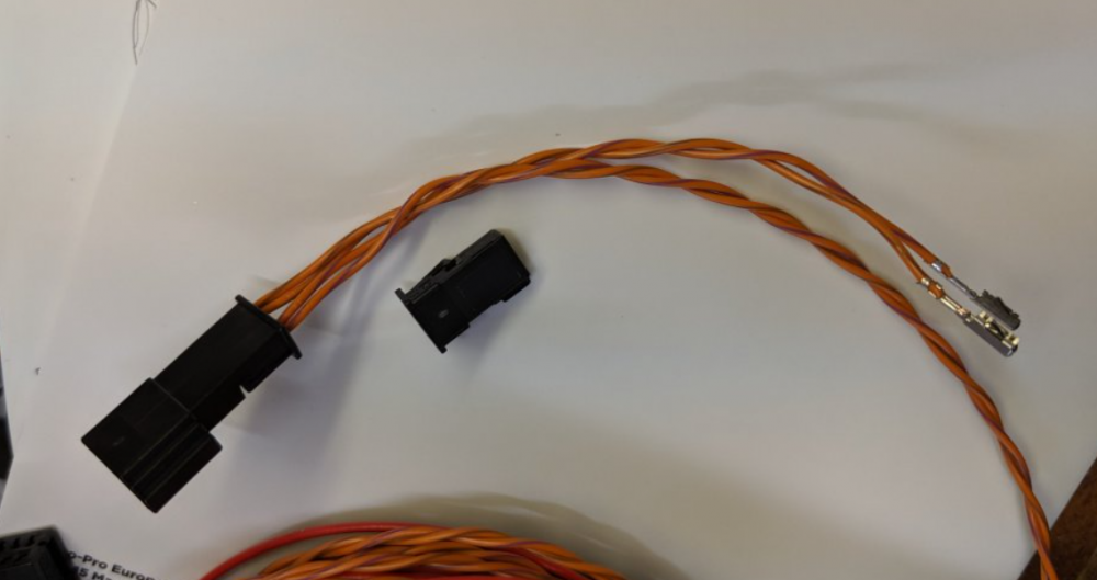

Neither video nor power. Grey connector position 6+12 are CAN high and low, for data communication. With the cameras, this is needed for the superimposed moving lines showing your steering angle.
You will have cables already in the positions you need to connect in the camera loom, hence either you would need to splice in the new ones - or you use the provided piggyback connection. This just saves cutting/soldering cables. You take the existing cables out of the grey connector 6+12 position, latch into the piggyback shown below and connect the leads from the loom into the grey connector instead.

The low line camera doesn't need or have the CAN high/low wires.
Your problem has nothing to do with the wiring. Based on your other posts, you have a 5Q0035819A radio and as Sashagrace told you previously, it doesn't support a rear view camera.
It appears it's missing the video chip needed as mentioned on this thread: http://rapidklub.pl/discussion/1512/mib2-doposazenie-w-kamere-cofania-low-retrofitting/
