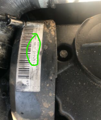

So I will be looking for a model with the BLT engine, if i view a car can this be confirmed either by a VIN or engine number?
In the boot under the lift up floor carpet should be a sticker which will have the engine code (amongst other things) on it. Or check the ECU under the bonnet - LHS of the plenum. If the part number ends NJ its a BLT unit. Or an HPI check will show it. Probably several other ways too!

If there's still an engine number sticker on the upper cambelt cover, it will start with ASZ or BLT according to which it is. Here's one with BLT just about visible (sorry image stolen from ebay listing and not the best).
