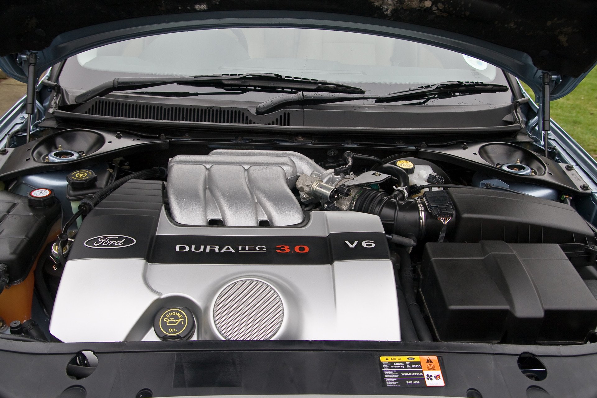

My previous Mondeo estate had quite powerful, fade-resistant brakes of the the same spec throughout the range, apparently.
Yep it used to be a Ford thing although not so much now.
The 1.6 Mondeo had the same brakes as the 3.0V6.

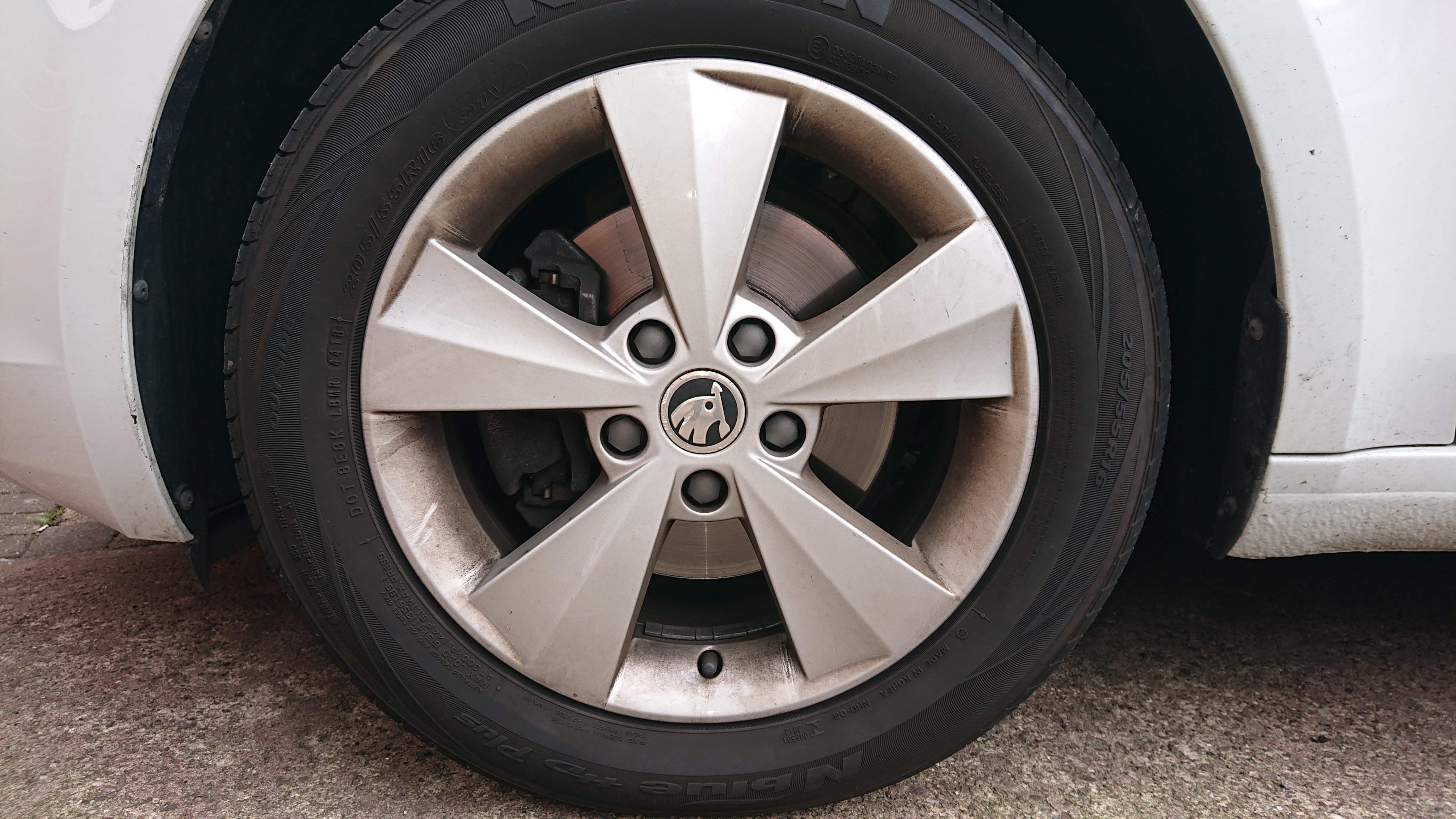

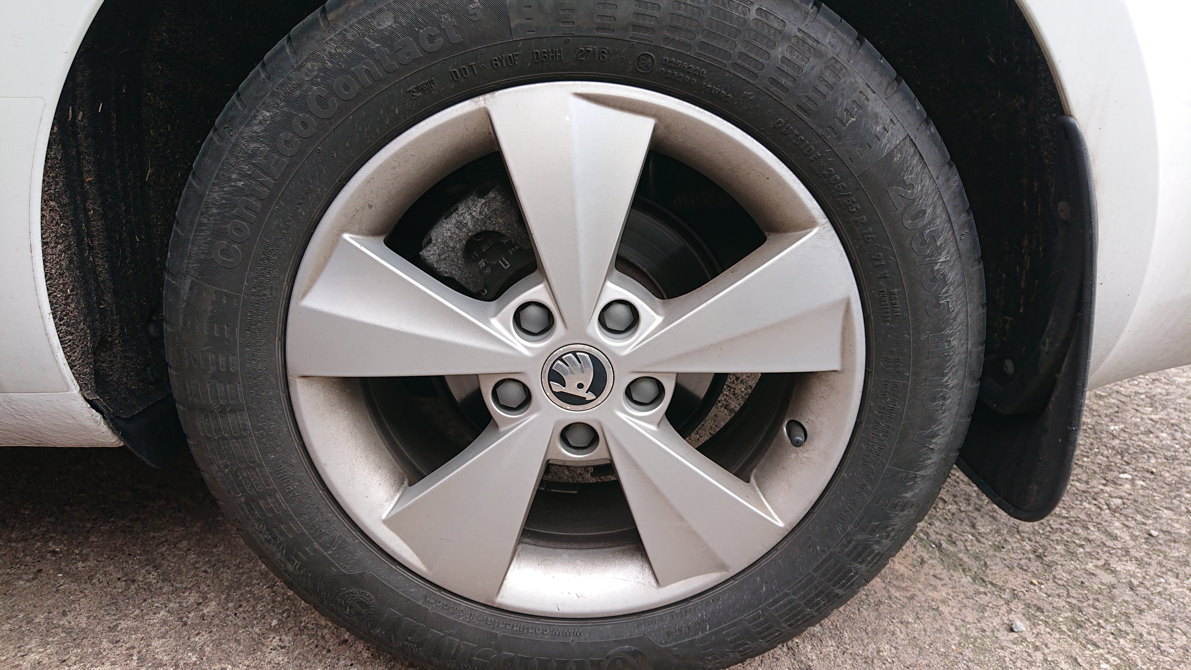

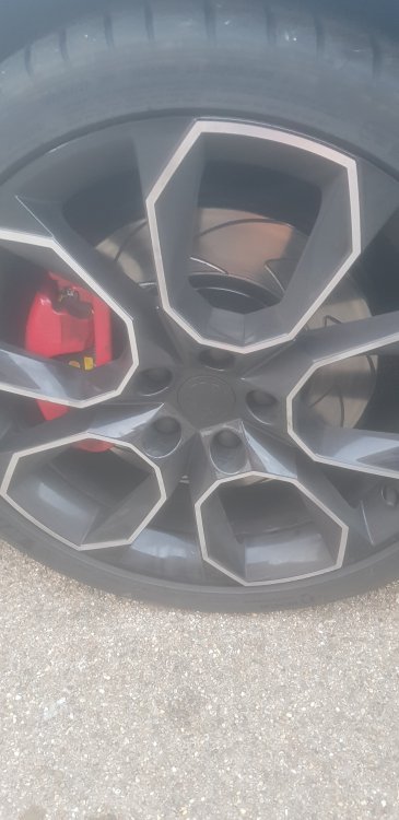

Here are my brake discs
19 hours ago, MC Bodge said:
Is the 312mm front just a case of fitting bigger discs and different caliper carriers with the same calipers?
312 mm calipers are different than 288 mm, changing only the carrier is not an option.
I see that you have velorum wheels - the maximum that you can fit in these wheel is 320 mm.
If you go down this road you have two options:
1. 312 mm from Octavia with 312x25 mm rotor
2. 320 mm from Audi with 320x30 mm rotor
option 2 is the better one because of the increased thickness of the rotor you have better thermal capacity, increased diameter => higher clamping force and the caliper has slightly larger piston. Having driven both options (320 on O3 2.0 TDI 150 hp and 312 mm on O3 FL 184 hp) can tell you that the 320 are better, but they require change of front brake lines.
When you do the mods change the fluid with DOT 4 with higher boiling point, not with DOT 5.1 because the second one has different viscosity which can affect the work of the system.

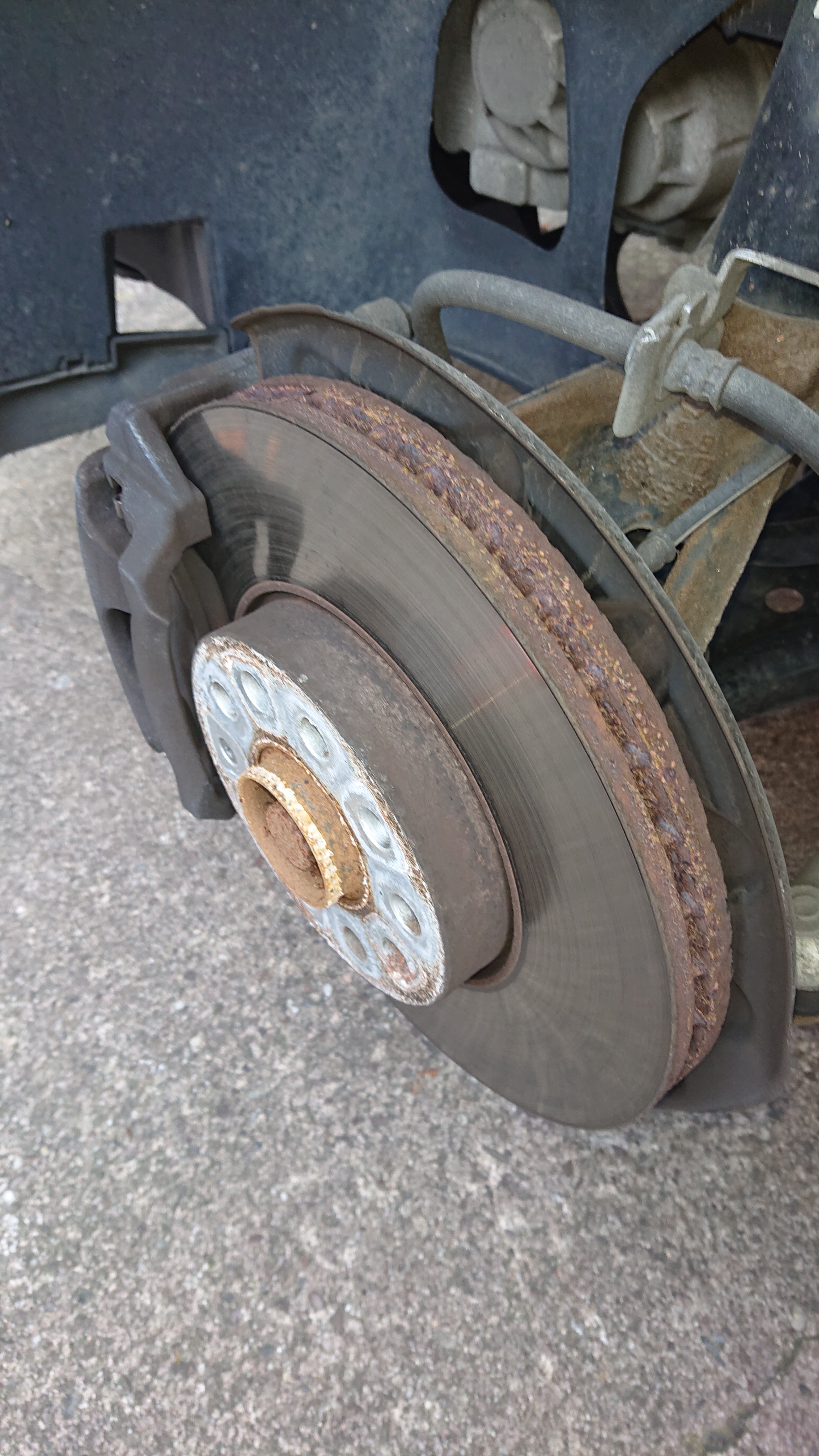

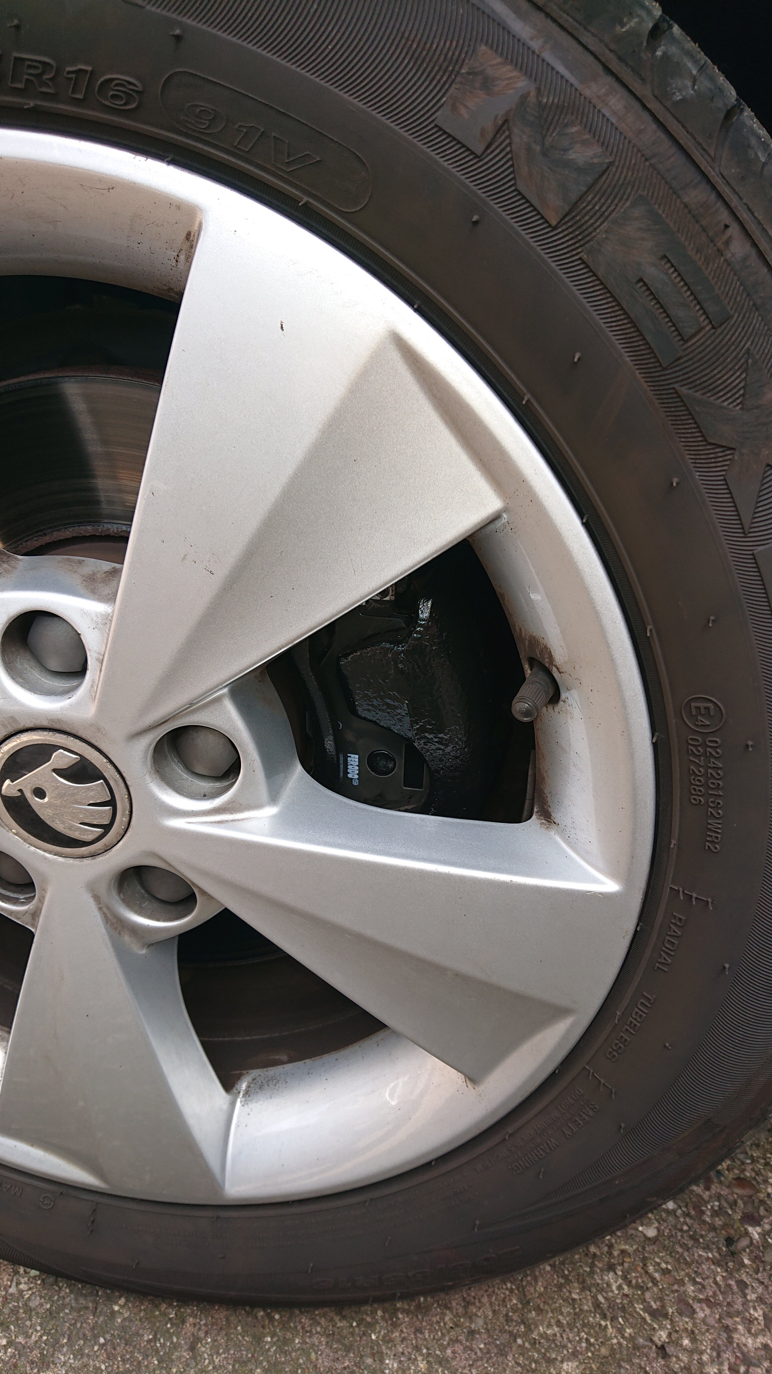

I finally got around to getting the wheels off to fit the Ferodo FDB4433 front pads.
The discs are 288mm vented, which is good news if I do decide to fit the discs and carriers that it should have had from the factory.
The pistons were easy to press back in, the new pads fitted the carriers very well.
I gave the calipers a light paint with black smoothrite to neaten them up a little.
I gave good bite and performance immediately on the bedding-in drive.
I'm tempted to try those air ducts and give the brakes a bleed too.
