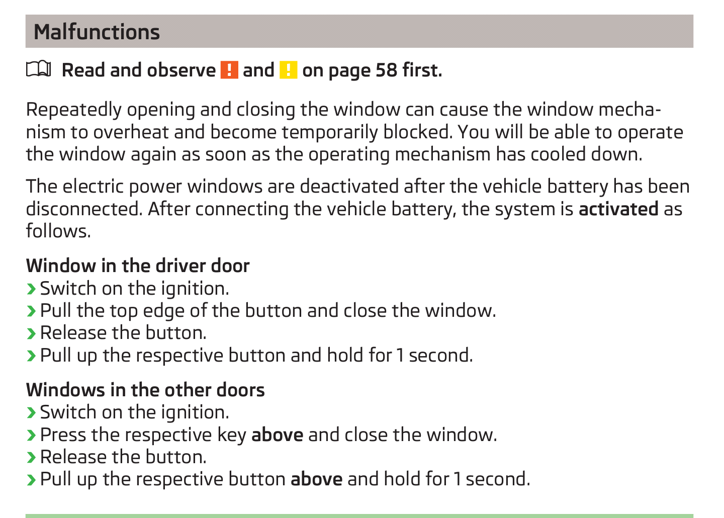

What was the sequence for resetting the windows? I’ve be trying to reset my drivers window no combination seems to be working for me.
From the owner's handbook. P58
You're right. Worked first time!
