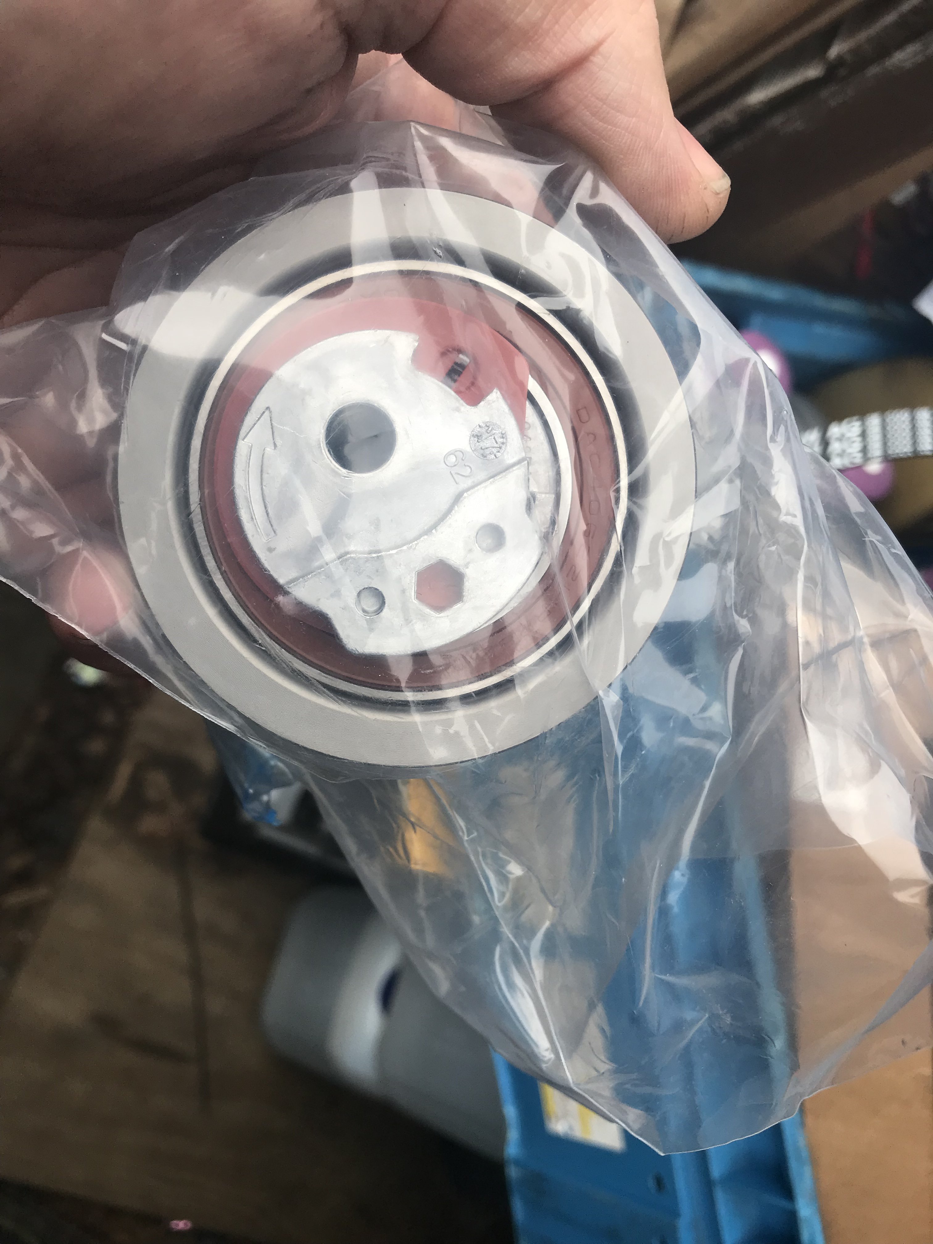

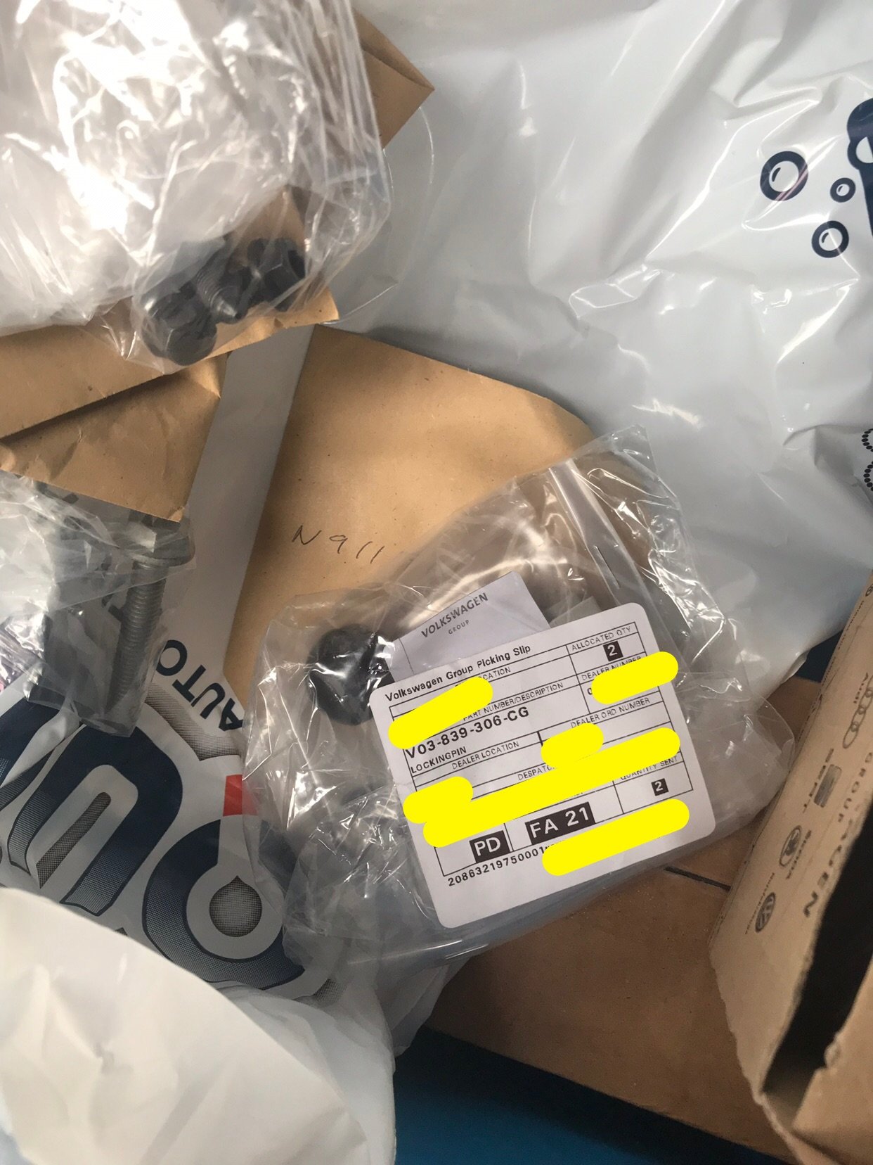

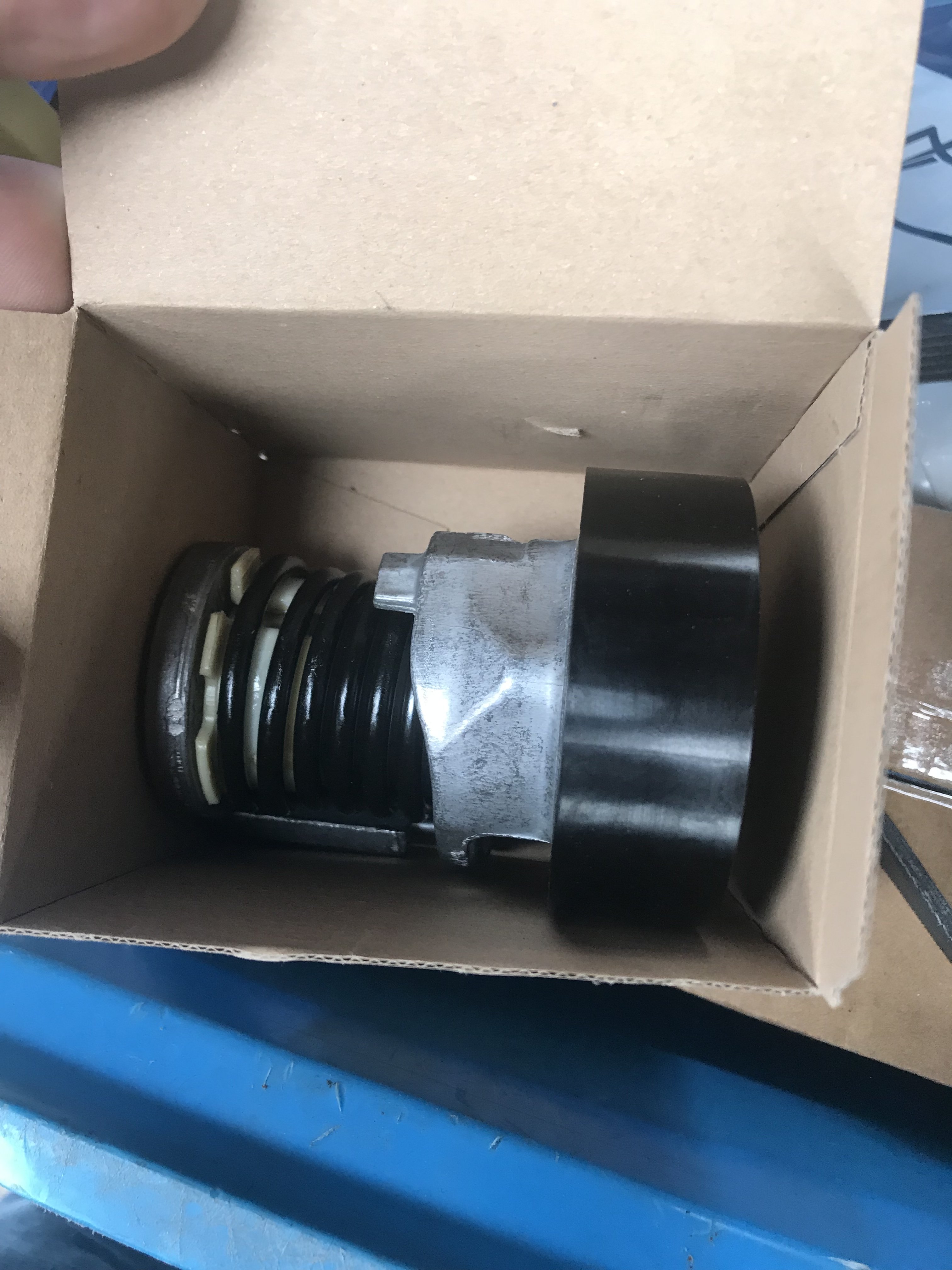

I’ve just bought a kit from TPS, I am changing the water pump, aux belt and aux tensioner. I am also changing the cam belt tensioner stud along with bolts for ; water pump, cam and hp fuel pump pulley, damper pulley aux tensioner and all torque angle bolts for the engine mount and carrier.
I am also replacing the alternator one way clutch. I am changing some things that are not needed, but I want to minimise failures when driving to the Alps.
I have seen plenty of engines ruined shortly after having new cam belt fitted by the little stud through the cam belt tensioner failing either due to incorrect torque or not counter holding during torque of nut.
Not worth the risk in my limited view.
All parts from TPS which guarantees they fit first time and are the latest revision parts.

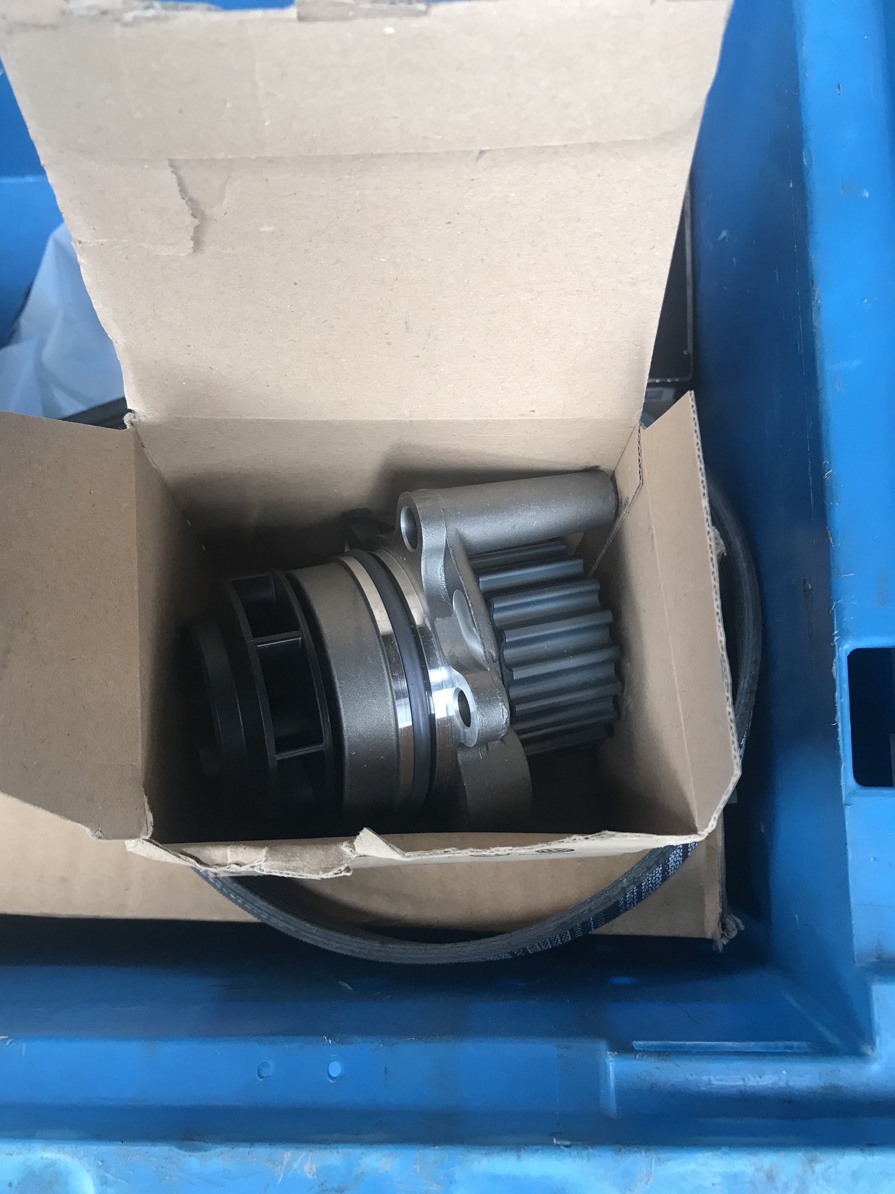

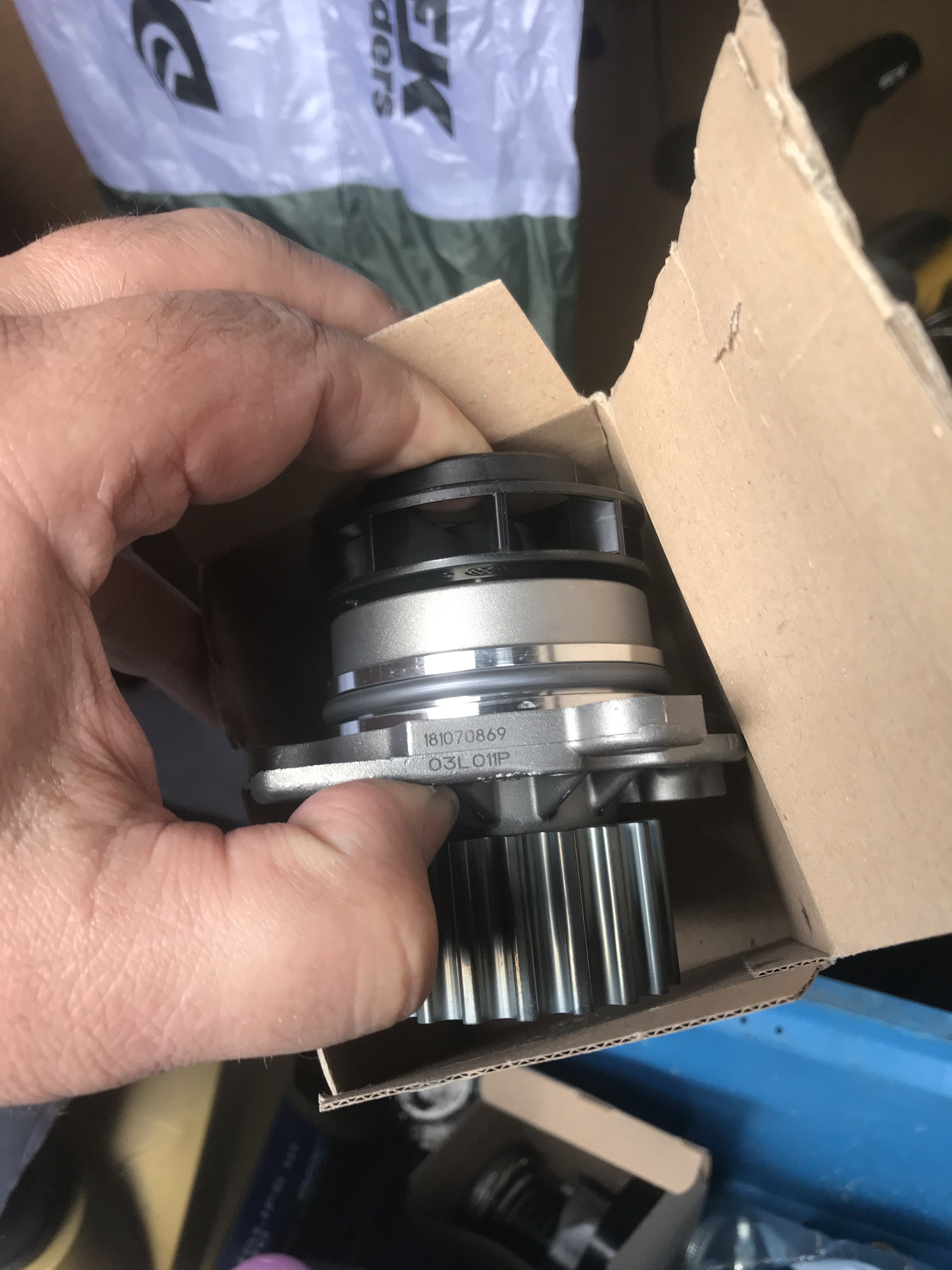

Which version of the pump have you bought?
On 16/06/2019 at 22:50, jafo said:
@3T51704x4
I will let you know when home, supplied by TPS so will be current.  PN 03L 121 011 P built May 2019

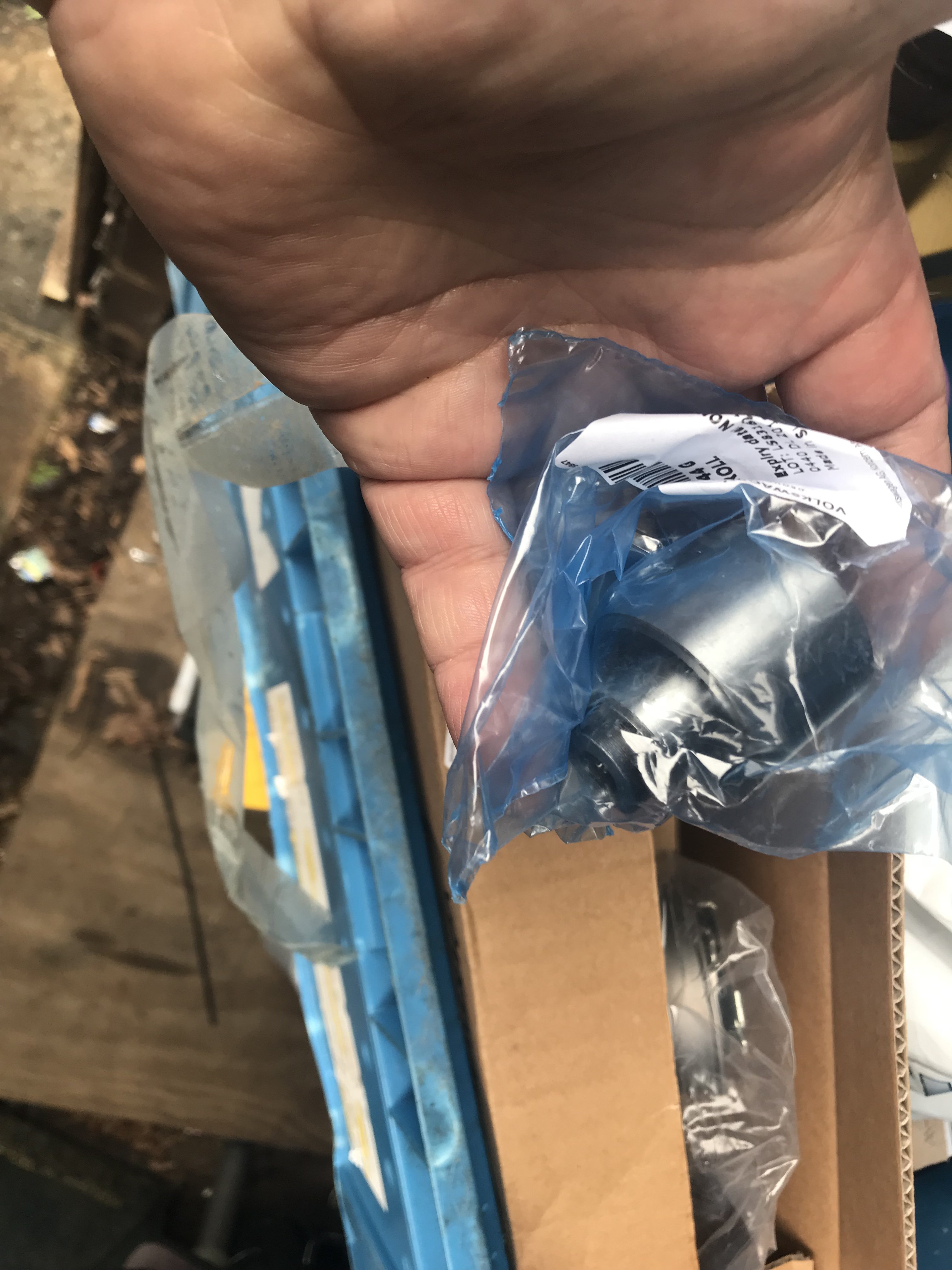

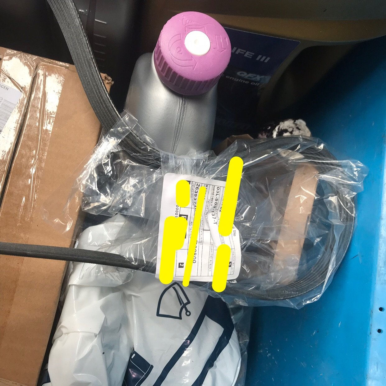

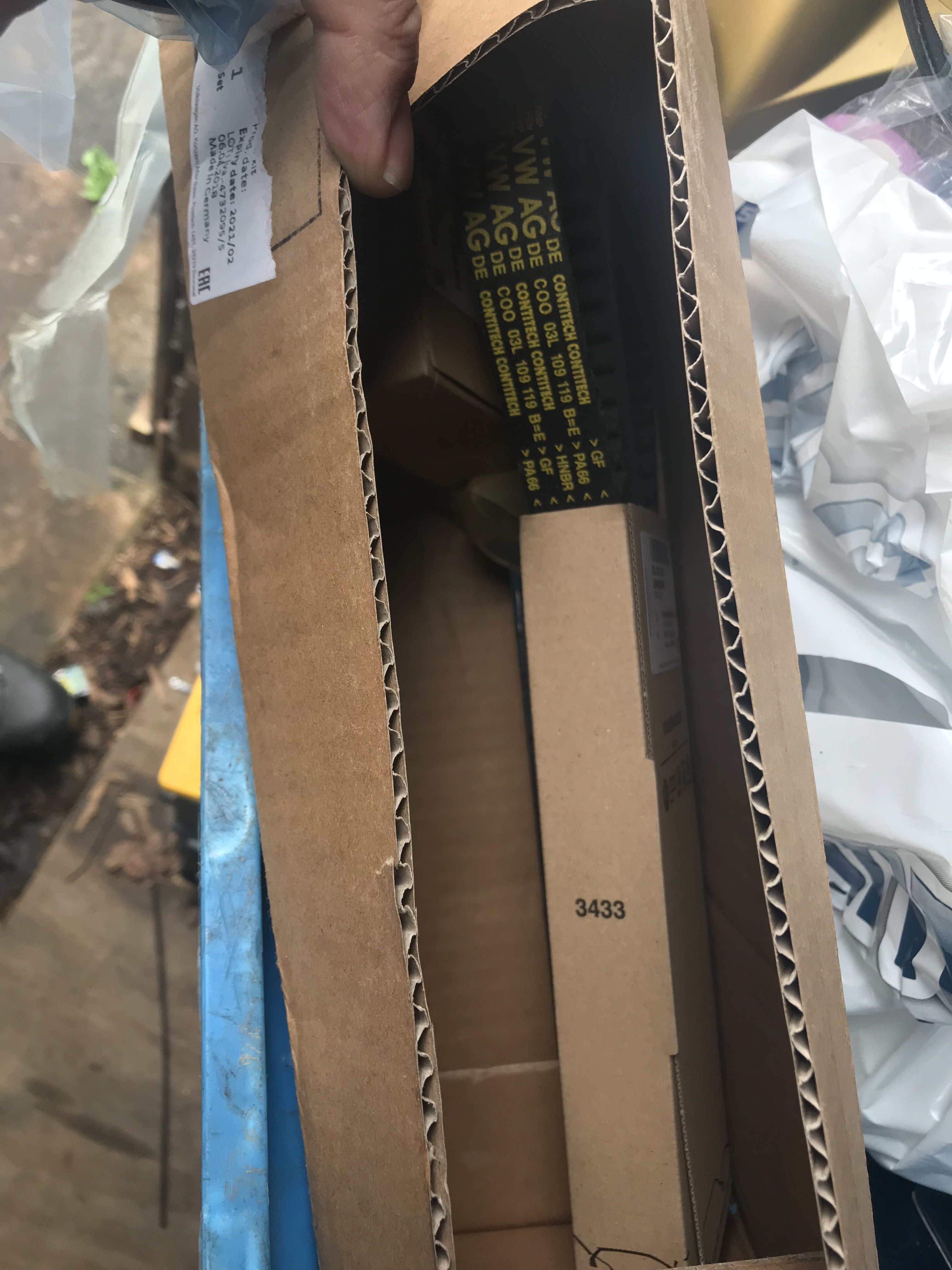

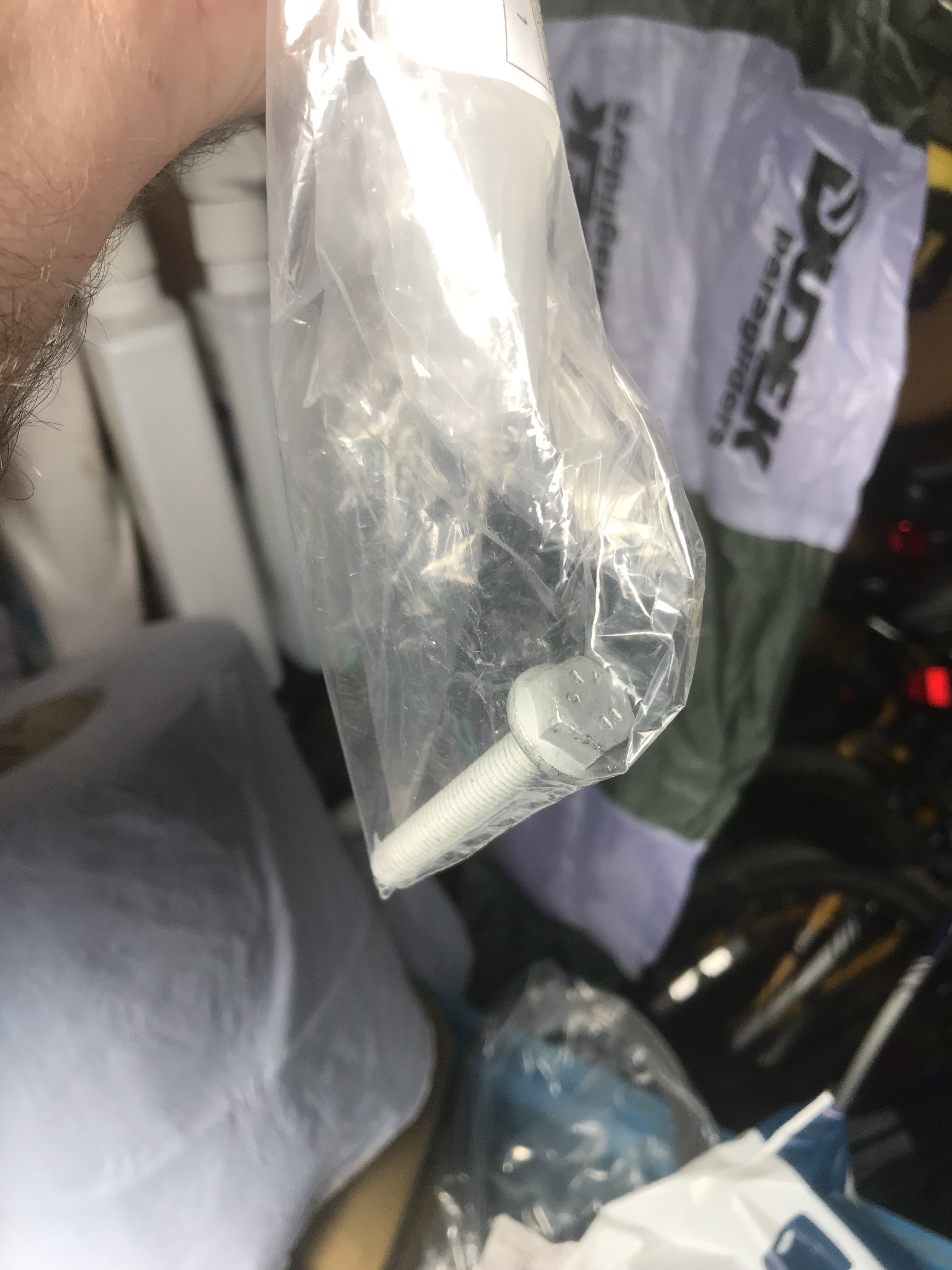

Few pics of the bits I bought:
Edited by 3T51704x4
Add Pics

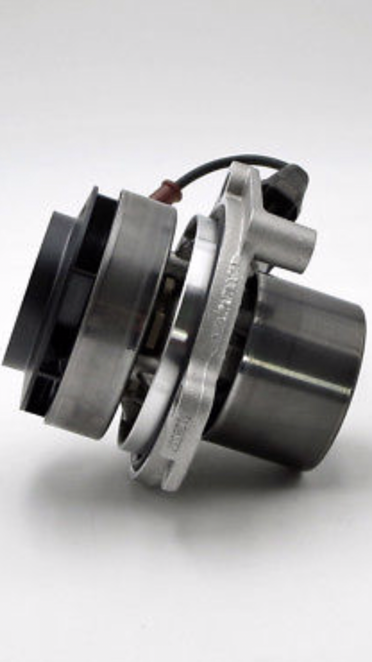

Is it cheaper or more expensive version?
My mechanic said that more expensive one have extra ring or something, that restrict water flow when engine is cold - "electric" version??
My engine does not have that dual stage pump fitted to later cars. Yes that type stick in the closed position causing engine overheating. They have identified the problem and have been revised. Incidentally if one of the dual stage pumps does cause overheating, turn the heater to full hot and keep the revs below 2000 rpm, they don’t overheat then. You may need to open all the windows, but at least you can get somewhere safe.
The dual stage type has a shield over the impeller and a loom to power the solenoid. The idea is to get the engine up to temperature quickly which reduces emissions 😳 and reduces warm up engine wear.

@3T51704x4
Is it worth to pay more - or won't make a difference in UK-Manchester weather?
The later type have a very complex cooling system compared to mine so you won’t have a choice, you will get the pump for your car to VIN.
The later type won’t fit my engine.
Image shows later type:
Edited by 3T51704x4

Hadn't thought about a tensioner for the aux belt, not sure there is one but I will also do the same now that you mention it.
To be honest - I didn't know for sure that there is one either!  What I had written on the work order was to do the aux belt and if it has a tensioner, do that too.
After looking at the ETKA, there is one for for the diesel 1.6 and 2.0 engines (in my 1.6d case its a 03C145299Q). Seem to average €30 to €40 on eBay).
I once paid for a squealing aux belt on a BMW to be replaced, only to find the squeal was still there afterwards. They hadn't done the tensioner...it was actually the root cause. So, like we said above - I'm gettin it done while the labour is already being paid to expose it...
