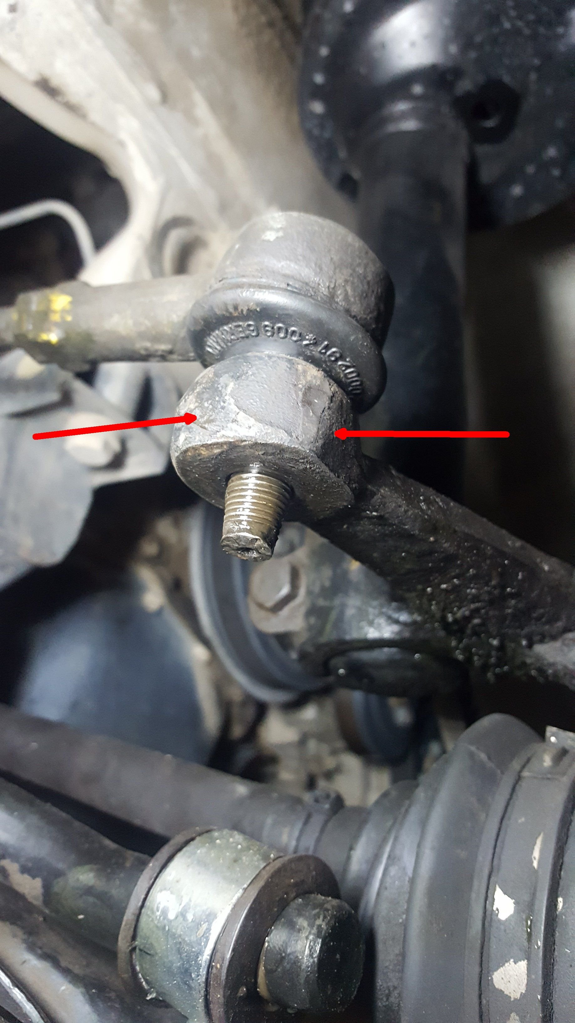

Changed bushings and endlinks of the antiroll bar, tried to change the track rod joints but not reach to remove becuse the conical part dont want to came off. I have 2 "screw exctractor"( dont know how is it call) but none is suitable for the work...neither the big hammer 😅😭🤣🤣... i have a friend to lend another exctractor and i will try again.

Raise the front body on jacks, remove track rod end nuts, turn the steering wheel hard lock to lock to stress the joints. A 2 kg hammer will do the rest. Repeat.

Done what you said and nothing happen 😭😭 tried to use the hidraulic crick too but nothing.....
Well then, if you did everything right so far, yet the TRE didn't pop out, you have only one last solution. When everything else fails, use the RED wrench. It is the generic name for the blow torch. Since you'll discard the TRE anyway, apply a lot of heat on the area shown in the picture (not the bolt!) then smack it with a sledgehammer.
