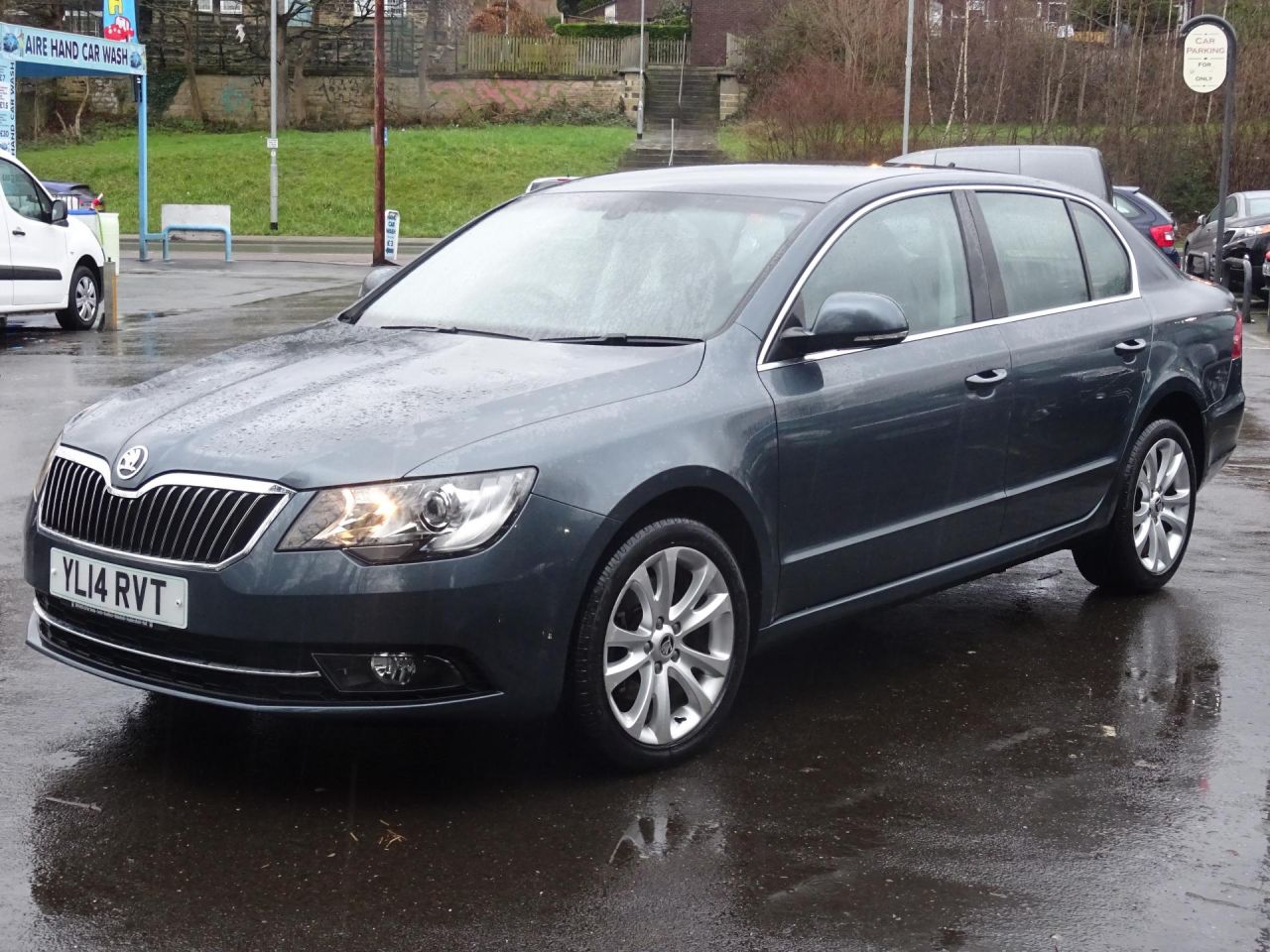

Some clarity needed here, which bulbs are you referring to as "driving lights"?
Dipped headlights or daytime running lights?
Swapping out your DRL's from incandescent to LED's isn't going to make them look any less like fog lights.
This Superb has it's dipped headlights and front fog lights on...
Image result for 2010 skoda superb
This one has its dipped headlights and front fog lights off, so the DRL's are on...
Or do you have the facelift?
With xenon's so LED DRL's in the headlight...
Image result for 2014 skoda superb
Or without xenon's, so the DRL is incandescent, not LED, but still incorporated into the headlight...

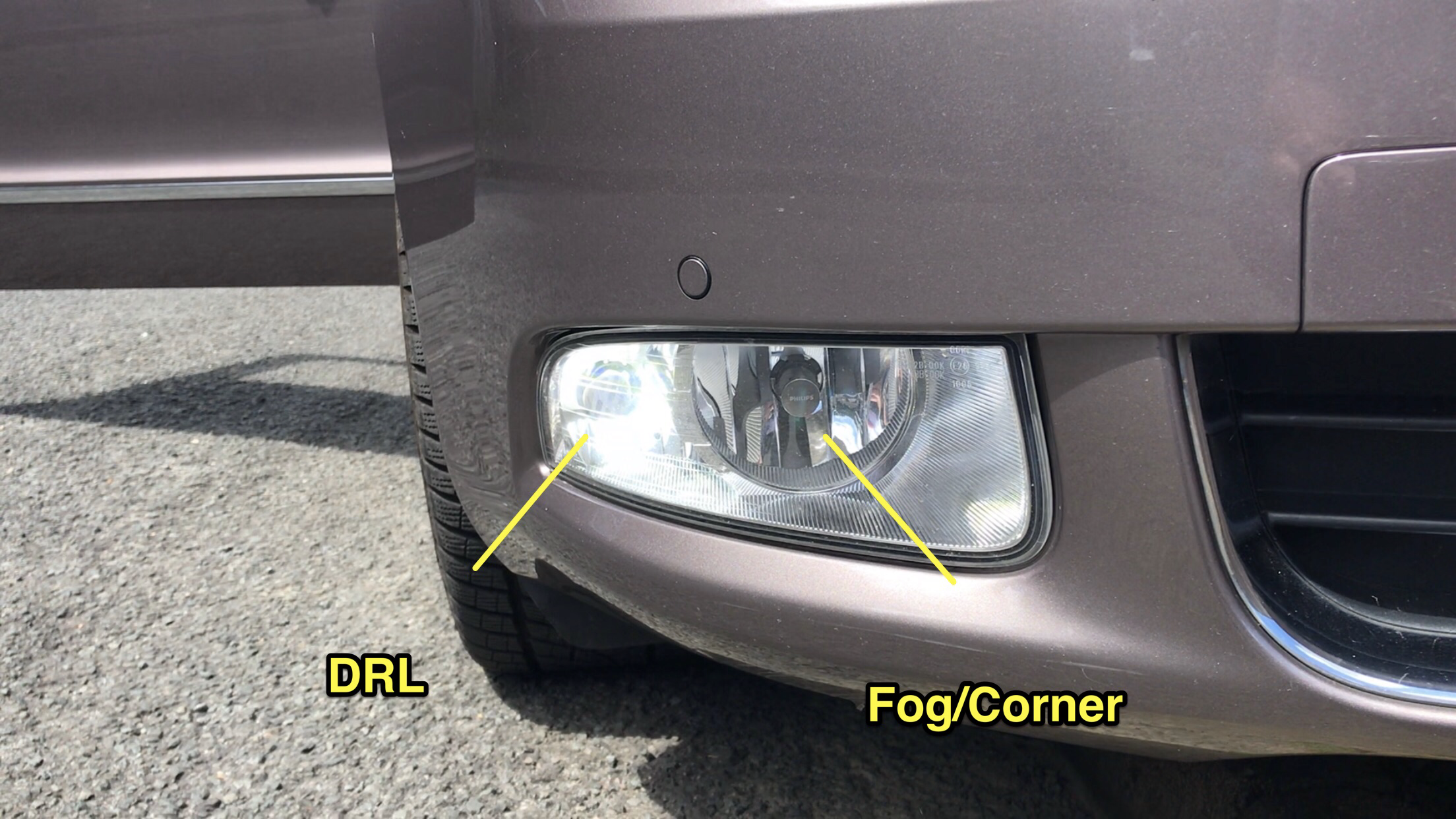

The bulbs linked earlier are P21W. The only light function they'll fit on the front of the Superb is the DRL, so there is no fade in or fade out function.
As mentioned this only occurs on the front cornering fog lights, but the fog lights don't use P21W.
We need clarity on which bulbs the OP is referring to.
If you are after the H8 fog/corner LEDs, I used these which are also on discount. They also don’t bring on the bulb monitor. They don’t dazzle due to there engineered beam pattern and these do slowly turn on and off with the cornering function.
They are suggested to last 12 years unless you have a bird strike 😉
https://www.powerbulbs.com/product/x-tremeultinon-gen2-led-fog-lights-h8-h11-h16-twin?gclid=EAIaIQobChMItPSU0r6B4wIVzLDtCh2ScAkFEAQYASABEgL5P_D_BwE

oh yes you are right, I was thinking of the fogs  /cornering which do fade
sorry

Got mine today, serious but of kit aren't they!
I was surprised how well made they were. The Philips logo needs to be horizontal to get the correct beam pattern. Use small cable ties to secure the driver pack to the back of the light unit to give strain relief on the lead.
I didn’t turn off the bulb monitoring on my fogs, you will get the initial start up pulse on an ignition cycle, (part of bulb monitoring function for the incandescent bulbs).
If you don’t like that, just turn off the monitoring but will need some sort of diagnostic device.
Enjoy!
