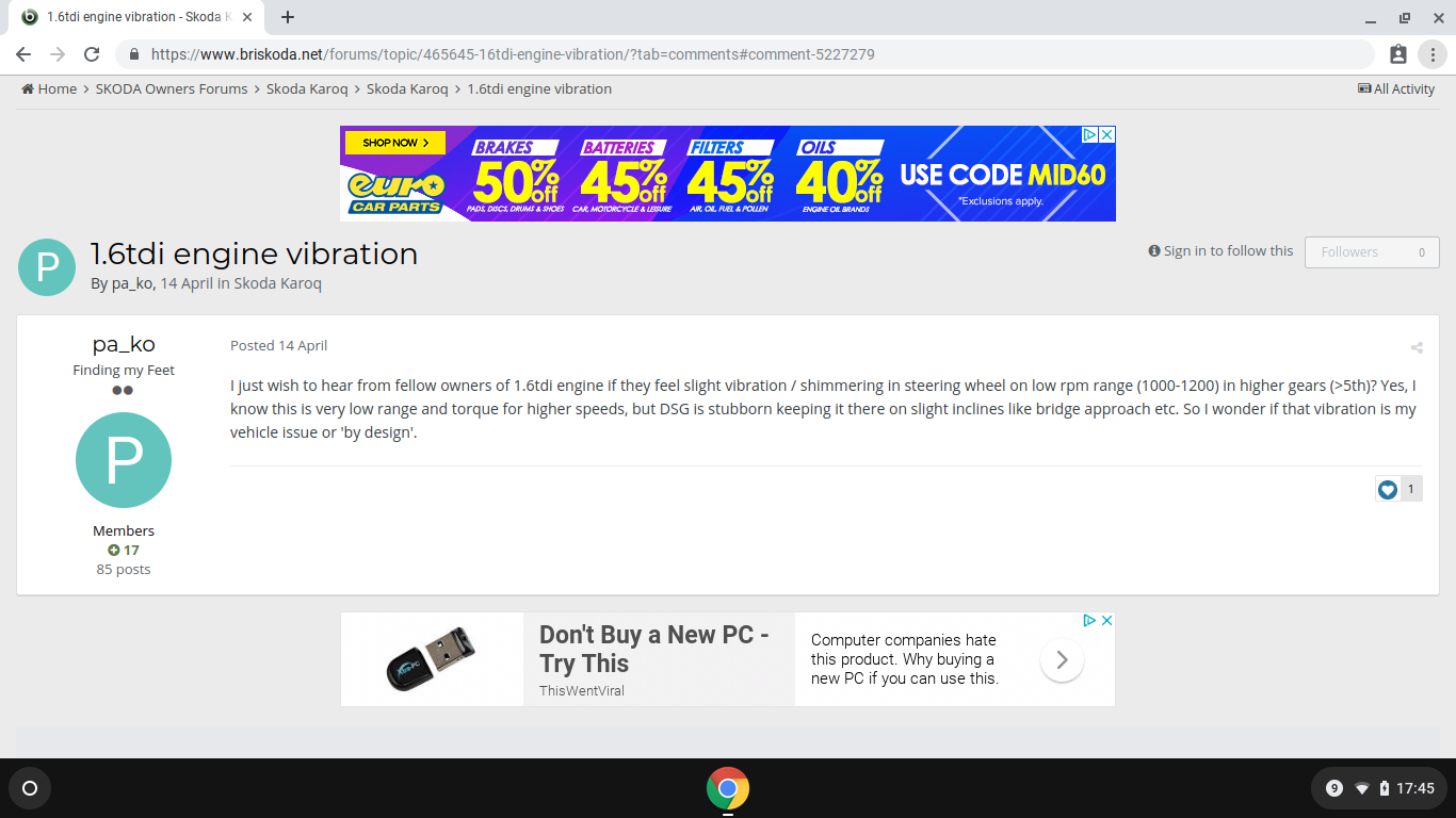

Anyone w. DSG experience engine vibration as result of DSG keeping high gears on low rpms? I feel vibration while driving on slight inclines. Speed around 40mph and DSG keeps in 6tg so engine is running around 1200rpm. And if I keep foot steady on acc pedal, DSG is stubborn holding in 7th and low revs.
In general, I experience DSG downgrading too early e.g. stubborn on low revs around 1200rpm. So engine is not powerful enough and thus shaking not too much but noticeably in steering wheel and chassis.
@pa_ko
Sounds like an issue that is not a characteristic or as designed by the engineers.
I would get that checked out, and maybe get a drive in an identical car to yours to compare then when you are told 'they all do that', you can say No way Jose.
Some of these modern thingummies "learn" your driving technique and sort themselves to suit your style. Maybe drive to make 'progress' as they say. Or switch to standard or sport mode if you're in eco.
When I had one as a courtesy car I found there was a lack of acceleration, particularly in city use, and had to keep changing down using the paddles as it was in too high a gear, to get it to go, and I'm not usually a fast driver. Never had to do this with my 2.0 diesel DSGs. Obviously designed for economy rather than practical driving.
Yes, you can get round the tardy performance by using the paddles or Sport mode but it rather takes away the advantages of going for a DSG, certainly in normal Drive mode.
Exactly. What is point of DSG and it's 'intelligence' if you have to downshift manually too often?
I find it very unpleasant experience. It doesn't need too much AI to figure out to downshift earlier. I hope they will update DSG software as I believe it is a problem of that 'intelligence' part. 1.6 TDI in Karoq has no balancing shaft so it is vibrant on low RPMs and DSG intelligence should be intelligent enough to keep it out of vibration rpm range IMHO...
