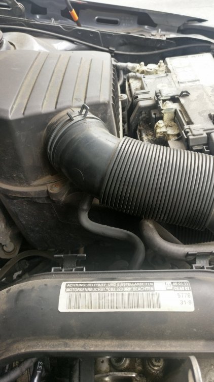

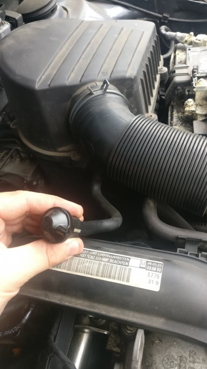

I kept looking around the fuel inlet and found a hose that is not connected. I found where it goes in, but as it has a broken connector, it is  very loosely connected. Tried to look through repair manual what the part exactly is called but couldn't find it, nor could I find any pipes that fit the criteria being sold on different online parts stores.
Is there anyone who would know what this part is in the attached picture? The plastic part can be removed so perhaps could just buy the connector and not the whole hose.
Found the part and already now fixed! No more petrol smell feels good.

Sorry for not clearing that up, that is the PCV valve, it controls the volume of air being drawn through/out of the engine casing.
