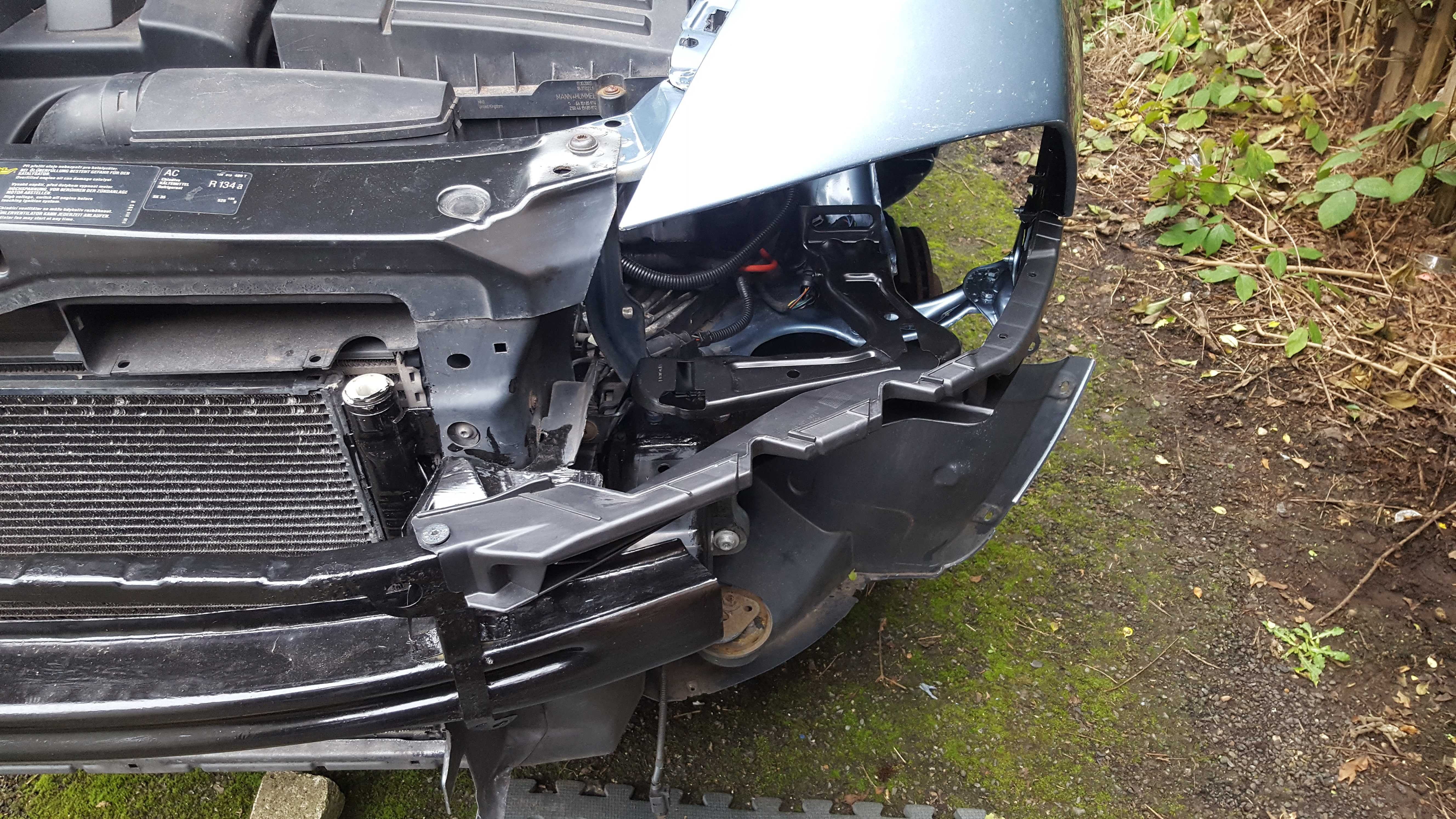

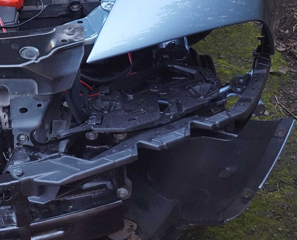

These photos are of the under-wing on our Octy whilst I was fixing its bruised nose:
01 nsf under-wing with bumper removed showing old headlamp mount and bracket (damaged)
796245571_01nsfwithbumperheadlampmountremoved-20180812_151612.thumb.jpg.11a3b87c847ba291b1714d20fe40f71e.jpg

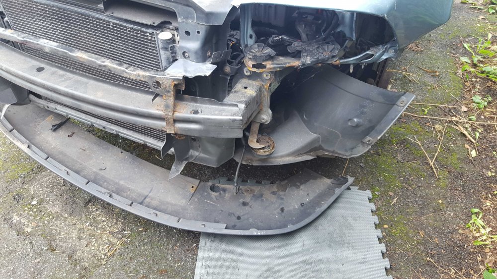

02 nsf showing new headlamp plate installed
1454020341_02nsfshowingnewheadlampplateinstalled-20180919_174000.thumb.jpg.beceef914f9dbd8847dec4662416b873.jpg

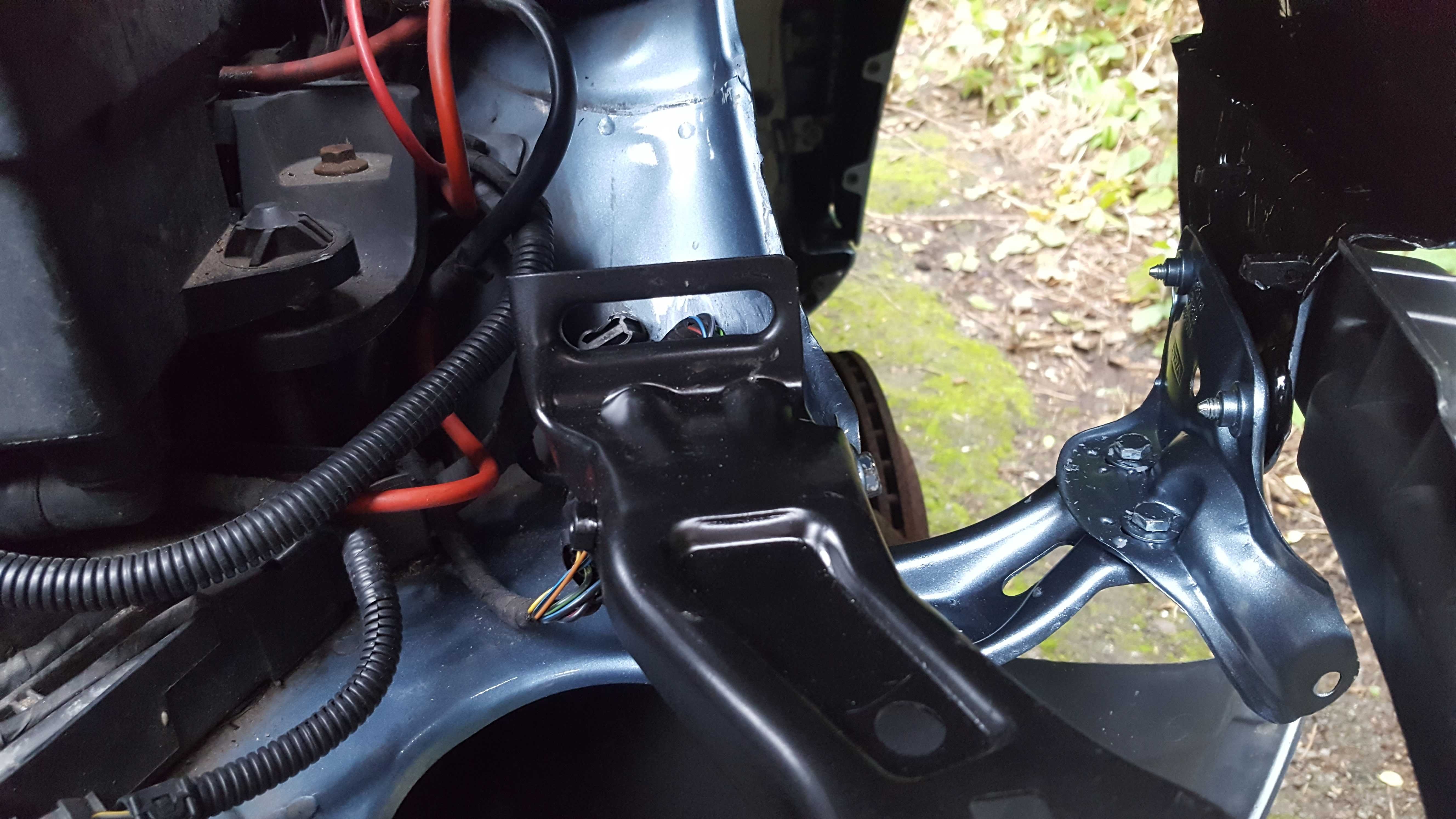

03 nsf closeup of new headlamp plate installed
2078666210_03nsfcloseupofnewheadlampplateinstalled-20180919_174017.thumb.jpg.ac3efbbc70bd0026f106447030cb6b24.jpg

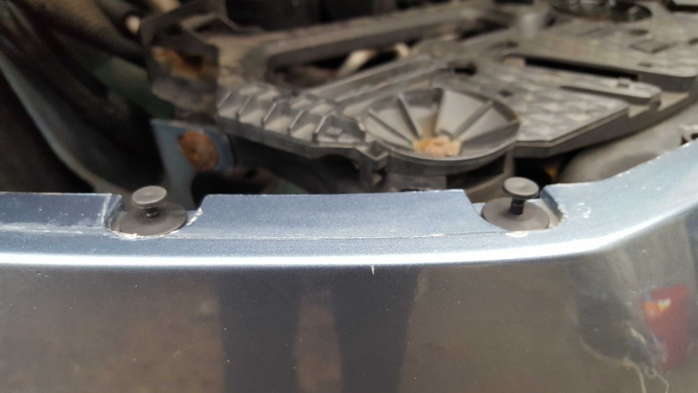

04 nsf closeup of rear mount of new headlamp plate installed
379049491_04nsfcloseupofrearmountofnewheadlampplateinstalled-20180919_174027.thumb.jpg.774aed0a7f3c5c2a95da87bb4926b89a.jpg

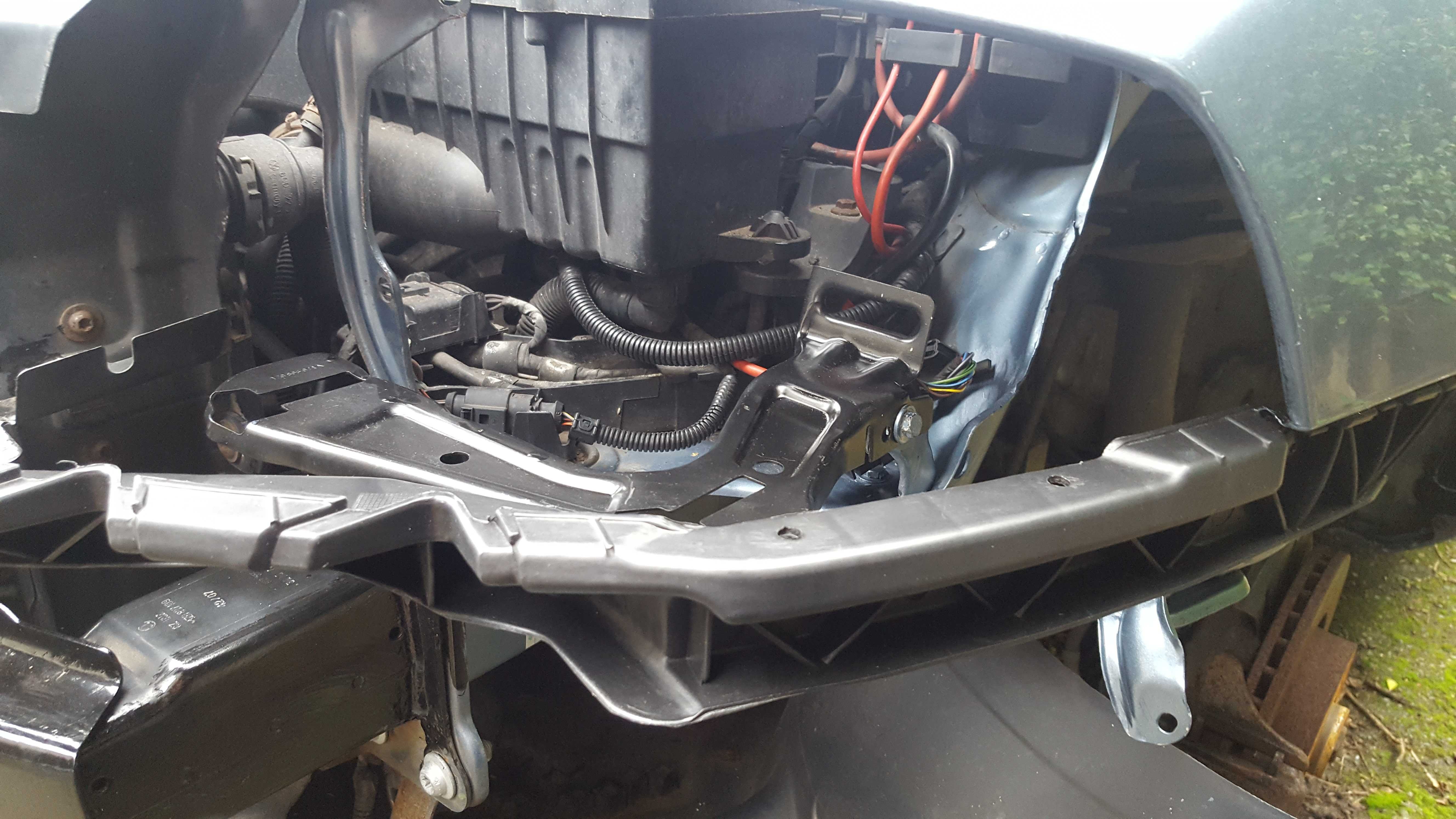

05 nsf closeup of headlamp plate and mount
678216248_05nsfcloseupofheadlampplateandmount-20181006_155310_cr.thumb.jpg.0b2db5648d8cbf17d4838fe17dcd2f27.jpg

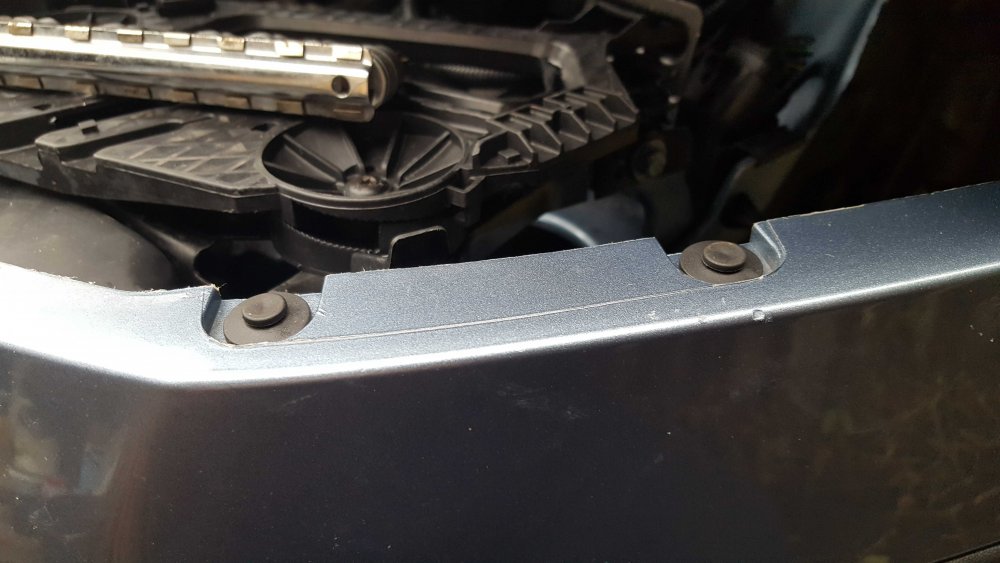

06 nsf closeup hl mount in place
1202072449_06nsfcloseuphlmountinplace-20181008_161153.thumb.jpg.8bbebffcfda976355e3690abbf437f18.jpg

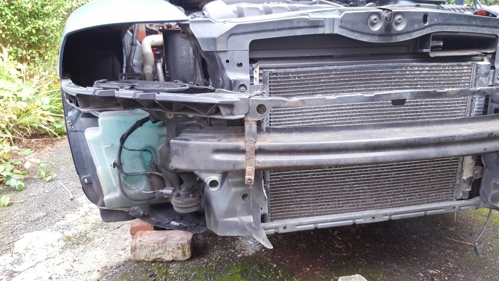

Now a couple of the in-place osf mount FYI
07 osf showing headlamp carrier in place - note factory-approved brick
424955865_07osfshowingheadlampcarrierinplace-20180818_173939.thumb.jpg.22590bee9d9c22e90ad1e3d007ee7297.jpg
08 osf closeup of hl mount on plate in situ
480881915_08osfcloseupofhlmountonplateinsitu-20181008_161112.thumb.jpg.7a959e62f990517bd5e95c00011da156.jpg
