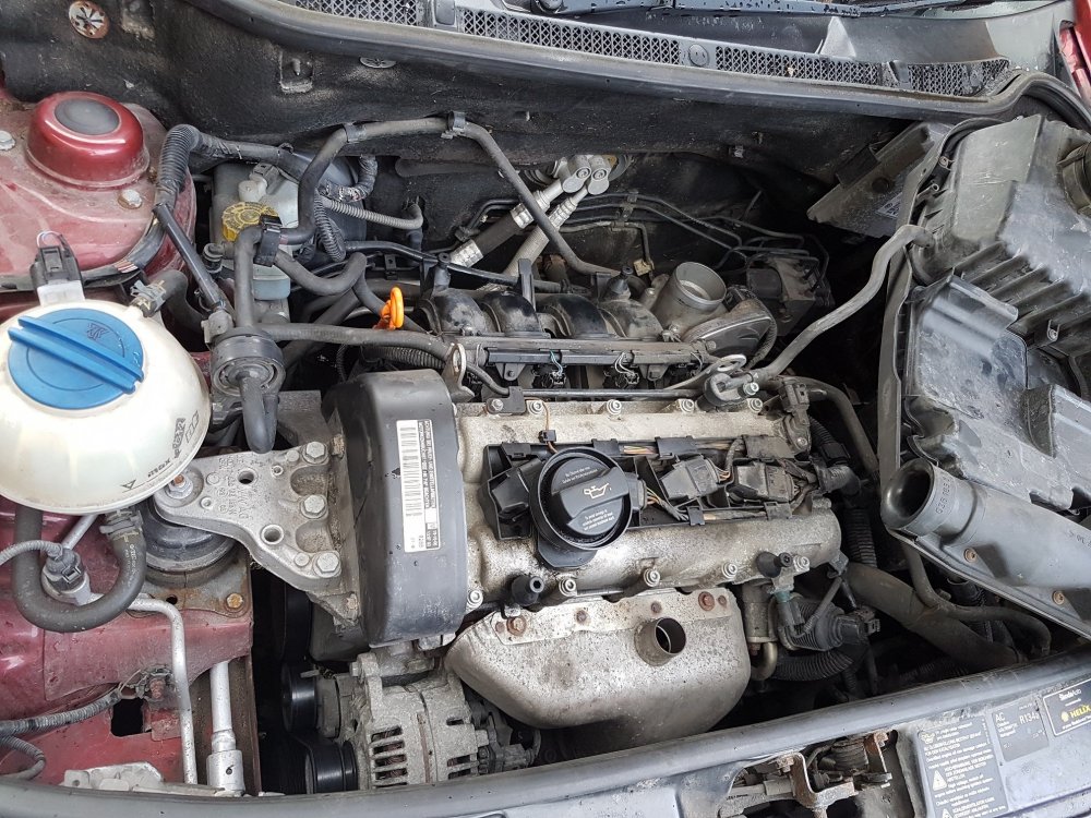

The engine  doesn't seem to rev above 1500rpm ( I think this is what the wife is calling "limp-home mode") . It also idles erratically. I thought I'd include a picture of the engine as sometimes it can be tricky for people to know exactly what sort of car you have from the description (well, I find it tricky).

The EGR valve is ringed in green in this copy of your photo. Wouldn't expect it to be relevant to your current faults, it tends to get its own fault codes.
The pipe I've added a few red lines on is the brake servo vacuum hose. these have a nasty habit of splitting at the terminations of the hard plastic sections, and causing air leaks.  Often these splits are on the underside, out of sight. Feeling with fingertips or photo capturing with phone camera are alternative ways of checking for this.  Either side of the non-return valve just to the right of my last red line is a 'popular' fail site.

All of your engine codes and the rough idle and limp mode could be caused by just one split in the brake servo vacuum pipe so a rough visual inspection will not suffice.
You should also check that the alternator is working properly by checking the output voltage, it must be 14.4V +/- 0.1V, no other value will do.
Wino and sepulchrave. Thank you very much for your prompt response and stunningly accurate information. I've found the break servo line split exactly where wino said the common failure point was. I've wrapped some duct-tape around the split pipes to check this was the only issue and the error codes have vanished. I'm off to the parts dealer on Monday to return the MAP sensor and purchase a new brake servo hose.

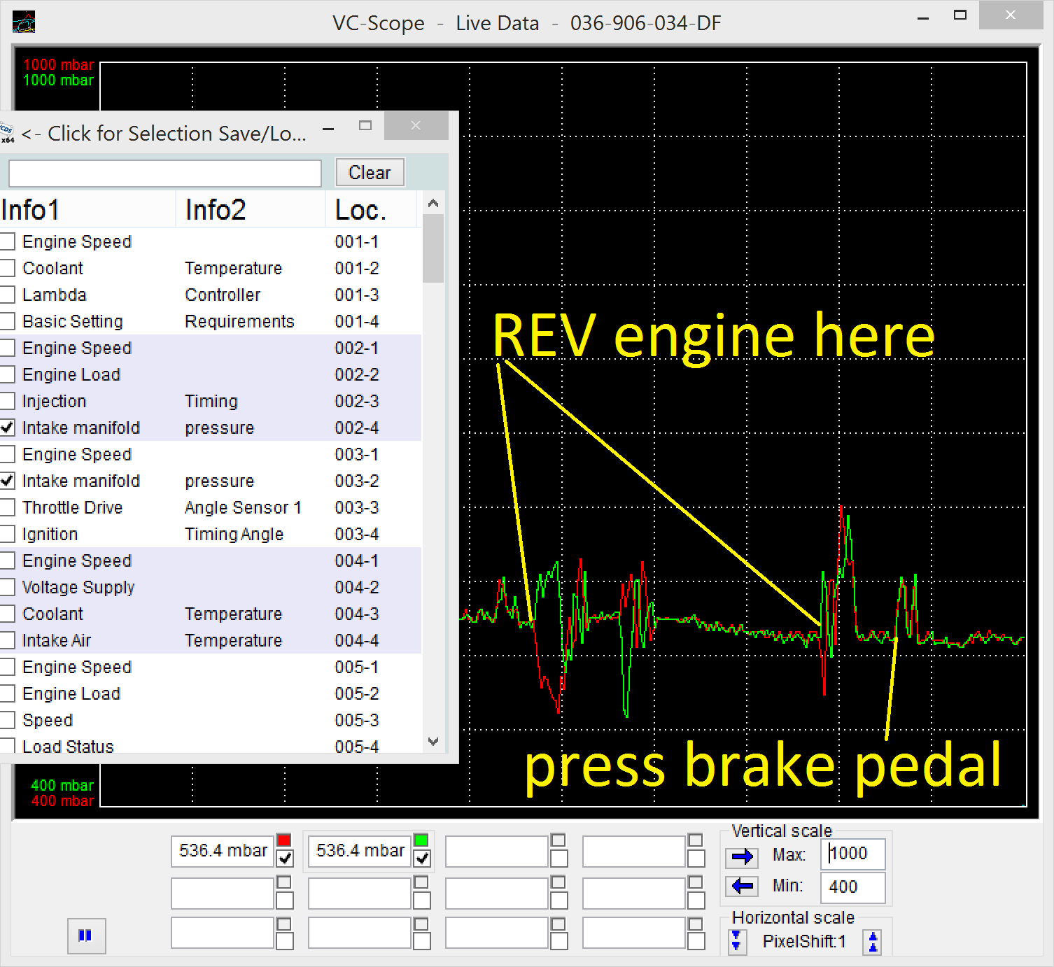

I assume that if the engine reports "Implausible Correlation" then there must be 2 pressure sensors and one of them does not agree with the other. I've used the graph capability within VAGCOM to plot the two pressure outputs I could find. Does anyone know which of the two "intake manifold pressure" readings relate to which sensor?
The other end of the scale is 1000mbar.
There is only one MAP sensor, you may have a manifold leak since there is no other plausible source for it now that you've fixed the vacuum hose.

I've checked the voltage at the MAP sensor. 5V for the two inner pins and 0V for the two outer pins.
I removed the MAP sensor and attached some hose over the sensor. I plugged in the VAGCOM and measured the Intake manifold pressure (the two in the above picture). By sucking on the tube I created a partial vacuum. VAGCOM reported that the pressure dropped and both values almost simultaneously. I think this means the MAP is OK. Suggesting that there is a leak somewhere.
