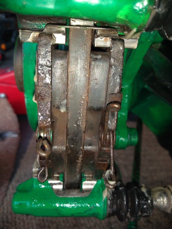

There is 2to3mm more wear on the outside brake pad than the inner one. See photo
Having trawled internet outer brake pad wear is stated as due to the slide pins seizing. This fits my symptoms.

Btw the pads have worn evenly just more on the outer most pad.
