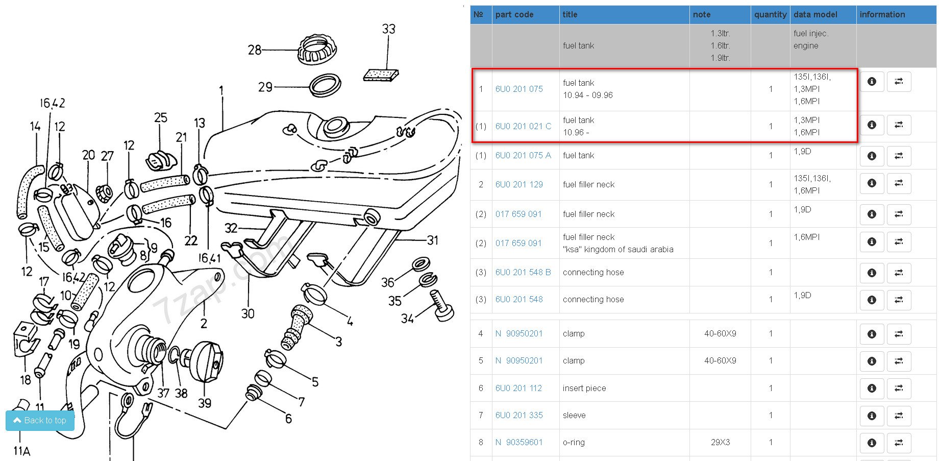

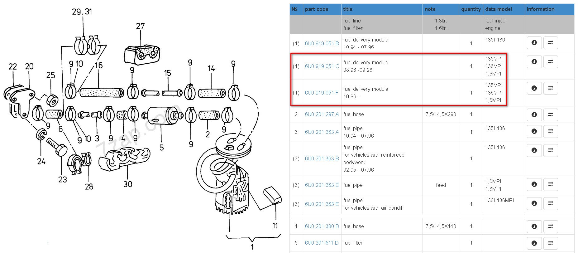

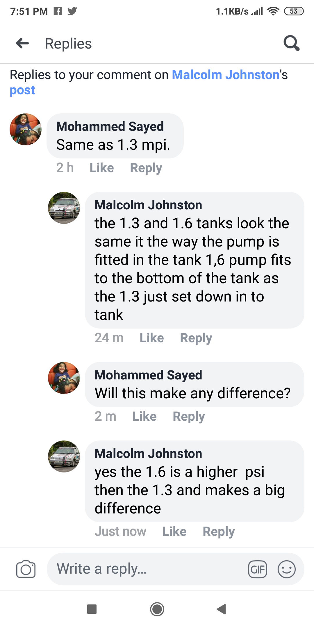

What are the differences between 1.3 mpi & 1.6 fuel tank and pump?
So, no technical differences?
No differences between MPIs. Only SPI has different (lower pressure) fuel pump.
