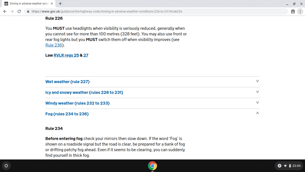

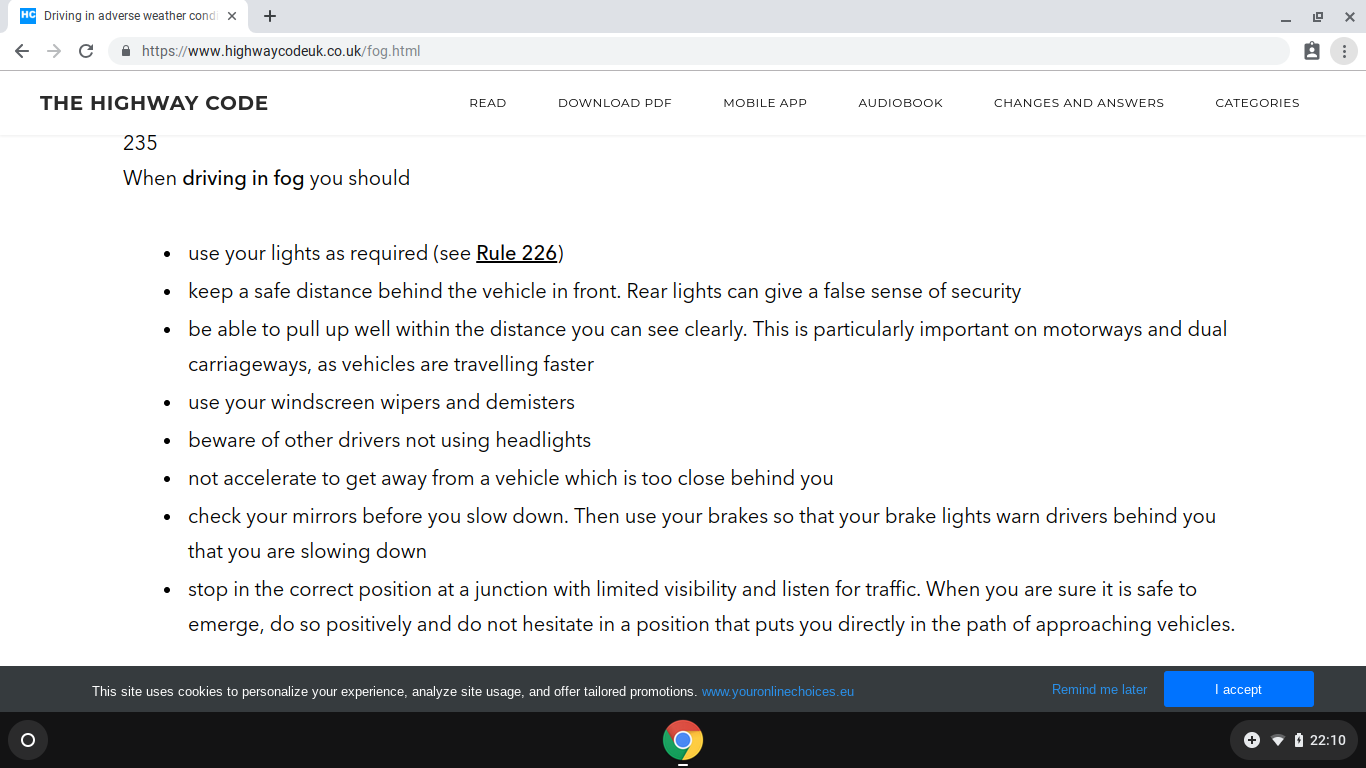

The Highway code does have a Grey Area where it say referring to 226 and the
'Use your lights as required.'
Edited by Roottootemoot
