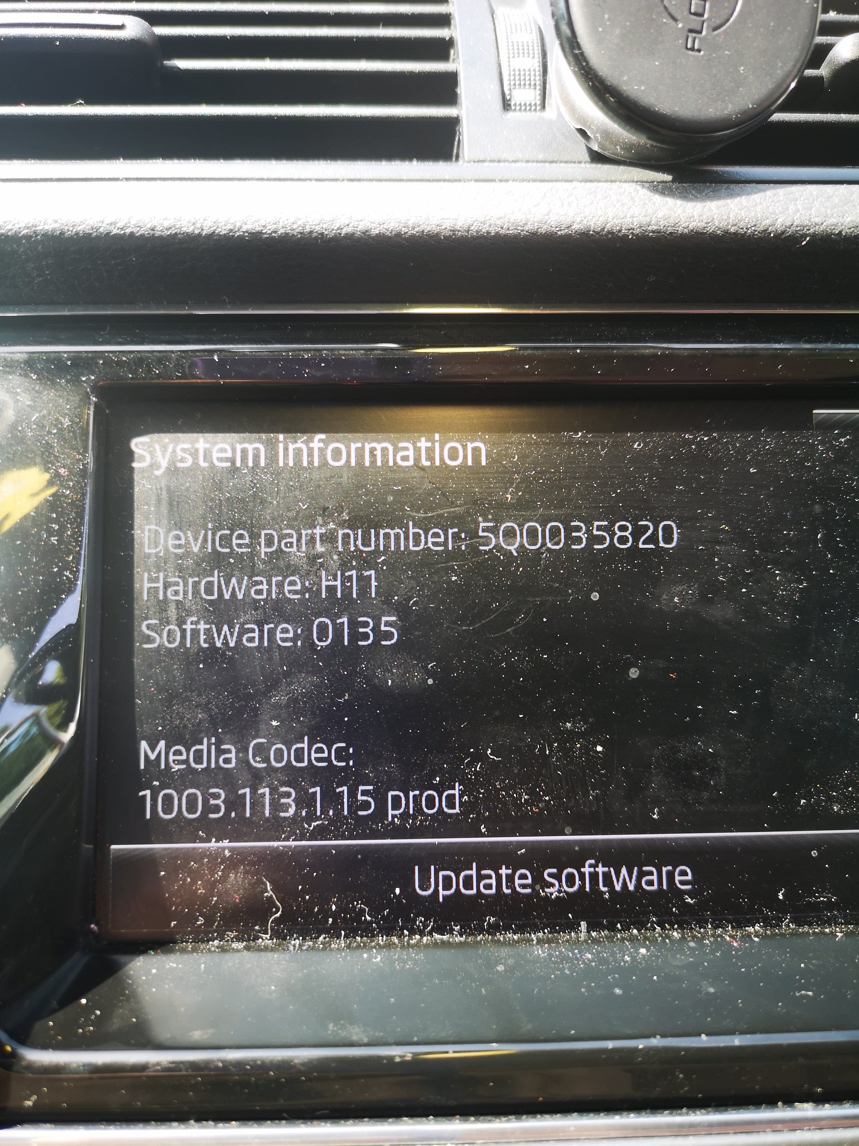

@pab567 Do you have any update to this?
There is an update available (to 0138) but... is there anything wrong with 0135 that you want to update?
@pab567 Does it change anything? Is it possible to get iphone to show navigation after update? I haven’t seen any issues yet
Only thing i would like to have a finnish language there, so is updateting going to get me that?
Unfortunately, none of your wished is met with SW update - you must have the unit replaced. Pls contact me on PM if you are interested.
As a reminder:
- 5Q0035819 and 5Q0035820 units support MirrorLink only
- 5Q0035819x and 5Q0035820x units do NOT support any of MirrorLink, Android Auto, Apple carPlay
- none of mentioned above units supports Voice Control neither Rear View Camera
All mentioned baove features are supported by 5Q0035840x, 565035840, 5Q0035842x and 565035842 units.
x - letter A, B or C
