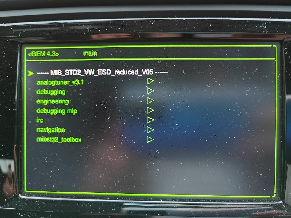

You will need Developer menu enabling, this needs VCDS or equivalent tool that can login to radio and adapt channel.
After you then can use the "toolkit"

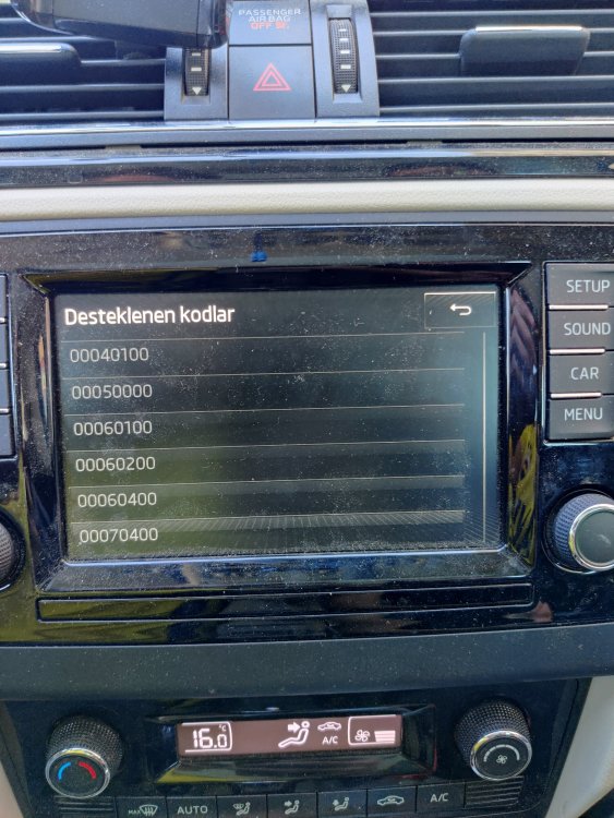

does it apply to the method? My unit
13 minutes ago, gumuskurt22 said:
Because you can see this screen, you have enabled "Developer Mode"
But have you installed this?
This enables you to enable missing codes.
Im not installed this
And you now wish to install this to modify your car features?
4 minutes ago, varooom said:
Ve şimdi bunu arabanızın özelliklerini değiştirmek için mi kurmak istiyorsunuz ?
I need carplay and android auto
I shall send you a PM, you will be having to operate on your own choice.

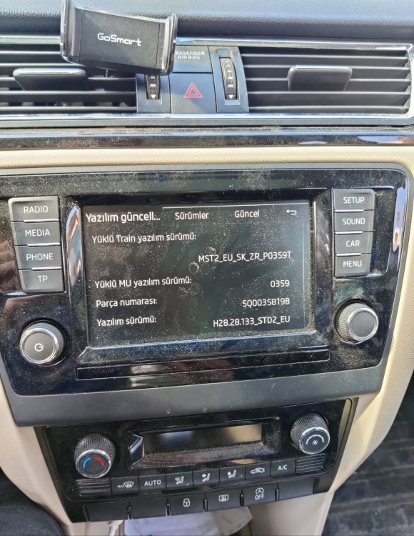

Try to hold down the Menu button for 10 seconds to get the Software Train information, this also has the firmware update button you need.

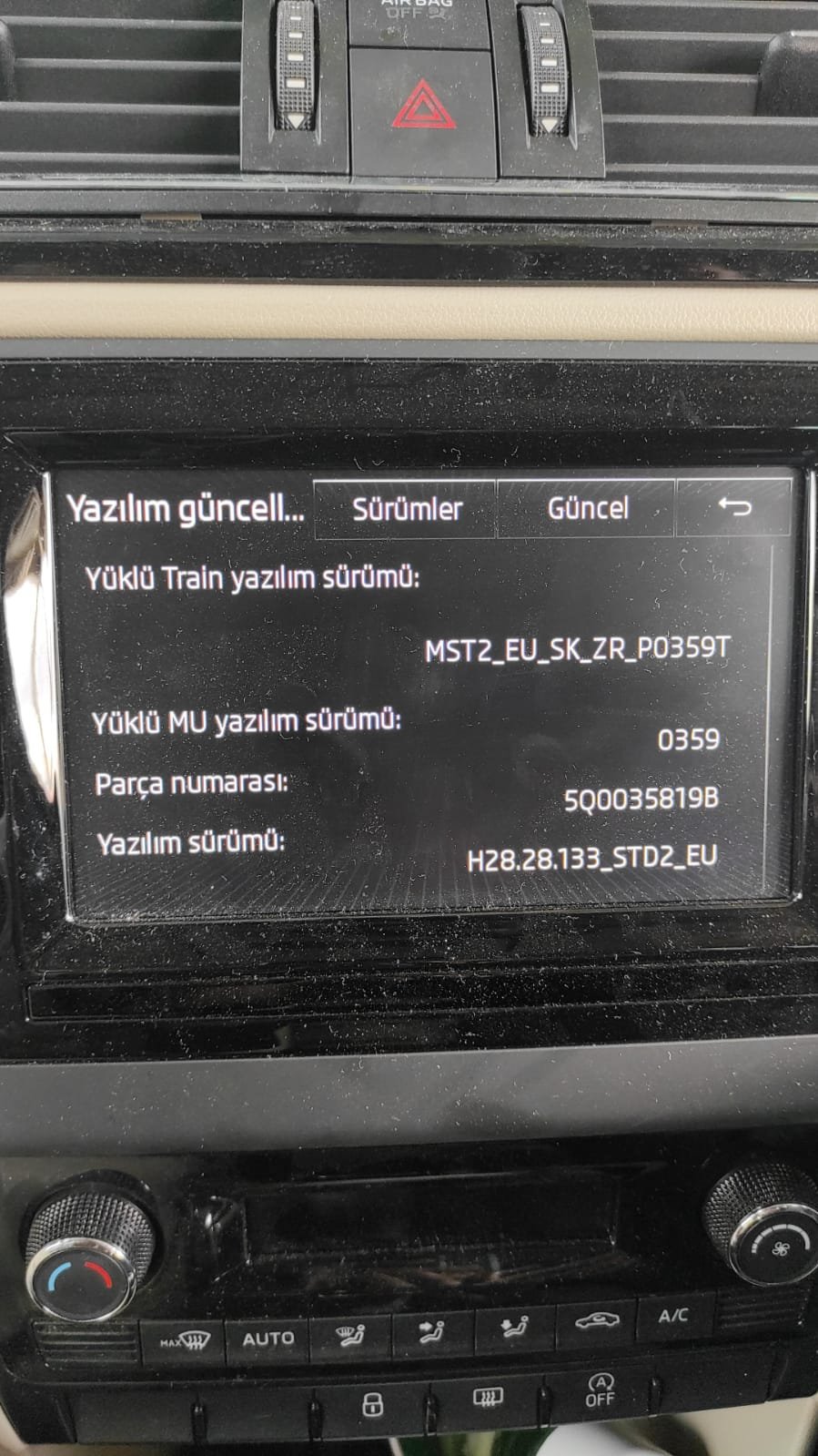

Hi varooom,
Will the attached images suffice?

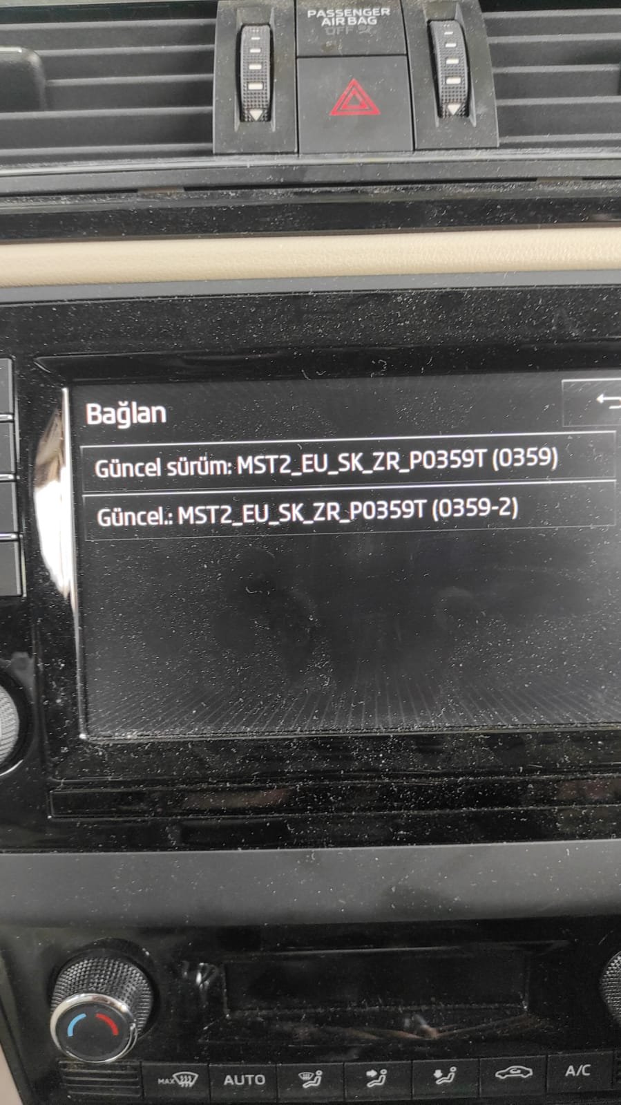

My car does not support image transfer via usb cable. Seems like there is no "mirrorlink/Smartlink" features. Can I activate it with an update? Or do I need to install new software?
Available is 0369 update, even the old firmware has the features inside, but they are only enabled via codes!
You can pay some independent workshops or main dealer to active, and there's also a "free" option where you patch the unit to unlock all the codes.

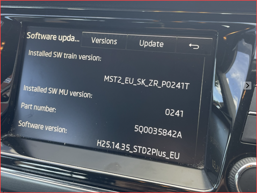

Hi everyone - first time Skoda owner - just signed up...
I'm also looking to do all the updates on my car - I have the 2015 Bolero with Carplay - can someone point me to the firmware update files?
I also have access to an official VCDS cable if that's what required
Cheers
System Information
Device part: 5Q0035842A
Hardware: H24
Software: 0241
Media Coded: 2101.0.0.8
Cheers
System Information
Hardware: H24
Software: 0241
Odds are 0253 is available, but you should hold down menu key for about 10 seconds to enter engineering menu, look for Software Train information and take a picture of that.
