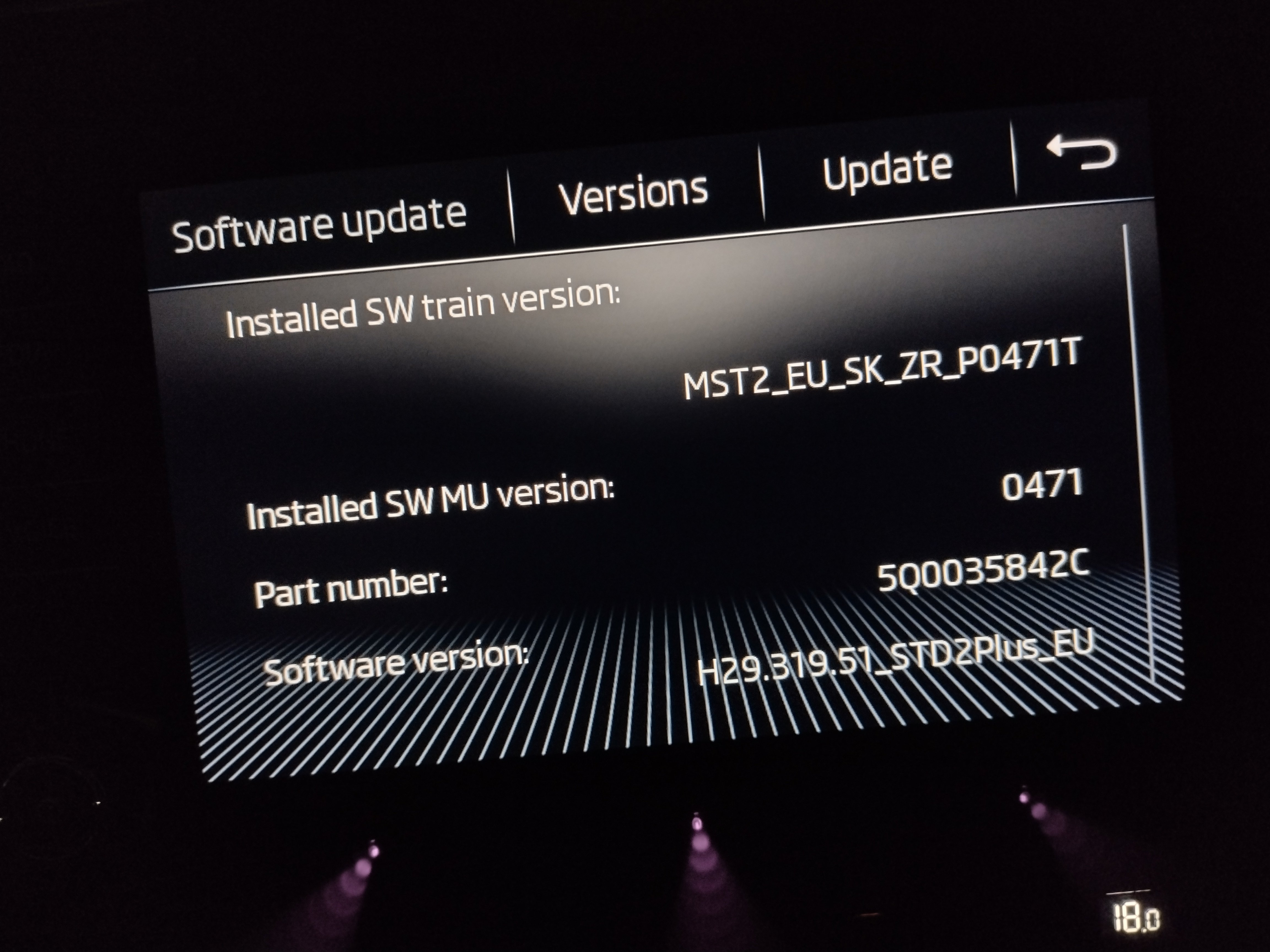

Hold down Menu button to enter hidden menu.  There you will see Software Train, this image is best to verify, also it's location for Update button for firmware.
I found this version as you told me
I shall send 0480 in next few minutes
Update is successful completed. Everything working fine.
Thank you very much again.
Regards

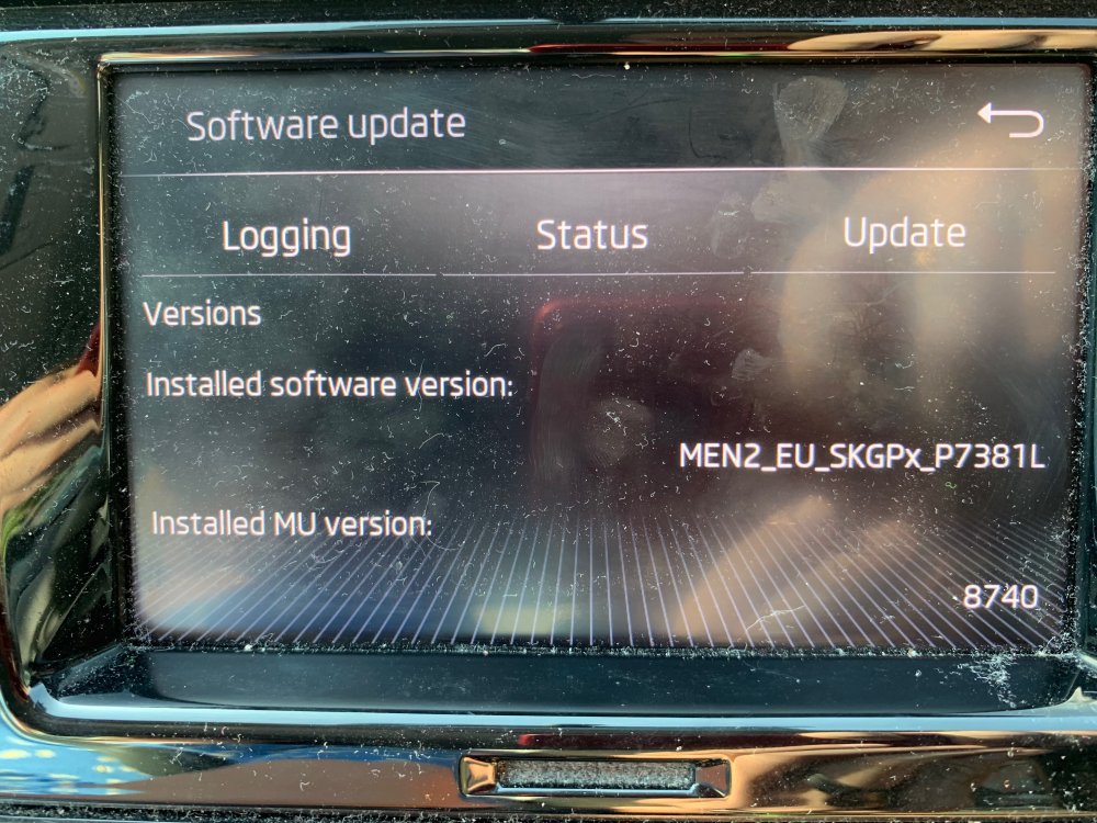

Hello, after the latest software update for my 2018 Fabia - here's the software screen:
Thanks in advance.
Thanks in advance.
MU 8755 is available, will send PM in next few minutes.

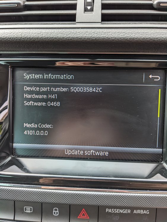

I have no idea if I'm in the right place. My Skoda Fabia '16 infotainment is really giving me trouble at the moment. Lots of stuttering and random restarts. Can anyone help me with the software I need? I've got the info in the attached image
Sorry. I also have this 👍
Available 0253, will send in few minutes
Thanks so much bud. If you have any instructions how to install as well, that would be wonderful. I've never done anything like this 👍
Yes I always send some destructions along with link.
Fantastic. Thanks again. Much appreciated.

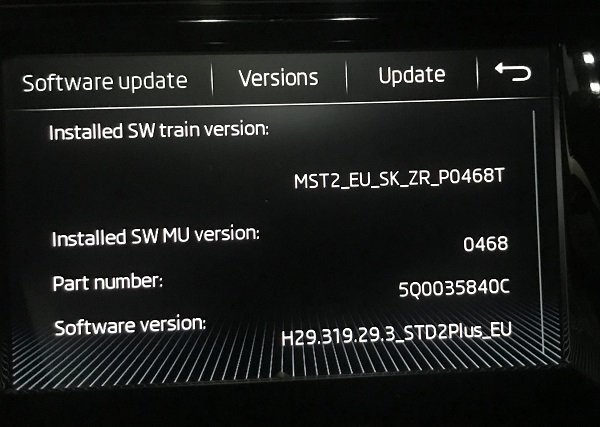

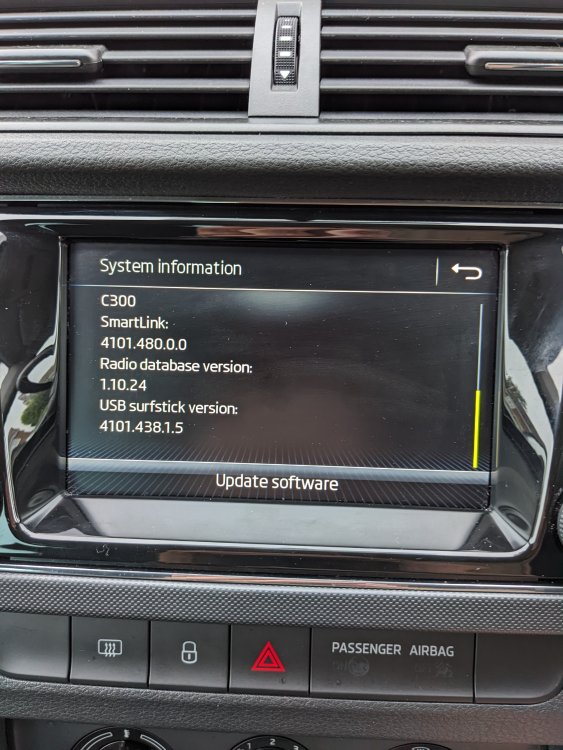

Hello, I have just purchased a used fabia, @pab567 has previous supplied the latest 480  (MST2_EU_SK_ZR_P0480T) software for my Karoq . Could somebody please confirm if this can be used for my Fabia headunit (Pictures below).  Please note this unit does not have sat nat or an SD card , however I assume the update can be done using the USB port  ?
If I need a different version of software would sombody please post ?
Thanks very much for any assistance
You should hold down menu key to enter hidden menu with Software Train, this is the actual information needed (by me at least) you screen with the update button is for maps, won't be able to update firmware in that menu.
@varooom
Thanks for the Quick reply 🙂  I have the software train version below. I assume from the similar train version string the previous software Pab supplied can be used ?
Thanks again for your assistance
@TheGeek As the software train has all the same parameters, that will be good to go.
MST2_EU_SK_ZR_P0468T <--Current
MST2_EU_SK_ZR_P0480T <-- From @pab567
MST2 = MIB2 (afaik), so check
EU = Europe, so check
SK = Skoda, so check
ZR = Additional region (Russia iirc)
0480T = is a 04xx series firmware, and should not be applied to 03xx, 02xx, 01xx Software Trains, and the T on the end is Technisat make
Edited by varooom
Spellink
@varooom
Great piece of information, exactly what I needed. I have just performed the update using the original 0480 files provided by Pab and this has worked perfectly. The system is now fully updated.  Turns out I have got an SD card reader, its hidden in the upper right corner of the Glove box in a recess. I used that to perform the update.
Thanks again varooom much appreciated.
Updated images attached 🙂
